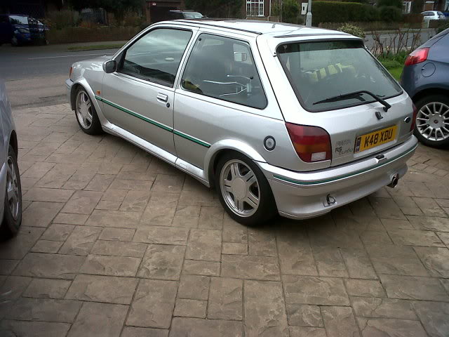

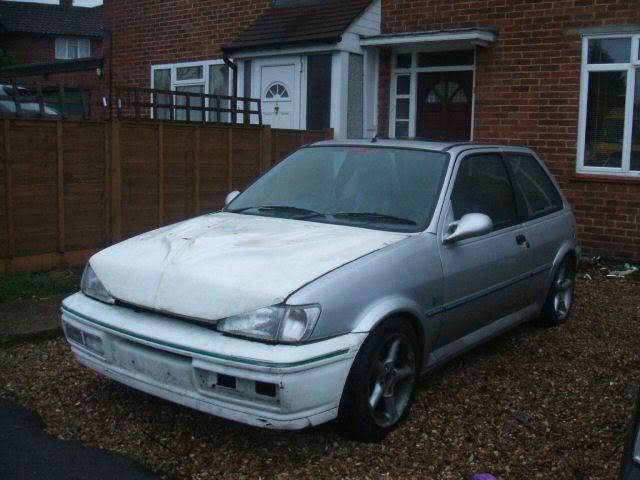

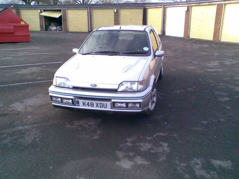

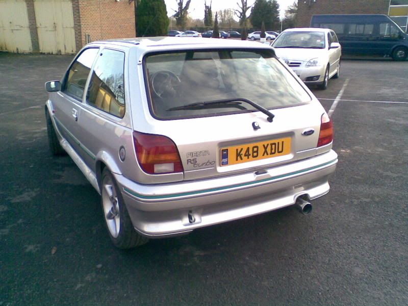

Tired 1992 Moondust Silver XR2i CVH rescued from Ebay for ยฃ155.
Here’s where it all began at the start of 2008

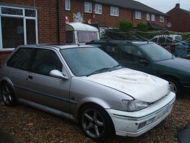

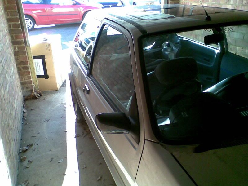

ย One very abused and forlorn 1992 K-reg XR2i 1.6 CVH
It’s still at the seller’s house in these pics

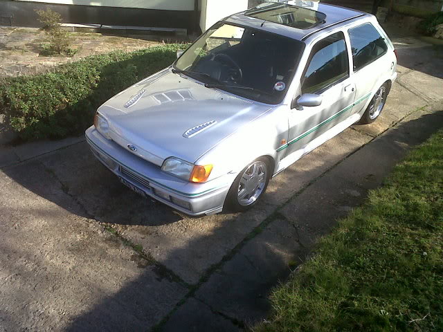

Exterior Modifications Completed: FRST bonnet, pop-outs, rear spoiler, and MK3.5 electric mirrors.

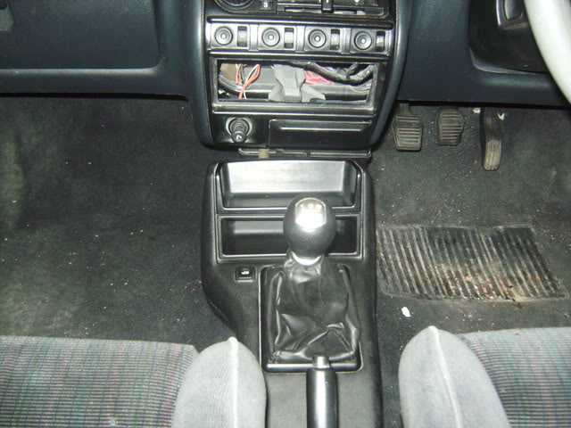

Interior Modifications Completed: Full FRST Recaro interior, clocks, steering wheel, green stripes set, and FRST decal.

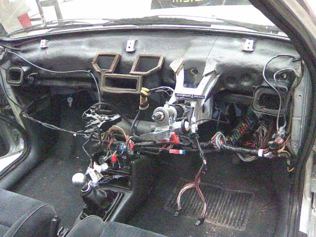

Interior Upgrades: A full โ€œraven plasticโ€ dash and plastic trim from a donor car were installed.

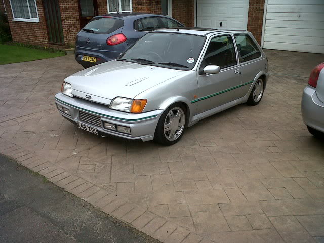

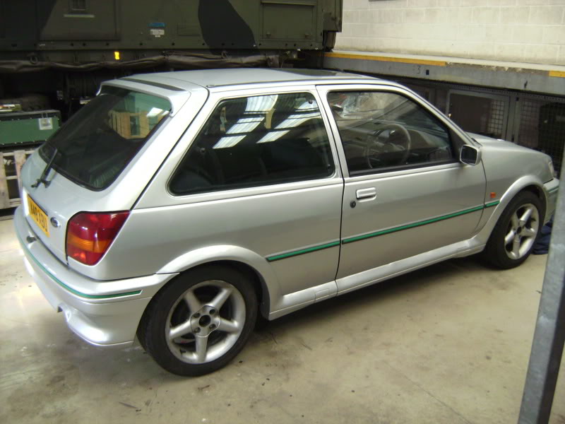

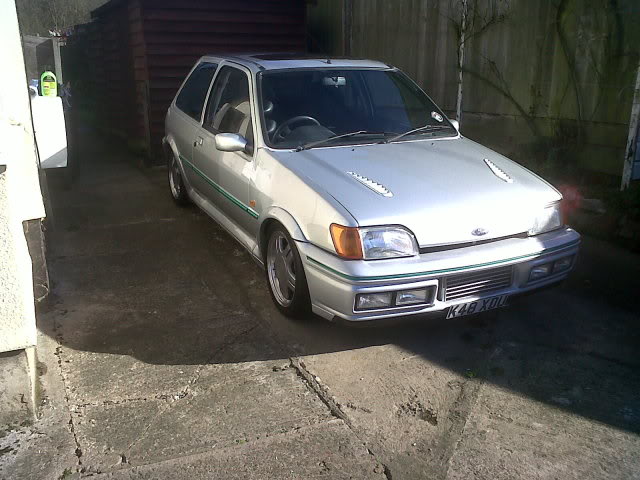

Collected from the bodyshop, doors reassembled, windows all fitted, decals all stuck where they should be etc.
Bonnet is not sitting straight due to old, bent hinges.

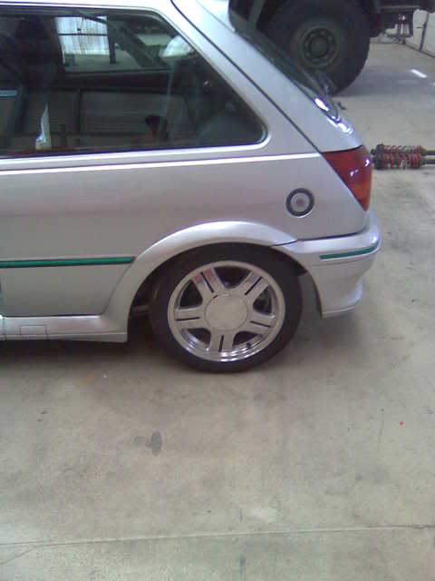

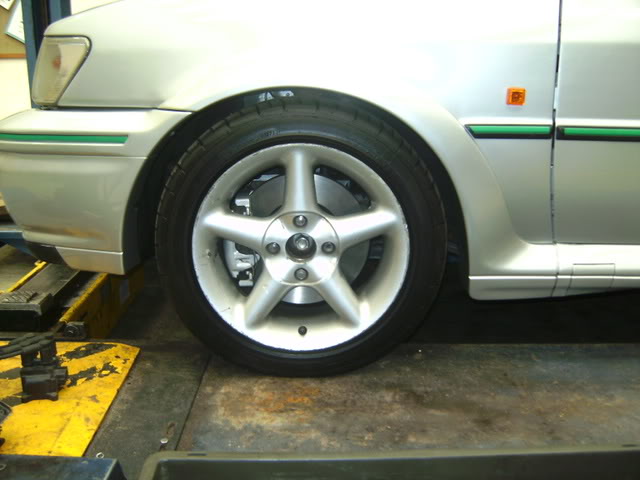

Current Wheels: Not ideal, but functional for now.
Future Wheels: 15โ€ RS2000 diamond-cut alloys with 195-45-15 tyres, currently awaiting refurbishment at Lepsons.
Future plans: New rims, rear discs, coilers, blacktop zebec, mtx75

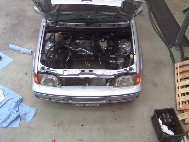

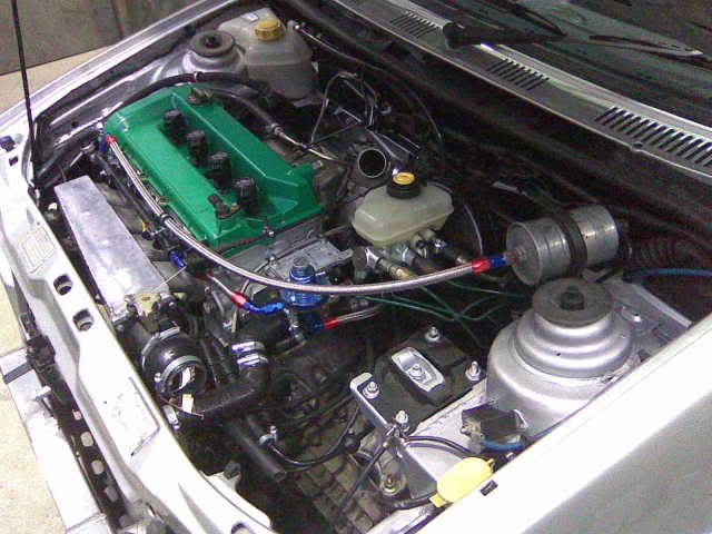

Lets go – Duratec turbo

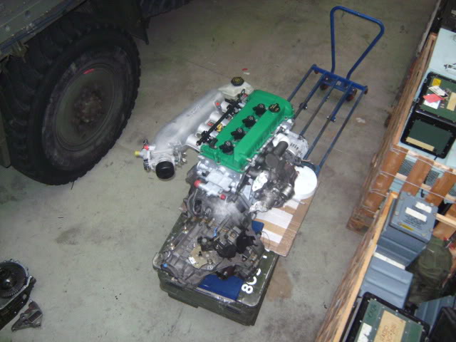

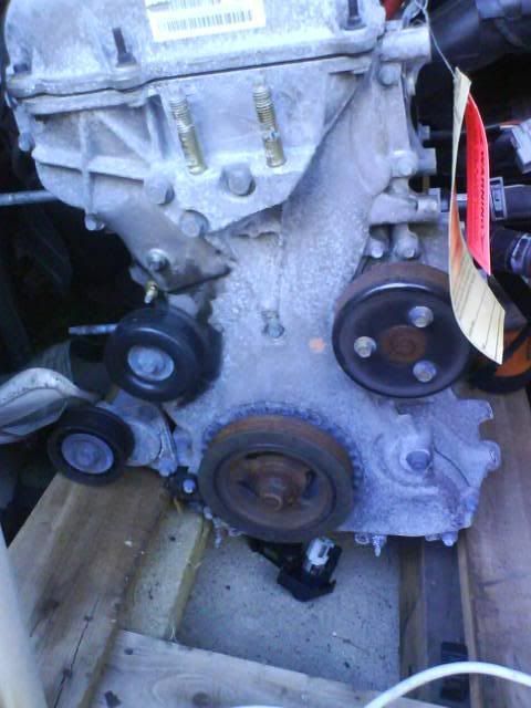

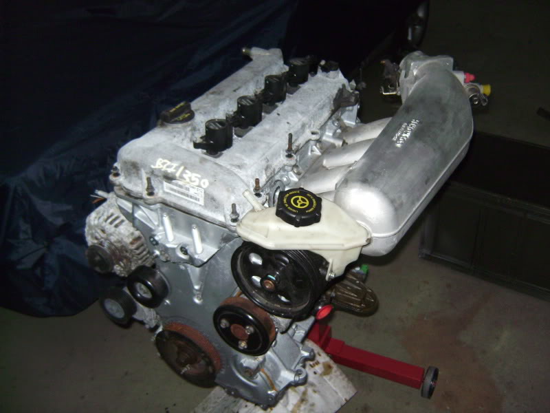

A 2.3L all-alloy Duratec engine from the U.S. Focus was selected as the powerplant for the project. Compared to other UK cars based engine options such as the Focus RS Mk1 (Zetec-E Turbo), Focus Mk2 ST 2.5 (Volvo), and Fiesta ST150 (Duratec 2.0), the 2.3L offers a lighter weight, a front-mounted inlet for more efficient turbo layout, and greater cost-effectiveness.
The engine was sourced forย $500ย withย $200 shippingย to the UK, taking advantage of a favorable exchange rate and U.S.-based shipping services.
Planned upgrades includeย forged rods, pistons, ARP bolts, andย Cosworth components. The engine will beย turbochargedย with a target output ofย 300+ BHP, managed by anย aftermarket ECU. The original alloy rocker cover will be replaced with a black version commonly found on 2.0 Duratec models.

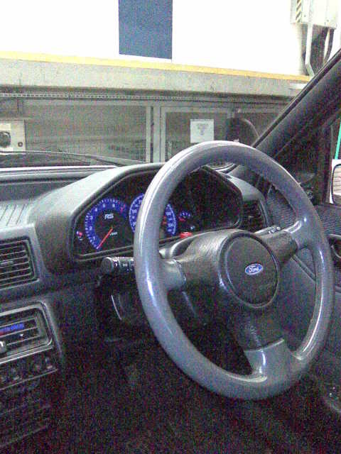

Focus RS clocks purchased.
Initial plans are to to use a Getrag MT285 6-speed gearboxย (used in ST170, Mini Cooper S, and Mondeo SCi), which lacks a mechanical speedometer drive. Retrofitting a mechanical drive is not feasible or cost-effective.

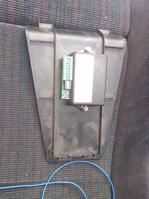

To address this,ย Focus RS electronic instrument clustersย are being used. These rely on aย Vehicle Speed Sensor (VSS)output, this feeds to the engine ECU and then that signal is sent via CAN to the instrument closer

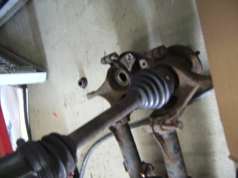

  • Fiesta Mk3.5 or Mk4 Front Hubs & Carriers (compatible with ST170 driveshafts)

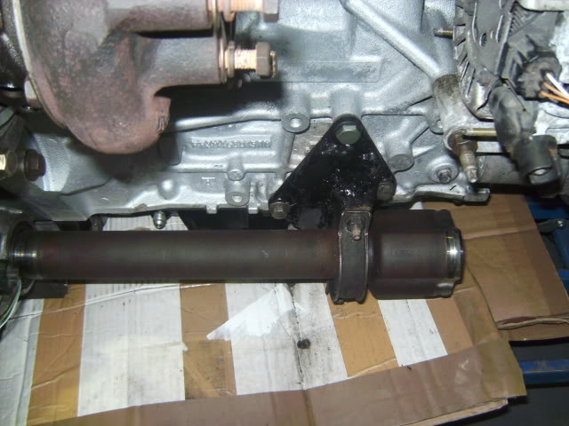

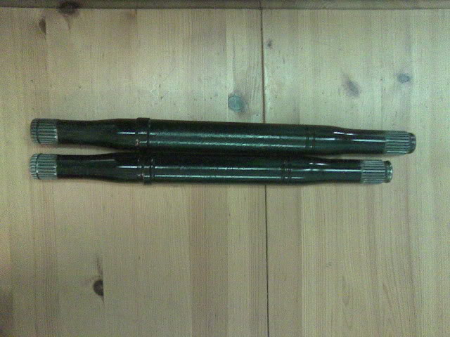

  • ST170 Driveshafts (including one custom billet steel shaft)

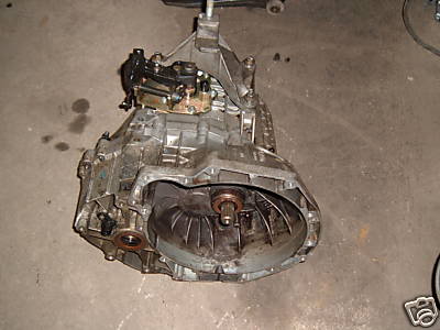

MTX 75 gearbox & mount arrives.
A decision was made to use anย MTX75 5-speed gearboxย from aย Mondeo MK3 Duratec.
To match the gearbox,ย MK2 Focus 2.0 Zetec driveshaftsย were also sourced. These are compatible, with left side shaft to be shortened as required for fitment.
Additional components include a SPEC Stage 3 clutch for the U.S. Focus 2.3 and a Fidanza lightweight flywheel, both ordered from the United States. A Quaife ATB differential will also be installed in the MTX75 gearbox. This differential is the same type used in the Focus RS.

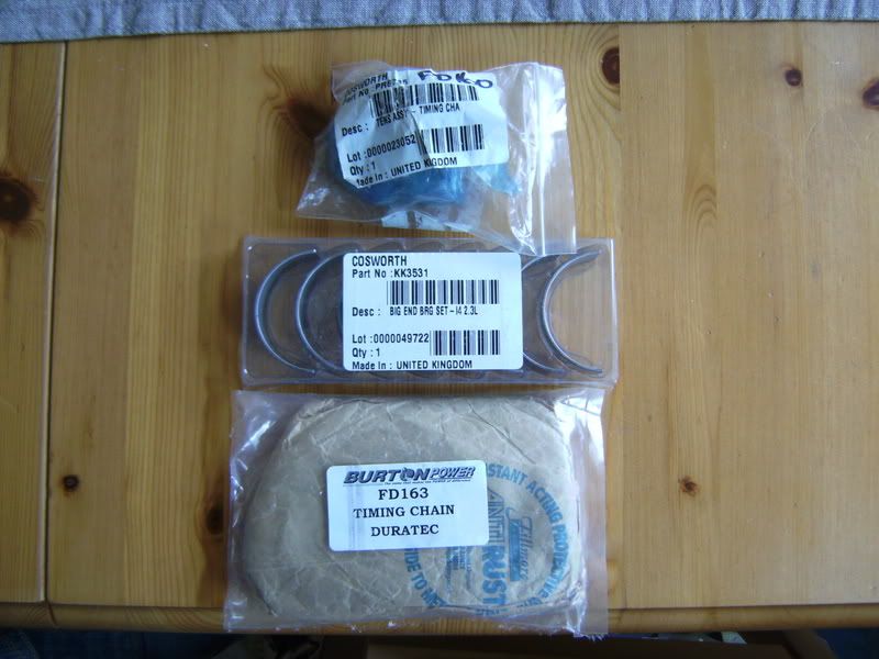

Cosworth bearings & forged rods arrive.

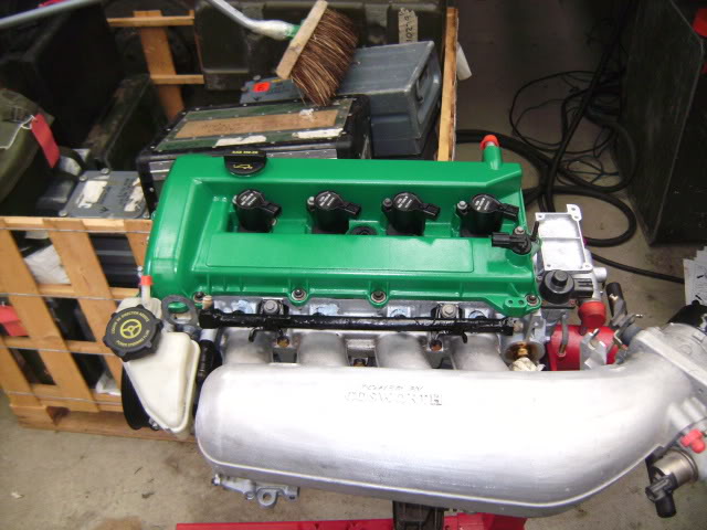

Side view of the 2.3 Duratec.
Haul so far / Still to buy
The haul so far (in addition to items already shown earlier in the thread):
1. Cosworth inlet manifold.
2. Pro-Alloy full-width radiator & Fan.
3. GRS Front-Mount intercooler.
4. Garrett GT28R Ball-Bearing turbo.
5. Mondeo MK3 2.0 Duratec Engine mount.
6. MK3.5 Power steering pipework.
7. Fiesta ST Power steering pump.

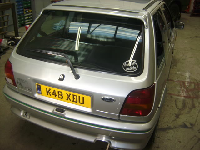

8. “Duratec Inside” Sticker for the rear ‘screen!
Still on the shopping list:
1. Pumaspeed Fiesta ST Turbo Garrett GT Turbo Exhaust Manifold.
2. Fuel Injectors.
3. Management.
4. Fuel Pump.
5. Quaife ATB Diff.
6. Coolant/Boost/Fuel Pipework.
7. Map Sensor.
8. Decent FRST Exhaust (& some kind of downpipe
9. Pay the machine shop to bore my block to 88mm and also shorten 1 driveshaft.

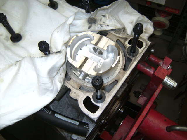

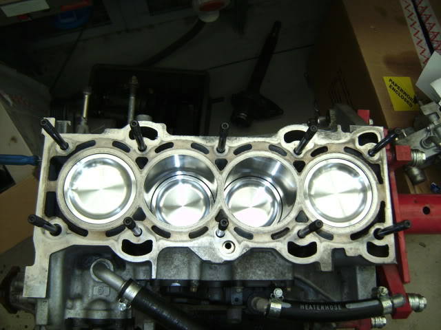

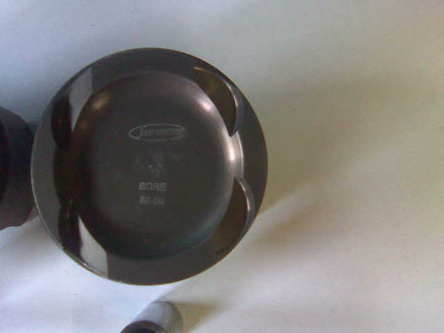

Pistons
Forged 9:1 compression 88mm Pistons.

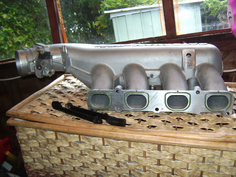

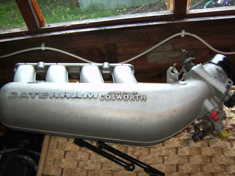

Cosworth Inlet.

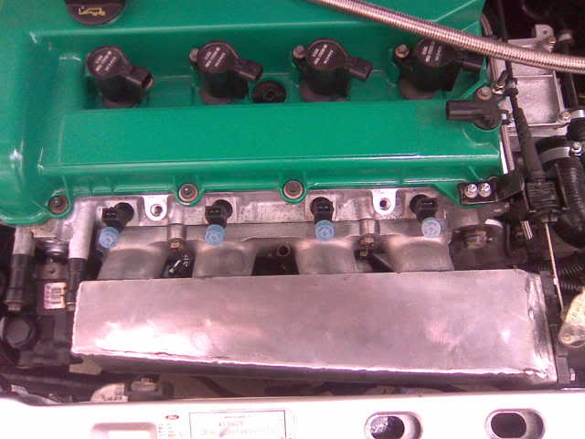

Caterham CSR200 Cosworth Inlet Plenum (later realised it won’t fit!) Even come with a 70mm Throttle body.

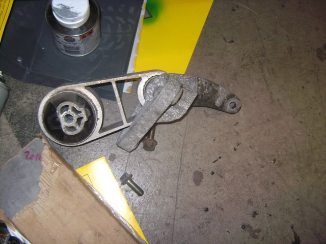

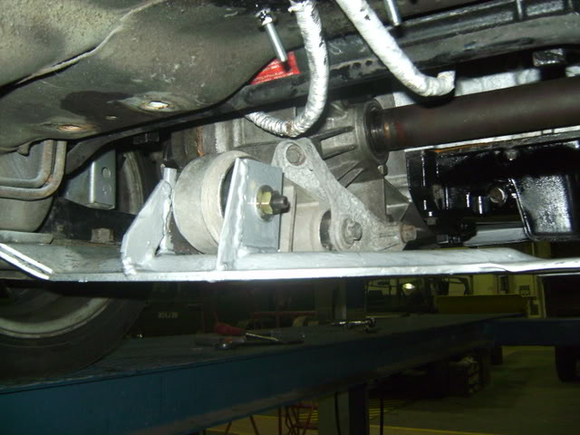

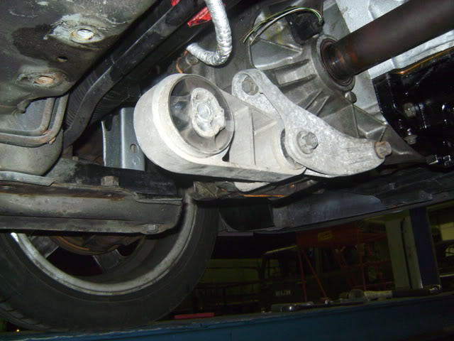

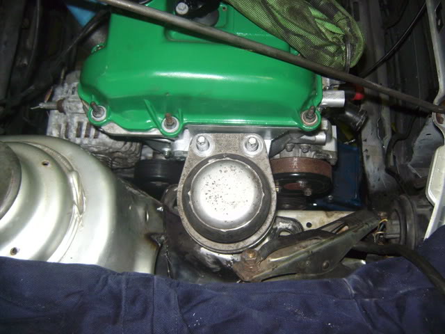

Engine Mount
Mondeo 2.0 Duratec MK3 Engine mount (for dummy-fitting purposes)

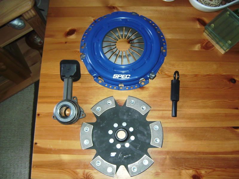

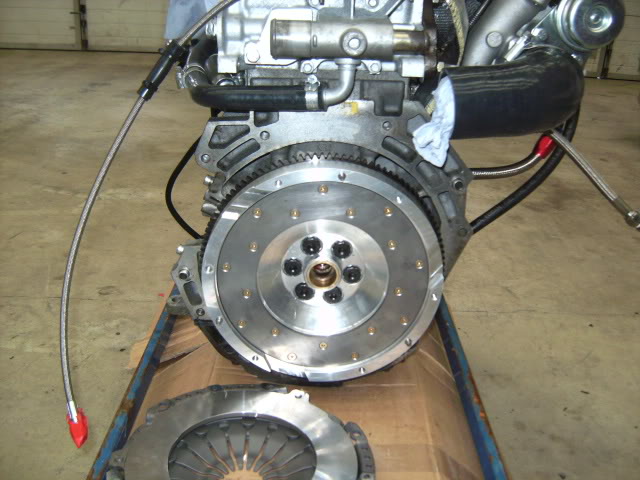

Fidanza Flywheel / Spec clutch
Fidanza flywheel to replace the old, nasty dual-mass one
Stage 3 SPEC Clutch

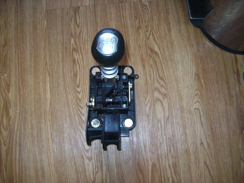

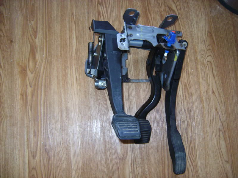

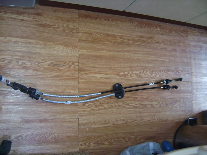

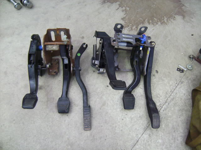

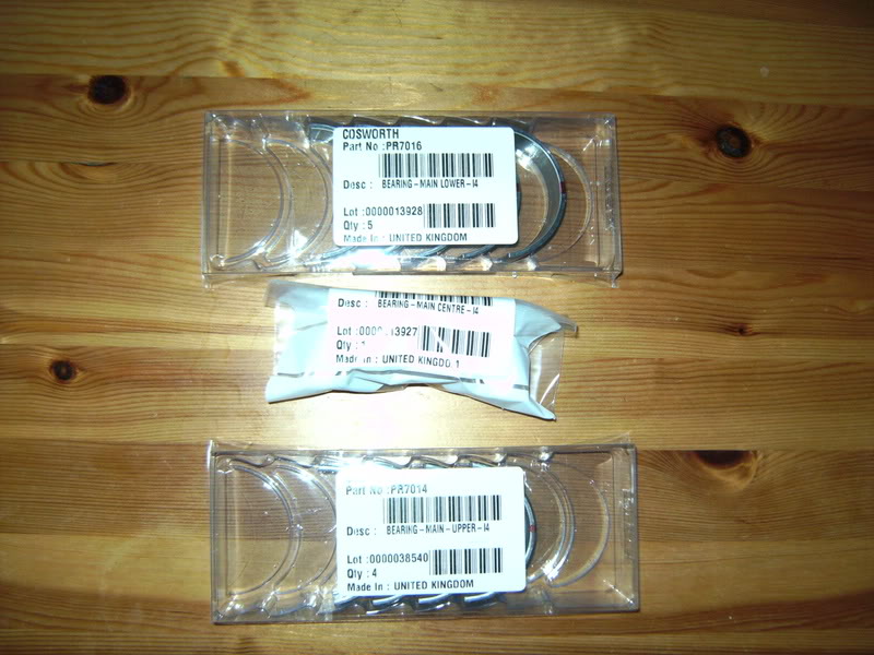

Gear cables, gear lever, fiesta mk4/5 pedal box inc pipework, master cylinder / reservoir & brake linkage

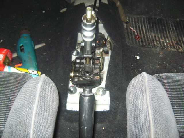

Mondeo MK3 2.0 Duratec MTX 75 Gearlever Mech & Gear shift/selector cables:
Fiesta MK4/5 Pedal Box with Hydraulic Clutch Master Cylinder and all pipework:

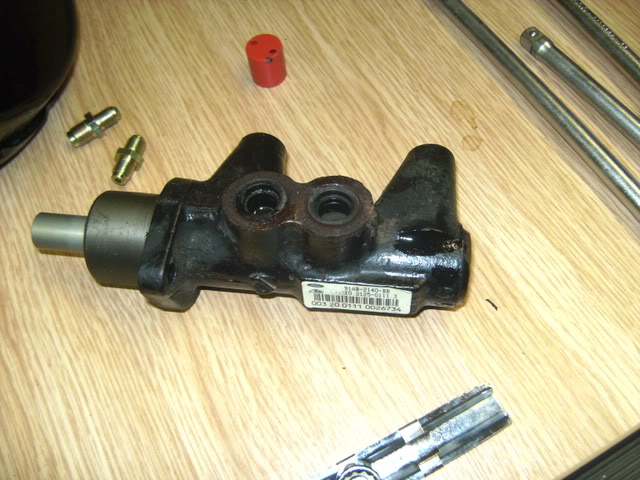

Fiesta MK4/5 Brake M/cylinder & reservoir (has outlet for hydraulic clutch)
Fiesta MK4/5 Brake cross-linkage (Mk4 Pedal has different attachment for brake linkage than earlier MK3)

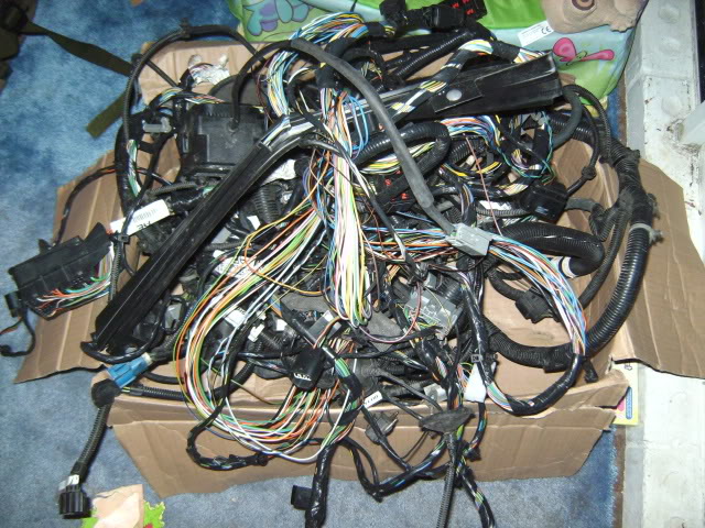

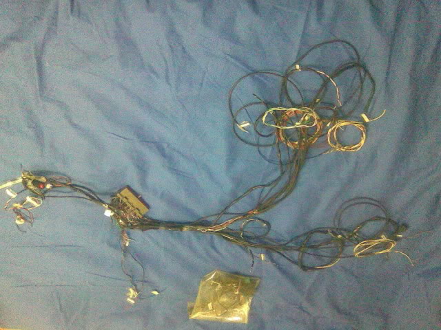

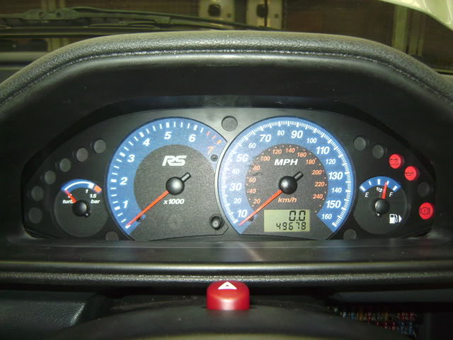

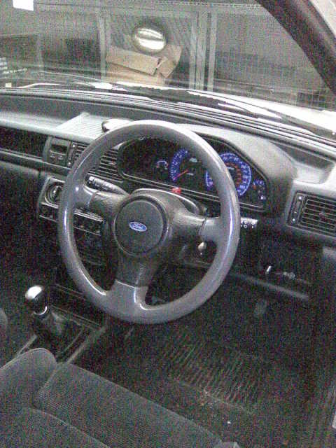

It was a rainy day. This was done and some figuring out of wiring for the Focus Rs instrument cluster wiring to work with the fiesta…

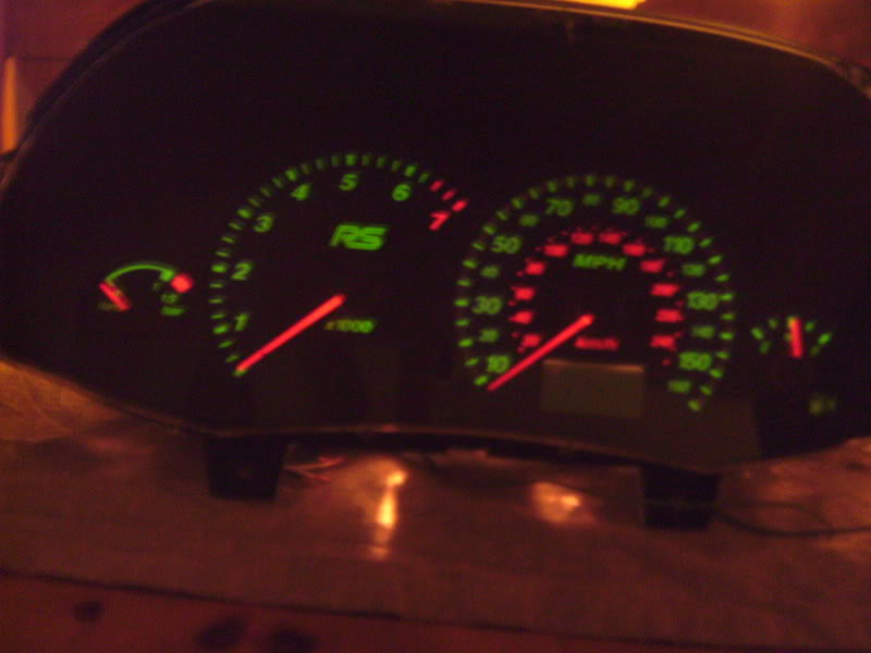

Illuminated RS clocks
Quick pic of the clocks illuminating

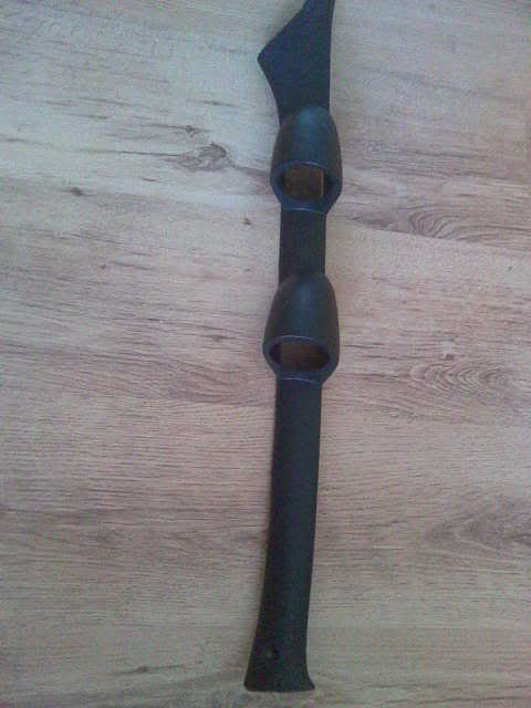

Few bulbs removed for features not present on the Mk3 – ABS, Airbags, Traction control, seatbelt warning lamps

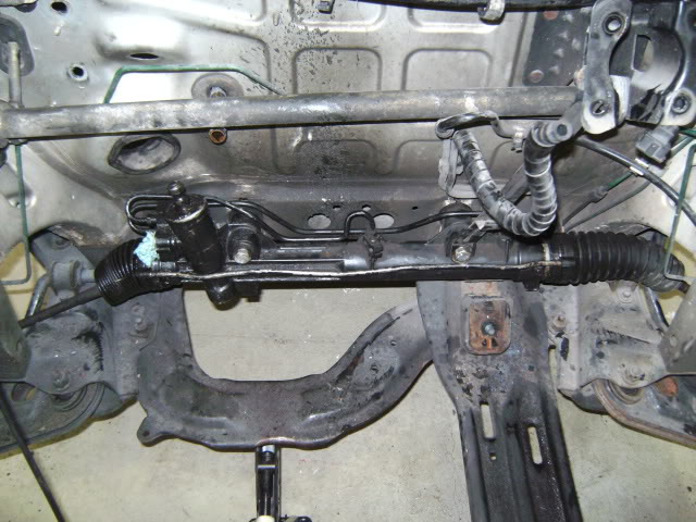

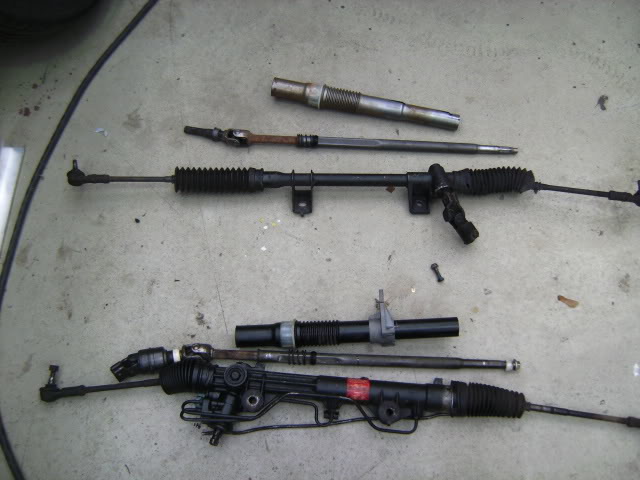

Scrapyard Haul – Fiesta MK 3.5 power steering components.
Fiesta MK3.5 Si steering column.
Fiesta MK3.5 Si Power steeing Rack and track rods.

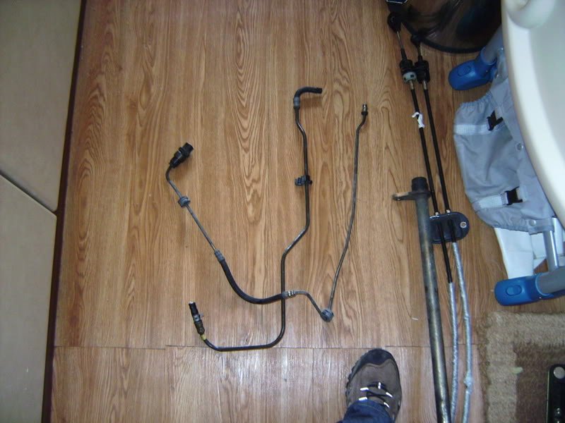

Fiesta MK3.5 Si Power steering pipework

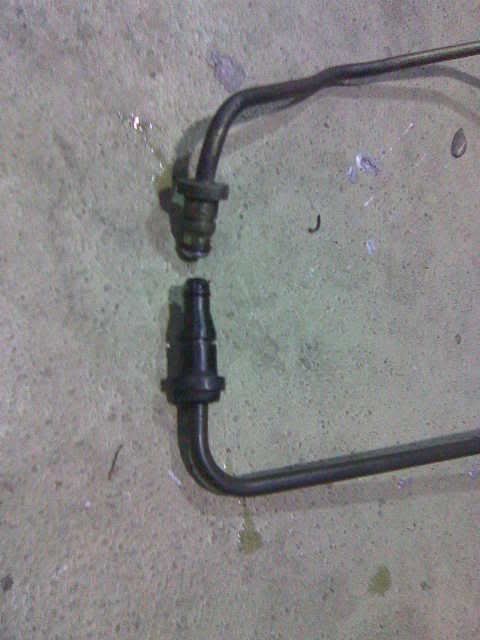

Fiesta MK5 Zetec S Power steering L/P pipework with cooler.

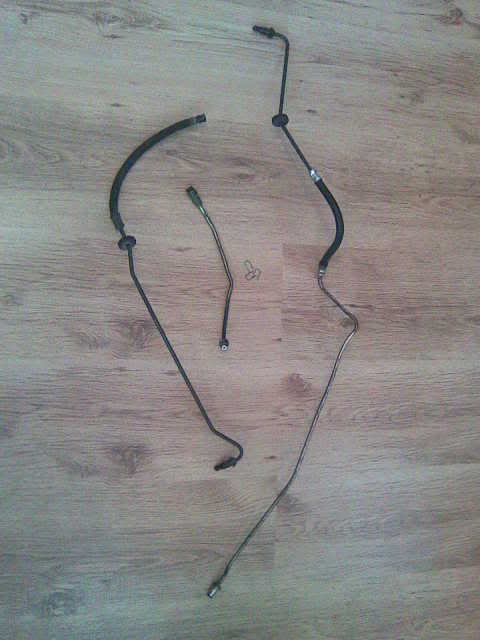

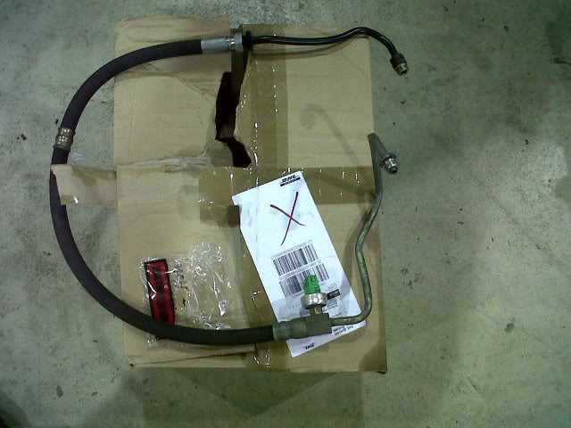

Mondeo MK3 2.0 Duratec Power Steering H/P pipework (will be taken to hose specialist and a hybrid pipe made with the pump-end of this one and the rack-end of the Fez Si hose)

Mondeo MK3 2.0 Duratec Alternator/Starter Motor wiring.

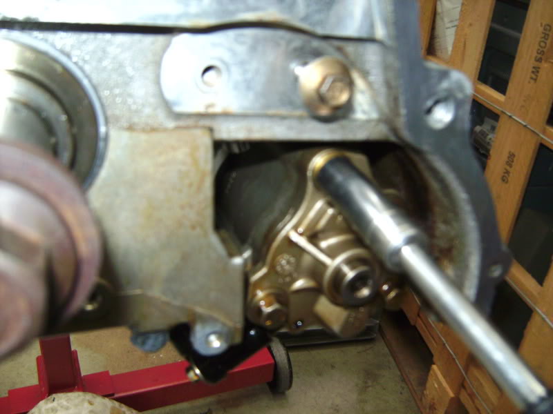

Vehicle Speed sensor talk
The white blanking-plate on the left is what the late-MK3 Mondeo MTX75 ‘box was fitted with (they must use some other means of speed measurement, wheel speed etc…)
On the right you can see the the early-MK3 Mondeo Vehicle Speed Sensor (VSS) in its place – This sensor is the same one that 5-speed MTX ‘boxed Focus models (2-litre & RS) used too.

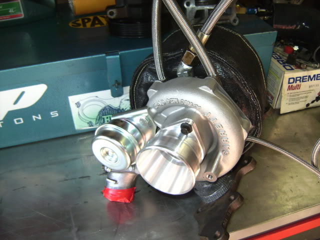

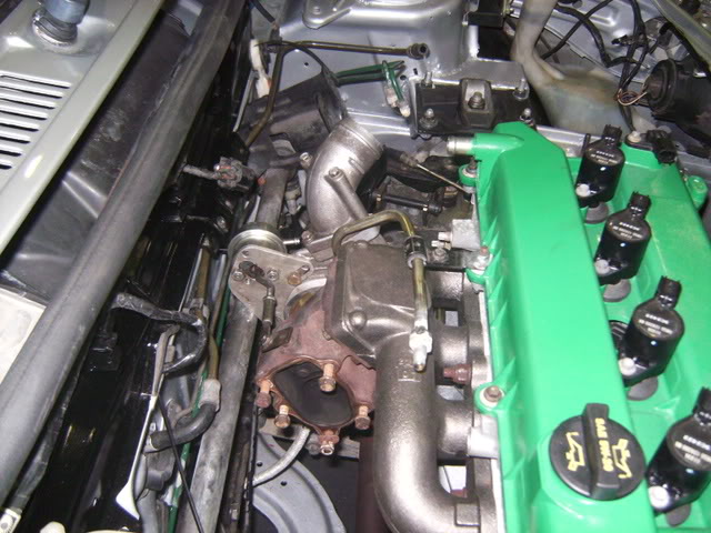

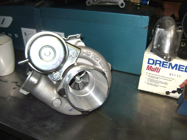

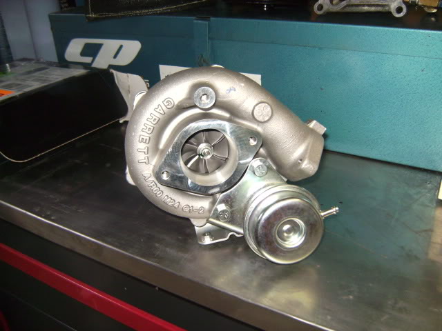

Turbo arrives, Exhaust manifold ordered
Garrett GT28R Ball-Bearing to be precise, should be just what the car needs for a nice bit of poke but (hopefully) next to no lag – 2.3 Litres & 9:1 Comp should see to that!ย

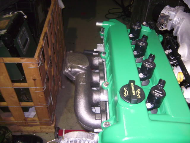

Pumaspeed manifold ordered. Compact design.

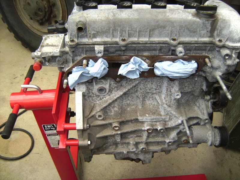

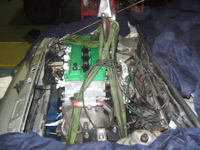

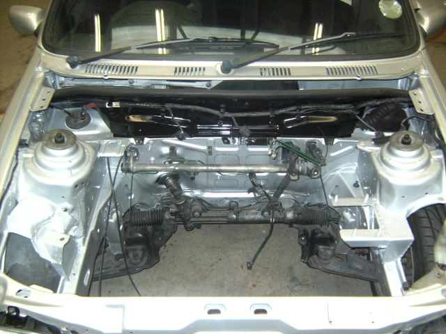

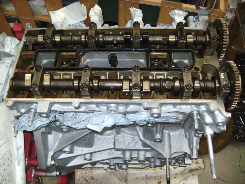

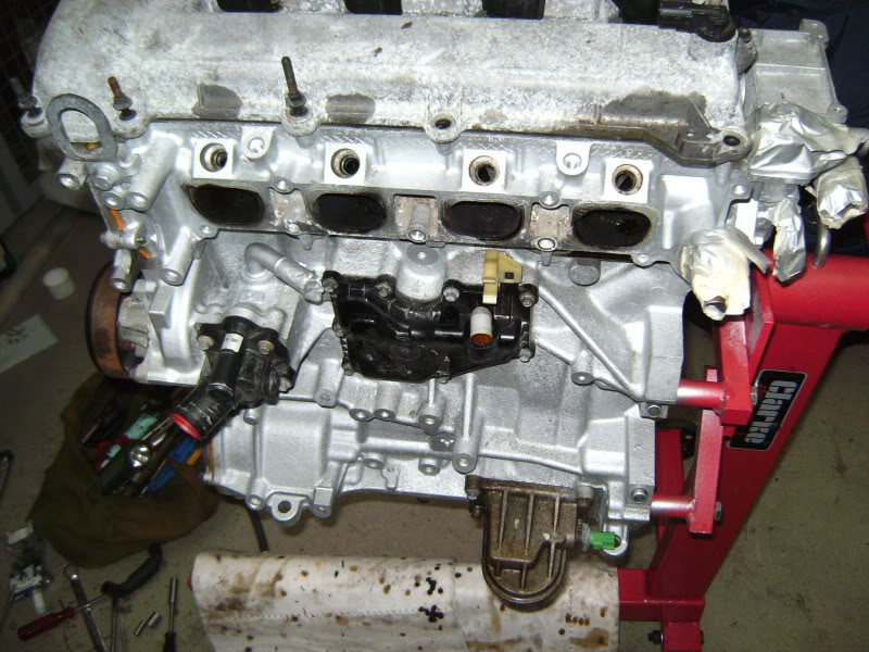

Engine stripdown.
Ancillaries all stripped from the engine and it’s now mounted on the stand ready for stripdown and re-bore

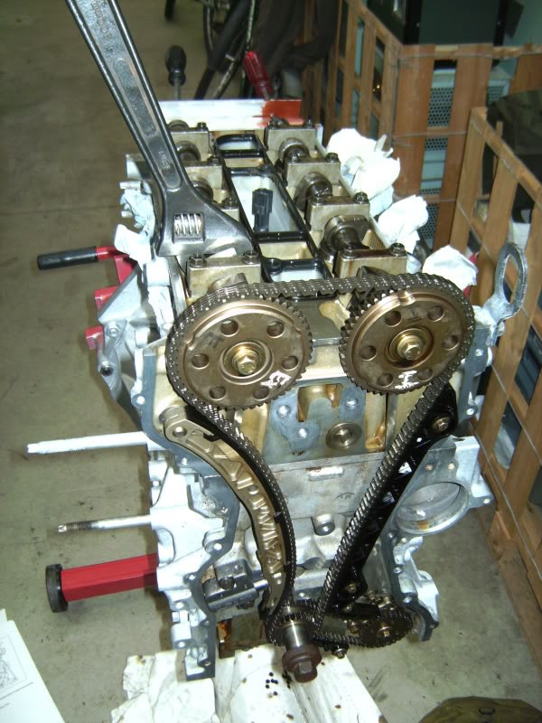

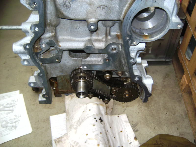

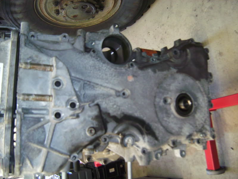

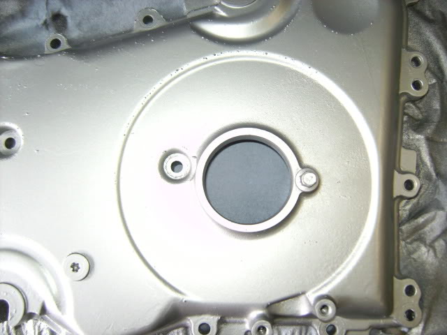

Engine Stripdown – Duratec has a cover over the timing chain which needs removing first.

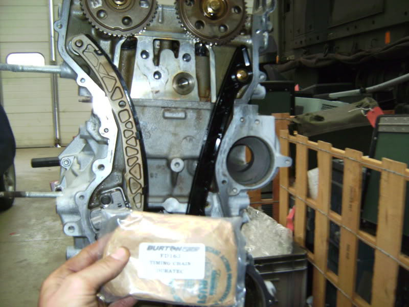

Timing chain
Cams need removing to enable head removal.
Cam Bearing-Caps all labelled using good old Army Issue Mine-Tape
Oil Pump chain and pump need removing prior to block machining.
Ready for Head removal.
Head Removed

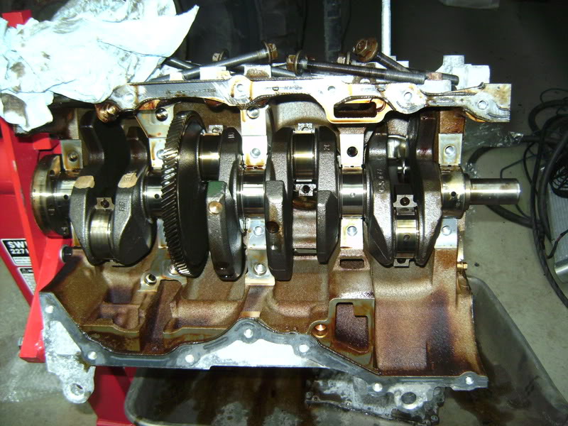

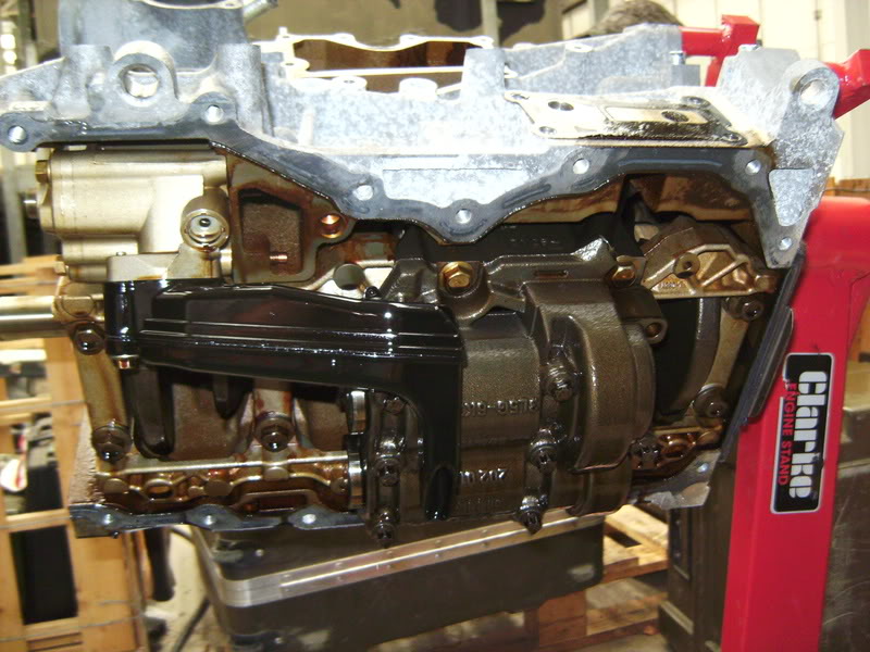

Here’s the crank setup – note the balance-shaft mechanism that is specific to the 2.3 (due to its longer stroke) – Driven at 2 x Crank speed by a gear on the Crank (see pics) can be removed though according to the yanks. Considered but eventually not opted for.
The crank on the Duratec is carried high in the block in a cradle which incorporates all the main caps.
Crank with cradle removed.

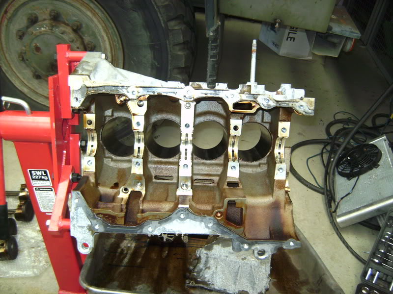

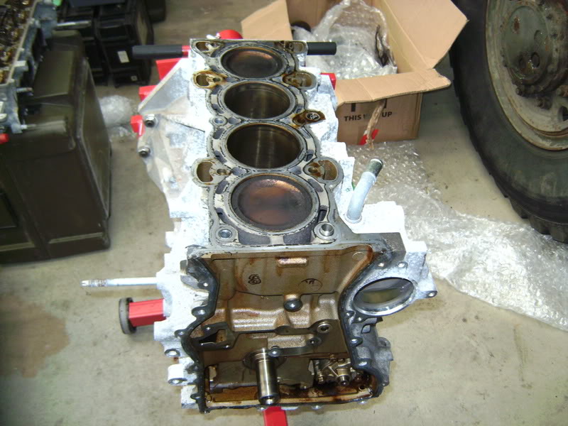

Bare Block at last!
Off to Cober Precision Engineering, collecting it middle of next week all freshly bored to 88mm for me to rebuild – bloody light too

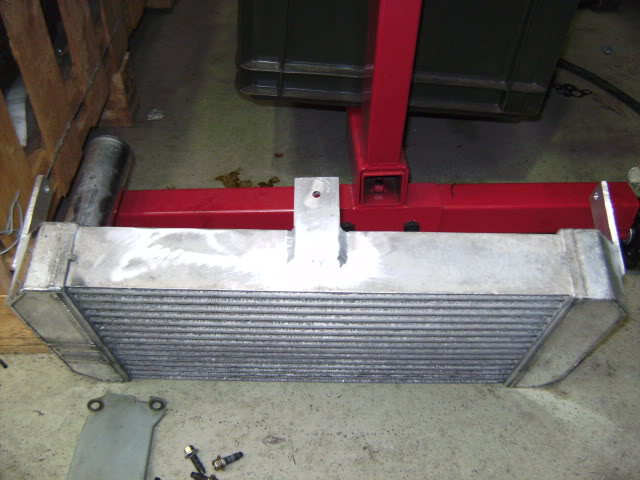

Pro Alloy rad
Pro Alloy full-width Rad & GRS Intercooler

Burton / Cosworth gaskets.

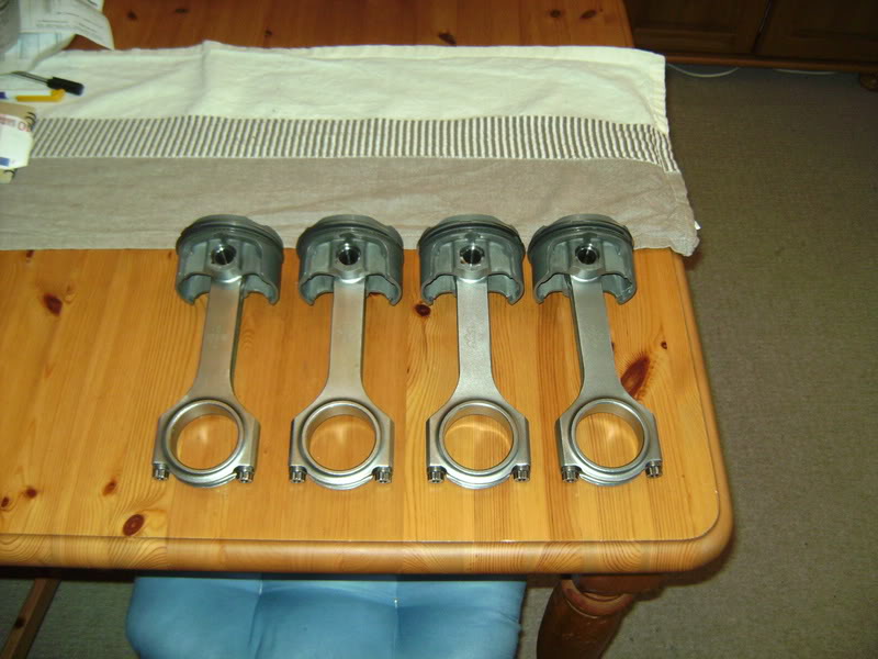

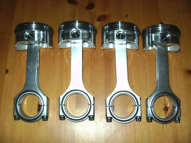

Rods new vs old
Quick pic of the standard Duratec Pistons & Rods VS new uprated lower-comp items.
Eagle rods look positively obese next to the svelte Duratec items
Although the standard Duratec items look good and almost race-like they’re well known as being rather weak, the same goes for the standard “slipper” pistons.

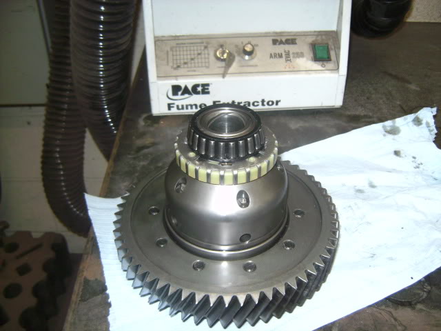

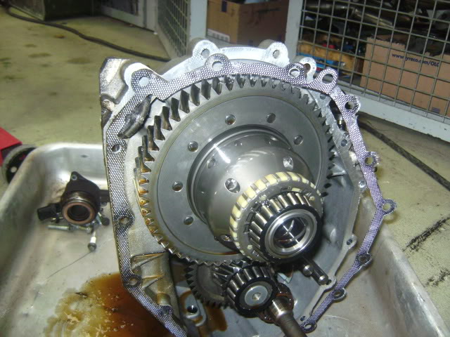

Talk ref Quaife diff / hunting FRS box down
I will be fitting a Quaife ATB but to be honest it’d probably pay me to be patient and hunt down a Focus RS ‘box 2nd-hand and buy that, as the Quaife ATB alone is ยฃ500 (+ Diff bearings) so it’ll make more sense to get FRS ‘box that already has it fitted then just swap the bellhousing over from my existing Mondeo Duratec MTX75 onto the FRS MTX75.

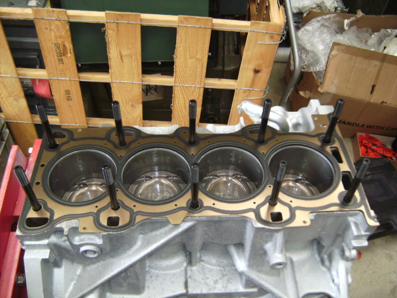

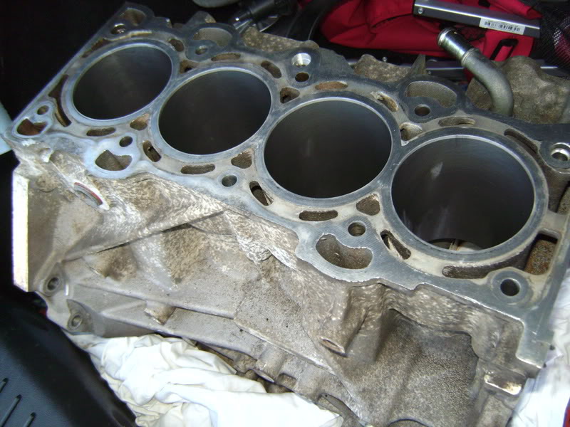

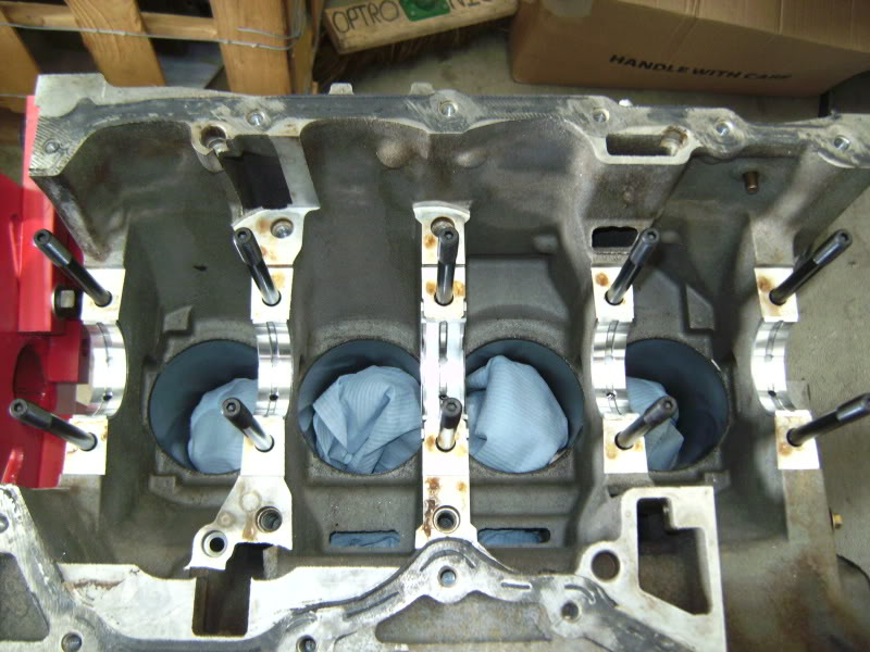

Block rebored.
I collected my block from Cober Precision Engineering in Colchester today, freshly bored & honed to 88mm and now awaiting reassembly

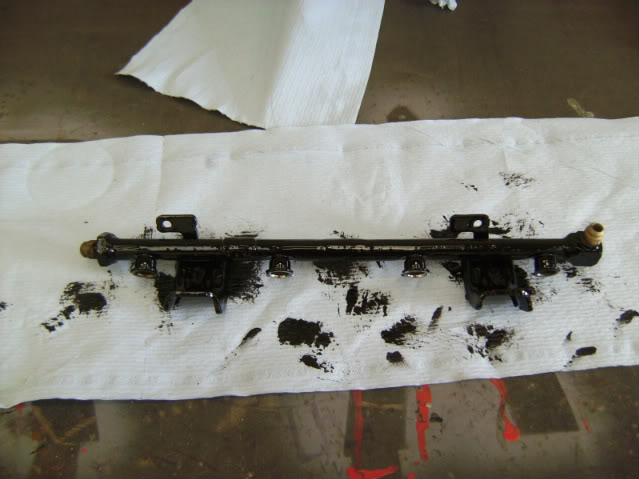

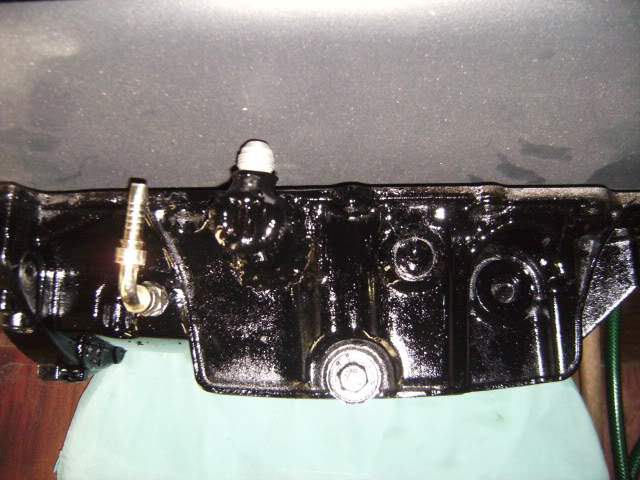

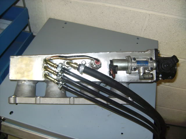

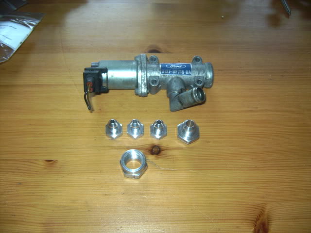

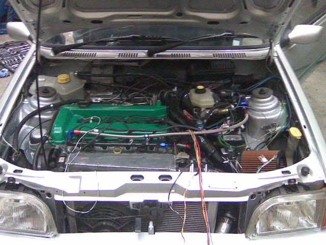

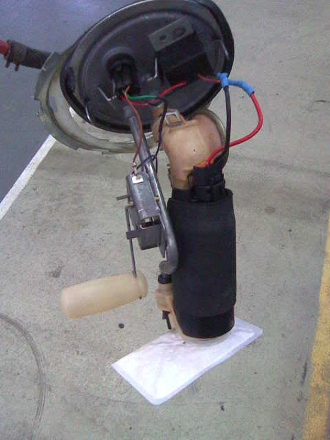

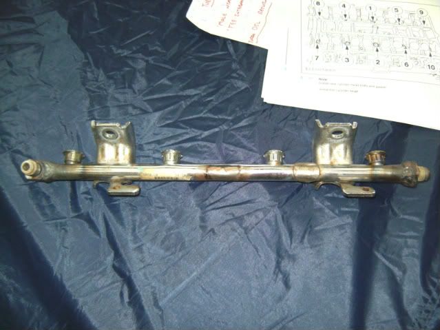

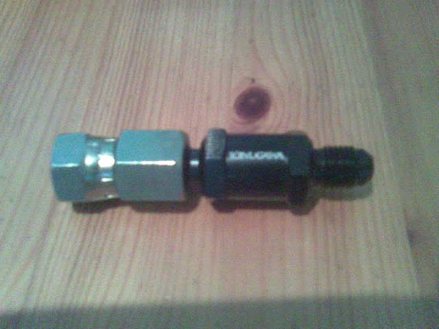

Note ref fuel rail
Prepared fuel rail for fuel-return operation (to make it more of a a straightforward fit into myย Olde-Worldeย Fiesta) and is having -6 male fittings welded onto each end to allow me to use some nice Aeroquip hosesย
Duratec engine has a dead ended fuel rail, the Fiesta mk3 injection fuel pump setup in its standard form requires a fuel return to tank.
ARP Fasteners.

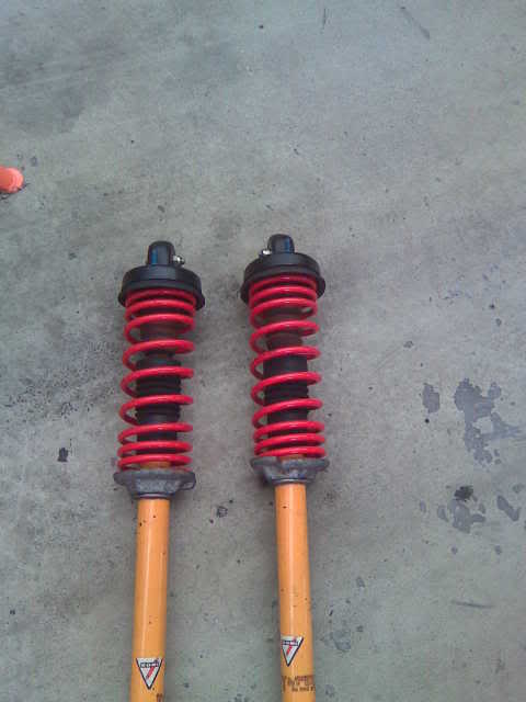

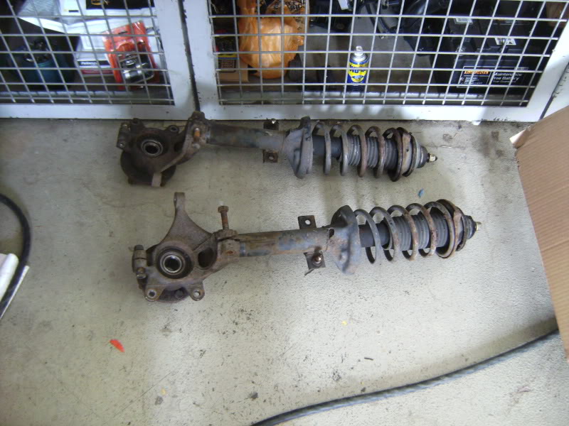

Mk 3.5 front hubs.
Here’s the hubs & shocks (I only bought the shocks as they’ll be useful to allow the car to be moved around during the work that’s happening and also buy me some time to save for a decent coilover kit).
Confirmation if anyone needs it – A Focus 2.0 Zetec Driveshaft & CV Joint fitted into a MK3.5 Fiesta hub, MK3 are a no-go…
Note see my page Mk3 vs Mk3.5
Bit of engine build-up.
Cosworth Upper Main Bearings installed (after thoroughly cleaning the surfaces with Loctite cleaning solvent). ARP Main studs fitted.
Cosworth Lower Main Bearings installed.
Crank Fitted, “Plasiguaged” then re-fitted, ARP Nuts torqued with ARP Moly Lube.
Pistons & Rods fitted using ring compressor and copious amounts of oil – Massive care had to be taken not to break any rings here!
Here’s all 4 fitted, ARP big end bolts and Cosworth bearings used throughout.

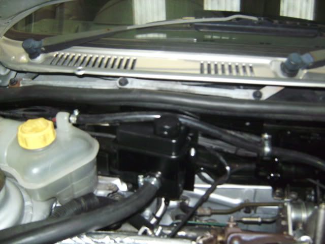

Modified fuel rail
Here’s my modified Duratec Fuel-Rail that now allows for fuel-return (compatible with the MK3 Fiesta’s fuel system) Has -6 male fittings on each end ready for Aeroquip hoses
Oil returns to sump talk
Should hopefully have the rest of the engine assembled tomorrow, aside from the sump which is having a -10 alloy male fitting welded on for an oil-return for the turbo and also a smaller -6 one for a drain line from the oil catch-tank. Also, I’m keeping the cam cover off for now as I’m painting that gloss black.
Balance shaft in the bin talk
A blanking-plate for the balance-shaft assembly oil-feed will also be manufactured as I’m not re-fitting this assembly. From what I’ve learned from people that have tuned the 2.3, the general consensus is that these engines run just fine without it – (the 2.0 doesn’t have it). Plus it’s just more rotational drag and weighs 5KG!
Gets left in!
Engine build (continued).
Right, make yourselves comfortable because there’s about 16 photos to get through here!
Worked like a bloody Trojan today, even skipped lunch and my daily trip to the gym!
First off I installed the cosworth head gasket:
Torqued the ARP head nuts to specified torque with ARP “moly lube”:
Installed Cams and torqued caps up to correct torque:
Note these Duratec Cams have a hexagonal section to hold the camshaft with a spanner whilst tightening the pulleys – useful feature, can’t remember if Zetecs have it?
Installed Oil Pump:
New Oil Pump drive-chain & tensioner fitted:
New Camchain tensioner fitted – note the grenade-style pin that you have to pull out once fitted!
New Cam Chain & Guides fitted:
Once Cam sprockets torqued to spec, a bead of gasket was applied to the front cover, this was then fitted:
Thermostat (bet you never expected it to live on this part of the engine eh?ย ) and water pump outlet fitted:
Block Breather & Oil filter housing fitted. Standard “save the planet” Injectors removed:
Thought I’d go mental at this point and trial-fit my Cossie inlet manifold!
 Note that the power steering pump, alternator, tensioner & Idler pulley are all fitted too.

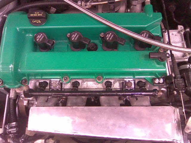

The cam-cover is waiting for me to paint it (still can’t decide on the colour – Moondust Silver, Gloss Black or Green to match the FRST Stripes and the boost/coolant hoses that I’m getting? for now it’s just resting on the head at the moment to keep s**t out of the engine. The sump is with the metalsmith at work getting the oil returns welded on. Still waiting for my exhaust manifold from Pumaspeed…
Cam cover, fuel rail and sump painted.
I fully cleaned then rubbed the manky cam cover down today and gave it a few coats of primer – Painting it Ford Modena Green tomorrow
Modified Fuel Rail was painted gloss black – In addition to having -6 male fittings on each end it’s also had the standard pressure regulator and pressure sender ports ground off and welded over as I’m using a Sytec adjustable regulator.
Sump waiting for my mate at work to weld the oil returns on – should be done by tomorrow…

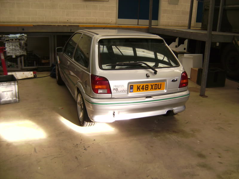

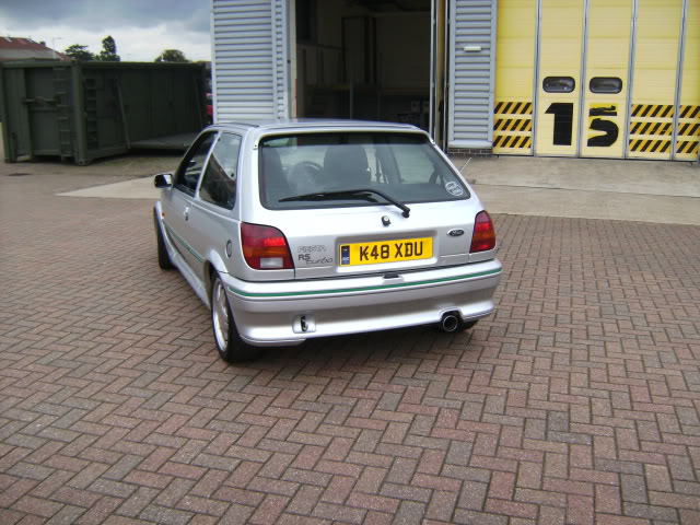

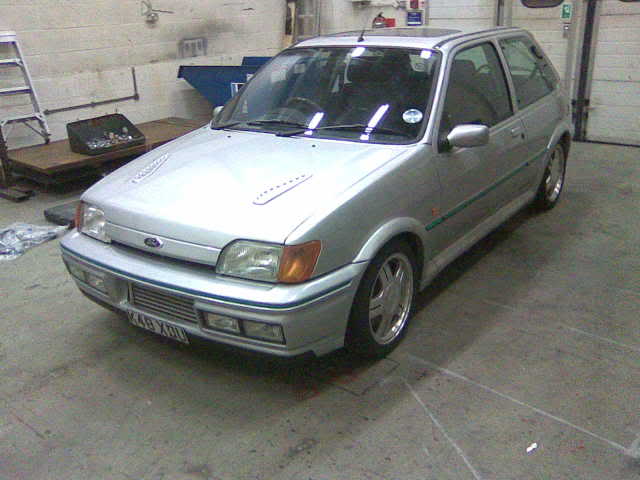

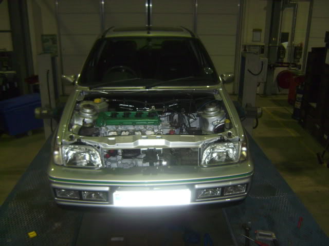

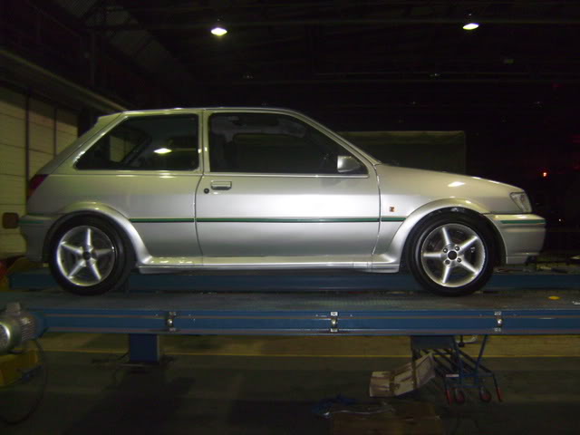

Couple of pics of the actual car!
 My RS2000 rims are still round a mate’s house in Kent, I’m keeping these nasty rims and chunky 195/50 tyres on it whilst it’s being worked on.
Driveshaft length talk
Today I also measured the total width from cv joint-end to cv joint-end with Focus driveshafts fitted into the mtx75 ‘box – I made it 1570mm whereas the the Fiesta measurements were 1480mm – this pretty much matches the dimensions that I used when building “The Manj”. Although the Focus driveshafts are supposed to be “equal”, one is actually about 30mm longer than the other, last time I fitted the shorter one where the longer one was originally fitted, then had the longer one shortened by around 90mm and fitted on the passenger (near side) side. I’ll be getting Cober Precision Engineering, Colchester, to sort me a shortened ‘shaft soon.

Today I sprayed the Cam Cover Ford Modena Green – goes very well with the FRST Green trim
I removed the MK3 Hubs and replaced them with MK3.5 ones, look at the difference between them below – Mk3 are on the right, notice the smaller splined hole?
I also fitted the MK3.5 front suspension, just standard Si shocks with lowered springs to see the project through – I’ll put some decent suspension/brakes on once it’s running…

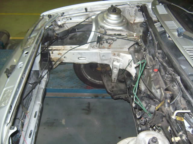

Pitiful state of an engine bay!
 Don’t worry it will be immaculate before the powertrain is installed
I removed the standard manual steering rack and replaced it with the MK3.5 Si power steering rack and steering column, not as straightforward as you may think – the hole in the bulkhead where the column mates up with the rack needs enlarging slighty to allow the power steering column to exit properly.
Pics of power steering vs manual steering components below (PAS parts at the bottom of the pic):
PAS rack fitted:
Mk3 pedal assembly vs mk4/5
I also removed the MK3 pedal assembly in order that I could compare it to the MK4 item I have ready to fit with Hydraulic clutch pedal system. As you can see, the bolt patterns are a bit different!
 It’s not all bad though as the part that’s protruding from the top of the new pedal box with the 2 bolt holes was only bolted to the pedal box – once removed it left two holes in exactly the same location as the MK3 one!
Just got to do some careful measuring & Mig welding on the other face to put the other 4 bolt holes in the same place as the MK3 one and also make a hole in the bulkhead for the Hydraulic clutch inlet & outlet.

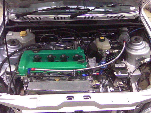

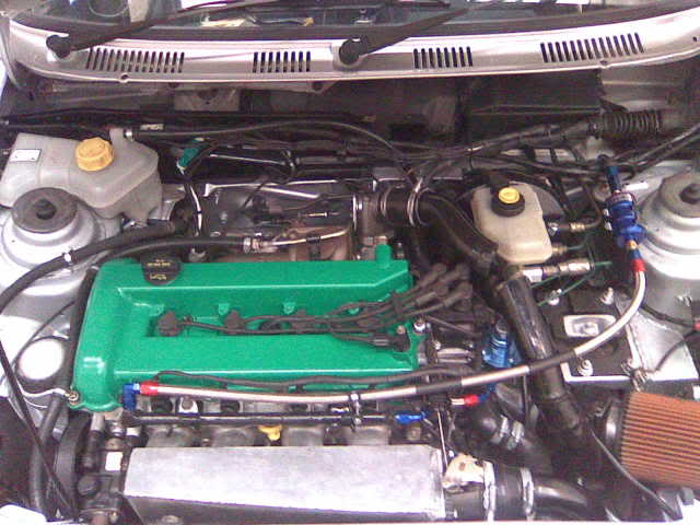

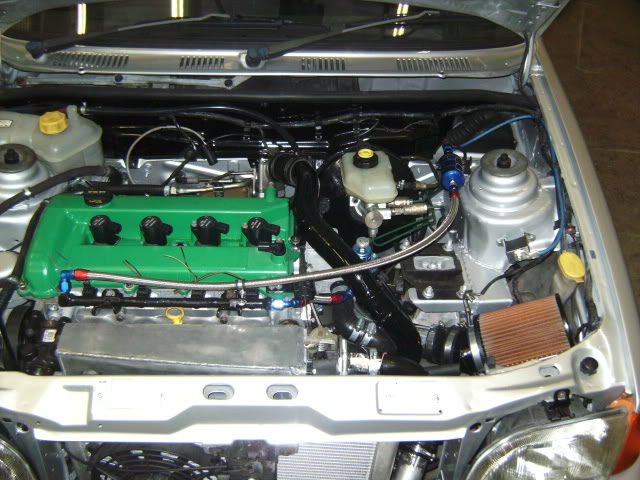

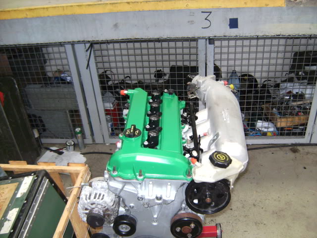

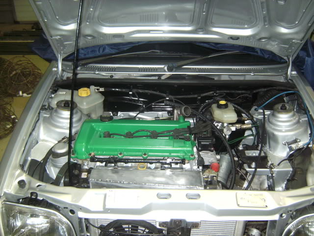

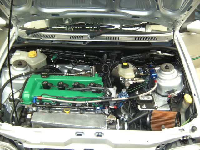

Some engine pics
Couple more pics of my engine – cam cover re-fitted. I think it looks pretty damn nice in Ford Modena green

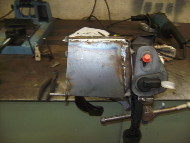

Fiesta MK5 hydraulic clutch pedal box modified and fitted.
Had a busy and productive day today – Did a bit of cutting, welding and drilling and now have the MK4/MK5 hydraulic clutch pedal box all fitted
Firstly I elongated the two holes on the top of the pedal box to make them the same as those on the MK3 pedals – I know it’s not mega neat but hey it’s gonna be out of sight!
As you can see from the pic, as standard the front mounting holes on the MK4/MK5 pedal box are in completely the wrong place – the mounting plate is also too wide for the MK3.
A couple of seconds with an angle grinder rectified this
Next, a 2mm thick piece of mild steel was measured and cut to size on this nice electric guillotine…
…and offered up to the pedal box.
This was then MIG welded to the pedal box ( I know, must get neater!
Using a cardboard template which I mocked up on the rear of the pedal box I then marked out the required area that needed to be removed for the hydraulic inlet/outlet connections – (Looks a bit like a kid’s drawing of a ‘conquering device’ and balls don’t you think?!
After an outline of 4mm holes was drilled around the shape it was then punched out and the edges de-burred and filed smooth.
View from inside:
Pedal box now bolted in place and everything lines up!
 The edges were dressed in using a hammer and drift. They will also be rust-proofed and the whole engine bay is being re-sprayed so it should look good once done.

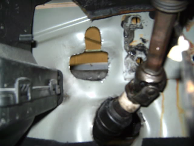

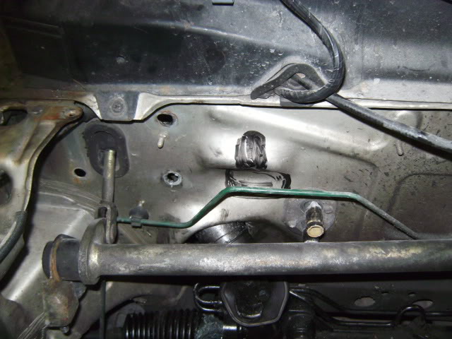

The MK4/MK5 fiesta pedal box hydraulic inlet/outlet area has a foam surround that seals against the bulkhead as the bolts are tightened, should anyone be wondering what the grey stuff around the black pipes is…
Just need to cut the hole for the brake linkage bar now and re-fit the steering column

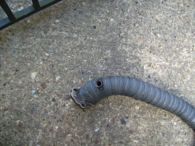

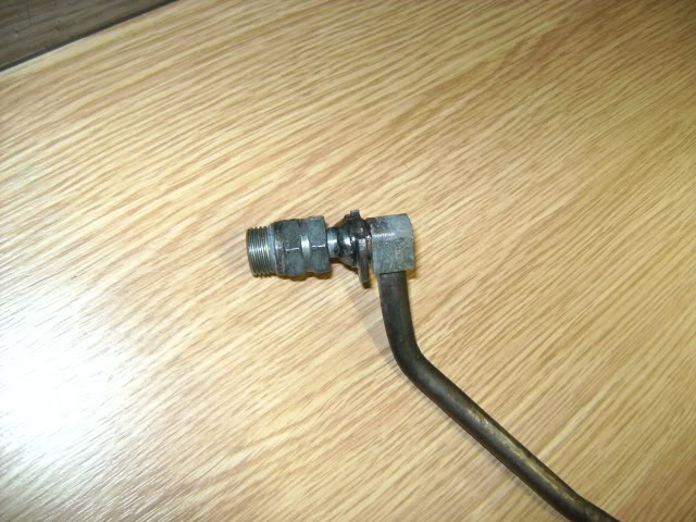

Hybrid Mondeo / mk3 Fiesta PAS pipe
Hi everyone, got bored in my lunch break today so thought I’d tackle a niggly power steering issueย
As you know, I have the PAS pump which is standard fitment on 1.8/2.0 Duratec Mondeos, 1.8/2.0 Duratec Focus and Fiesta ST (That’s the one I have). The problem is that the Fiesta Si high-pressure PAS pipe won’t fit the PAS pump of the Duratec and the Duratec pipe wont fit the PAS rack of the MK3.5 fiesta!
The Mondeo MK3 rack high-pressure inlet connection is just a “push-in” type that has a plate which bolts it on to the rack, the fiesta one is a more conventional swivel-ended screw type that screws into the rack.
Therefore I carefully cut the Mondeo push-fit end off that pipe, (keeping the flat “collar” that’s on the pipe to allow for a stronger base to weld to) did the same with the Fiesta screw-fit end from the Fez pipe, cleaned the faces up then carefully welded the Fiesta end to the Mondeo Pipe. A small bar was inserted into the pipe to keep alignment correct throughout.
The finished article – later on I painted any exposed metal as the pipe is steel and I want it to last at least a year! Fits a treat too
Not the most exciting update I know but it’s one of those crappy little jobs that I didn’t want to do at the end.

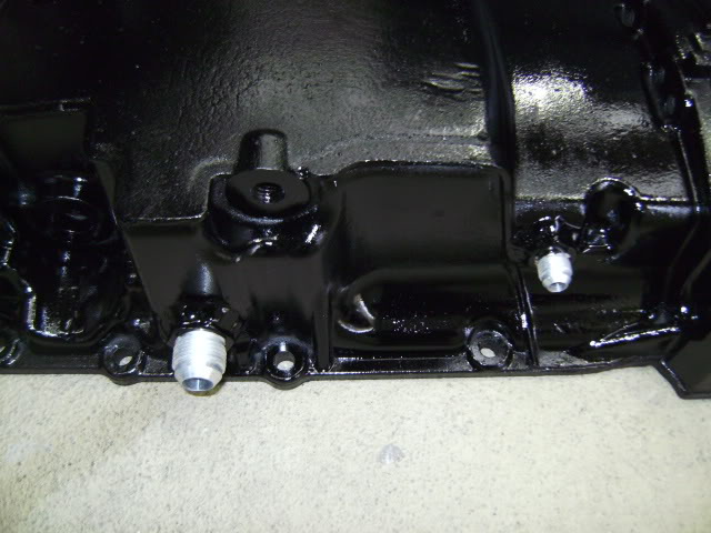

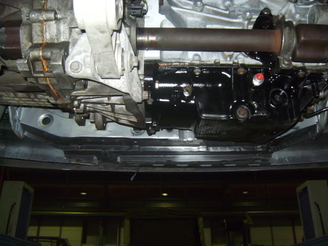

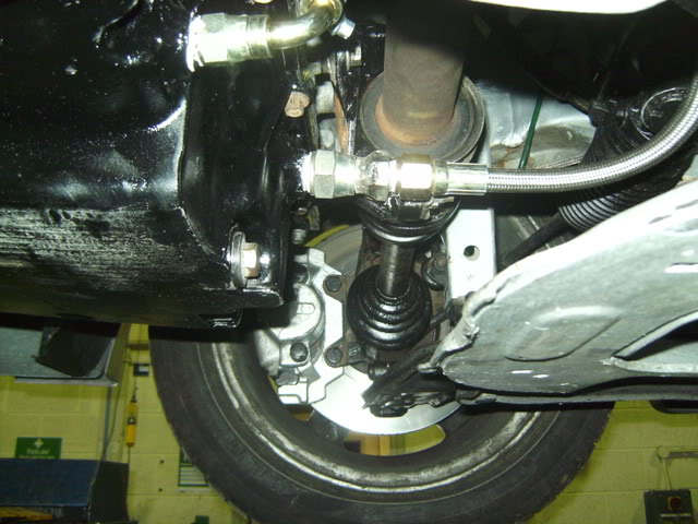

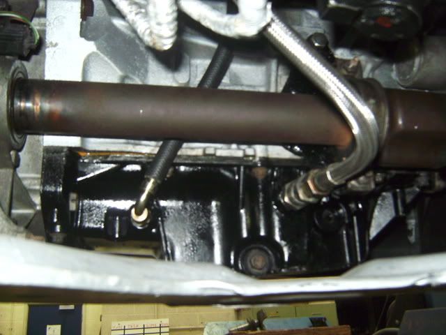

Sump oil returns.
Bit of progress today

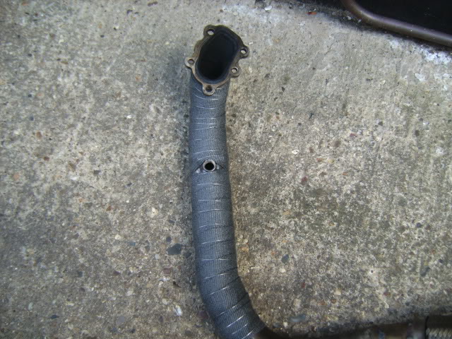

 Got my sump back from my mate, Frenchie, at work who’s kindly TIG welded my -10 turbo and -6 oil catch-tank oil returns which I bought from Earls hoses. The sump was cleaned of swarf and rubbed down, followed by a couple of coats of gloss black engine enamel. Sump and dipstic were fitted this afternoon
Intercooler mounts welded
He also fitted some new brackets that I made for the GRS intercooler (the old ones had seen better days…)
EGR blanking
Another niggly problem – The EGR valve needed removing as I’m not intending on routing exhaust gasses back into my inlet to save the planet!
 (Looks awful too!) Here’s the offending item…
Using the old gasket as a template I made a blanking plate out of aluminium, here it is shown before I cleaned the mating faces and fitted a new gasket, along with some shorter bolts.

Pics of Mk1 Focus RS box won on ebay
Got lucky on Ebay today and bought a Focus RS Gearbox (so much for not touching the Christmas spends!
As most of you know, the Focus RS Gearbox already has a Quaife ATB Diff fitted as standard, along with shot-peened gears and stronger bearings. Seeing as the Quaife is ยฃ520 + Vat (so more like ยฃ600) new on its own I’ve basically paid half price for it and it comes with an uprated gearbox too!
I’m aiming to collect it on Friday, once in the workshop I’ll take the FRS “Zetec” MTX75 bellhousing off and swap it for my mondeo “Duratec” MTX75 bellhousing. I’ll fit the flywheel, clutch and gearbox to the engine the following week when I’m on leave again.
Exhaust manifold fitted
Had a bloody mind-numbing 320-mile round trip today to collect the FRS ‘box, but at least I used work transport and fuel!
Here’s my new exhaust manifold resting on the studs at the moment (will be covering in heat wrap and fitting the turbo soon). As you can see it’s not a funky “bunch-of-bananas” & equal length primaries affair, instead it’s just cast steel and compact but perfectly adequate for my power needs

Here’s the standard MTX 75 Open Diff (services no longer required!)
Compare and contrast with this, the MTX 75 Quaife ATB Diff

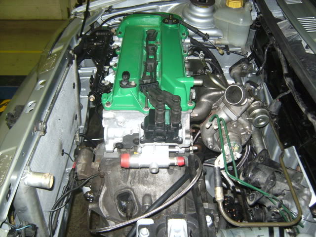

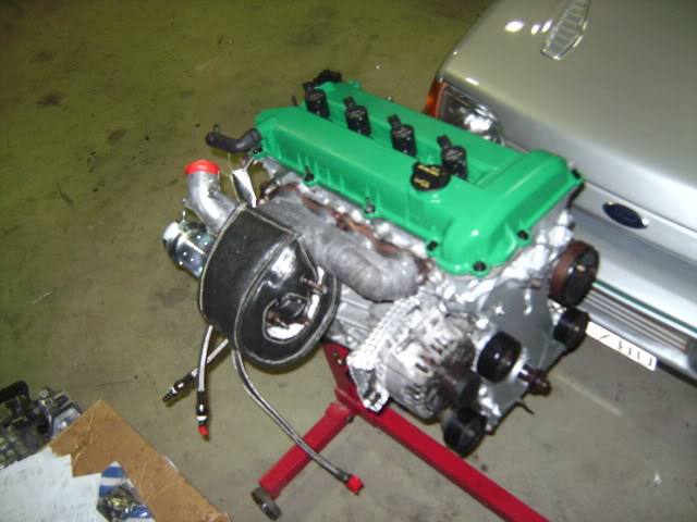

Pic of engine with turbo fitted!
Firstly I added the “Turbo” to the Duratec so I now have a “Duratec-Turbo

Mondy MK3 Duratec bellhousing was then re-fitted, along with the SPEC hydraulic release bearing.

Flywheel & clutch fitted.
Flywheel & bolts ready for fitting…
…and fitted!
Spec stage3 6-paddle clutch all fitted.
Modified gearbox mounting bracket box side
Lastly, I also had a modified MTX gearbox mount made today at work – just as I did with the “Manj”. Basically the “tower” part of it (that bolts up through the mount) has been move inboard about 2″ – this gives me some much-needed room to fit the gearbox mounting point to the n/s inner wing. It’s very strong and has worked fine for me in the past, so hopefully it’ll be ok this time!
Issue with Focus RS/ATB diff in Mondeo MTX box, not turning
Things took another turn for the worse today in the transmission dept
As you know from the last update I had to fit the Quaife ATB Diff into the Mondeo MK3 ‘box due to differences in the two gearbox castings (despite them both being Ford MTX 75’s).
Before I left last night I noticed that the diff was very hard to turn with the driveshaft fitted (much more so than when it was fitted in the FRS ‘box) so this morning I stripped the box down again and started investigating…
I noticed that it was only the diff that was tight, both mainshaft and input shaft rotated fine, also the problem with the diff was only present when the bellhousing was fully tightened down, everthing was fine when it was opened by 1mm or so.
I know that the diff bearings (and mainshaft/input shaft)of these ‘boxes have to be shimmed correctly to eliminate end-float so I assumed that, as I still had the Mondy diff shim fitted then that could be the culprit? I removed the shim and re-fitted the diff bearing, the diff itself then the bellhousing – STILL too tight!
One thing I noticed about the FRS ‘box is that it has a thin metal gasket between the bellhousing and gearbox casing – no other MTX 75 has this, so perhaps they knew there was clearance issues with the Quaife?
 On the other hand Quife list the same ATB diff part number for all variants of MTX75 and there’s no mention of any gasket required
I’ve emailed Quaife this evening so hopefully the can be of assistance…

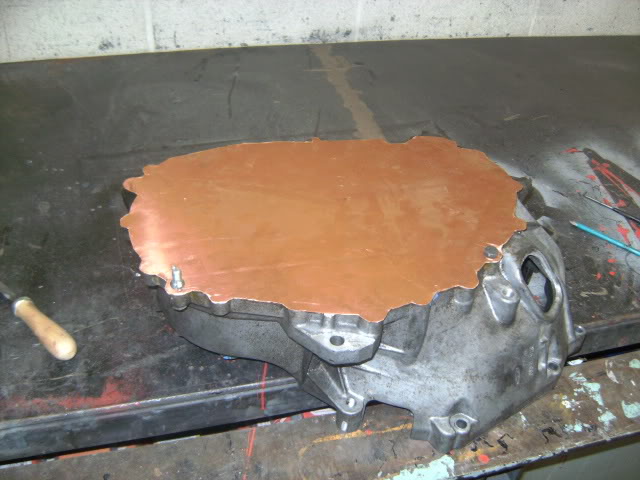

My other idea was to make my own gasket at work out of 1mm thick copper and make shims up of the same thickness for the main & input shafts (thereby keeping their end-float consistent), then I can check the Diff endfloat too and hopefully it’ll be ok…
Why can’t anything ever be simple?!
Progress with diff issues
Things are looking better today after some graft at work
Recieved an email from Quaife this morning and they reckon that, as they designed their ATB Diff for the earlier “Ford bolt-pattern” MTX75, that the bellhousing casting for the Duratec MTX75 might not be as generous with regards space around the main diff body – bloody Ford!
This afternoon I fabricated a thin copper shim/gasket that would hopefully create the required clearance:
I ended up making two of the bloody things but the diff works just fine now

Diff issue resolved
Had a productive last couple of days and now (at last!) the gearbox is fitted to the engine
All required shims have been made + fitted and the diff turns exactly as it should now, as does the rest of the gearset.
This morning I fitted the new speedo sensor trigger ring, firstly the diff bearings had to be removed from the diff.
Then the ring was fitted onto the diff, followed by the bearing – this was then pressed home by the hydraulic press.

Here’s where we’re up to today – Engine & ‘box joined together, starter motor also fitted.
I need to visit the scrappy this week and remove the driveshaft extension from a MK3 Mondy as my 2.0 Focus Zetec one is (not surprisingly) nowhere near the correct fit on the back of the Duratec block

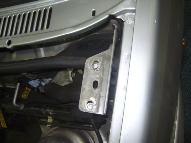

Replaced bonnet hinges
Took a trip to the scrappy and found a nice, straight set of bonnet hinges to replace my horrid, bent ones – they were on a Moondust Silver K-Plate MK3 of all things too

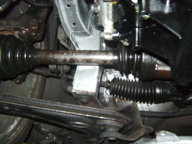

Mondeo/Focus driveshaft extension.
Removed the Duratec MTX driveshaft bearing from the block of a MK3 Mondy, unfortunately the bearing size was much smaller than that of the Focus MK1 2.0 Zetec so the MIG had to step in!
 Here’s my hybrid bearing (Focus Bearing housing with Mondeo block mounting plate).

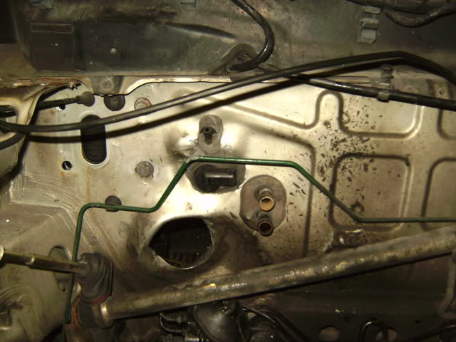

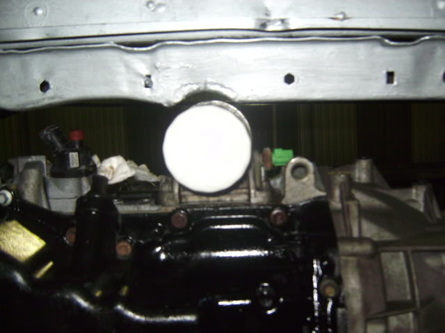

Removing battery tray – to make way for gearbox mount
Removed my grotty old battery tray (Still got black bogeys from all the grinding!)
Removing Fiesta Mk3 Engine mounting point – to make way for new
Removed the MK3 Fiesta Engine mounting point (Needed for access to Duratec Alternator) – Ditto about the bogeys!

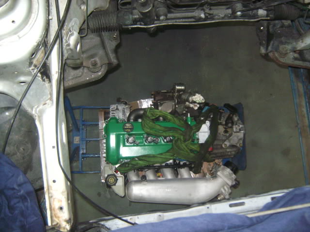

Engine dummy-fitted.
Do you reckon it fits?! Two bloody hopes!
As above, I had to remove sh*tloads of ancilliary parts before the lump would finally get in the hole. I really want to use the inlet but it will need to be made smaller with some creativie TIG action – If it’s a crap casting and doesn’t take weld I’ll have to start from scratch with a new inlet
We’re in!
After a whole day of f*cking about, swearing, gashing my hands and getting molten steel in my hair I finally got the whole lot lined up correctly and tack-welded the transmission and engine mounting points in
Start of engine & gearbox mounting fabrication
That’s all until next week when I’ll be squaring the engine bay away – I’ll be fabricating fresh metal around the mounting points (and jumping on them to “load test” them!), I had to chop a bit of metal out fo the inner-wing to clear the chunky MTX75 so I’ll be adding some strength back in somewhere it won’t foul the gearbox.
After that I’ll be cleaning it all down, seam-sealing then priming the ‘bay then hopefully getting it all sprayed Moondust Silver.

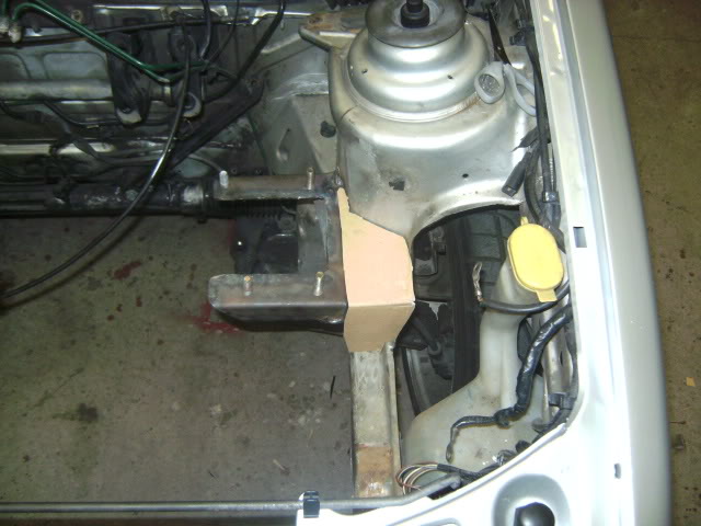

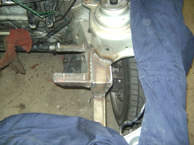

Final fabrication of engine / gearbox mount points
Today I welded the mounting points in properly and sorted the clearance for the MTX 75/inner wing/chassis rail.
For the gearbox mounting I started by mocking the required piece in card first.
Then started making a duplicate in mild steel…
All welded in
Same detail for the engine mounting point, card first…
All done.
Here you can see the area that has been created to clear the gearbox – once the gap was opened up, I used some 4mm thick mild steel to restore the strength to the chassis rail and inner wing – should look a lot nicer once the seam sealer has been applied and it’s all painted.
Here’s the small area that had to be removed to provide a bit more clearance around the Duratec Oil Filter housing – to be honest I was a bit “previous” by hacking it out in the first place – once I had everything lined up properly there was a bit more space than I first thought, ah well better safe than sorry!
 Still got to sort the top out – ran out of time today.

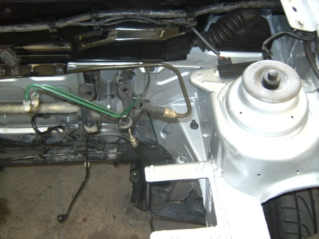

Engine bay resprayed.
We’re another stage closer now – engine bay is all resprayed and looking a damn site more presentable than it was a few days ago!
I applied seam-sealer to all the exposed welds, followed by 2 coats of primer, waited 24hrs then 2 coats of Moondust Silver, another 24hrs then 2 coats of lacquer. I know it’s not exactly pro-standard but I’ve at least achieved my aim of making the engine bay look presentable!
Little comparison…

Mondeo MK3 MTX 75 gear linkage fitted.
Another busy day, managed to fit the gearshift setup and keep it all looking factory-fit (almost! )
Firstly I gave the car a clean as, despite my best efforts to keep it covered, there was metal-dust all over the place due to my efforts with grinders/mig etc over the last few weeks, that all needed removing before it could start rusting and end up trashing my nice bodywork!
Check out the cheesy sticker on the rear ‘screen  – I would keep it a proper sleeper but I need some recognition for all this graft, so there it is!
Fitted all hydraulic clutch and PAS pipes that would be a Bicโ„ข to fit once that beast of an engine is in the hole.
There was a bit of a setback today when I tried to mount the gearlever mechanism inside the car and bolt it through the floor (as I did with my previous ST170 transmission). Unfortunately, the Mondeo MK3 gearlever mech is HUUUGEand if fitted there would mean a very tall gearlever (as found in a Bus!). Worse still, the centre console would never clear the cable shift & selector mech so a bit of creativity had to step in!
Here’s how high up everything was originally!
Basically I made a steel cradle up that allows the mechanism to bolt in from beneath the car, saving me a vital couple of inches – this was duly fitted and now everything fits and looks ok.
Trim re-fitted, full range of gearlever movement too!
Still got to do a bit of tidying underneath but the hard work’s done – not touching the car again until after some serious New Year’s drinking!

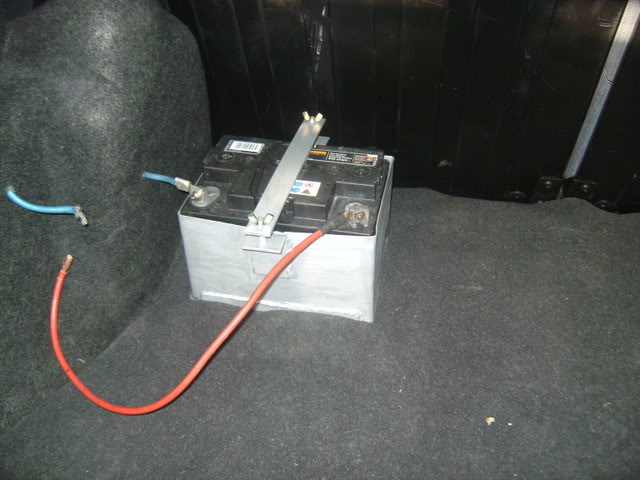

The battery is now residing in the boot – here’s a couple of pics of how I went about it…
Battery fitted into boot.
I used a Mini centre exhaust mount as a remote “live” terminal to hook up all the usual live connections to where the battery would normally live.
The wire back to the battery in the boot goes into the bulkead via this grommet, then under the interior sill trims all held in place by the plastic cable clips already put in place by Ford.

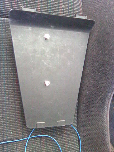

Here’s my battery box that I made yesterday – I’m a tight bugger and won’t pay ยฃ20 0r ยฃ30 for one when mine cost ยฃ0.00!
 It’s bolted to the boot floor, the holes are painted and sealed.
Waiting for the big-ass ANL fuse holder that’s coming in the post (hence the + wire being left doing nothing in the pic). I have a 300A ANL fuse going in there to safeguard against potential shorts/fires
 May fit a cut-off switch at some point too…
Mondeo Mk3 gearbox mount aquired
Bit of an update
 I spent a couple of hours in a snow-covered scrap yard today freezing my nads off tring to remove the rear gearbox mounting bracket and mount from a MK3 Mondeo 2.0 Duratec, It was made all the more difficult with ice and muddy slush everywhere, the fact the car was ground-mounted with no wheels on and my pink, frozen mong-hands not working properly!
Here’s the rear mount and the block bracket:
Crank sensor fitted.
Also managed to acquire a crank sensor as mine was broken.
Not sure if you know or not, but that sensor gap has to be pretty exact. They cause all sorts of bloody trouble if fitted even slightly out. When new they even come with a little gap jig. A couple of minutes now can save a good old headache later!
Turbo Coolant Pipes
Finally got back into the workshop and knocked up some turbo coolant pipes using some spare power steering pipe and some M14/1.5 Banjos, taking care not to get them in the way of where the oil lines will go (still waiting for them to arrive) and also the actuator.
Rear view

Engine & Gearbox fitted.
No you’re not seeing things – that’s a 2.3 Duratec-HE Turbo in a 1992 MK3 Fiesta
Had a mad moment last night and after my wife & daughter went to bed, I cracked on through the night to get this lot done
Doesn’t even sit any lower than when the CVH was in there!
Bonnet still shuts (was having horrible thoughts that it wouldnt! ) need to still adjust it to sit straight yet…
Rear gearbox mount fitted.
Lined up on the lower crossmember.
A jiffy with the MIG later…

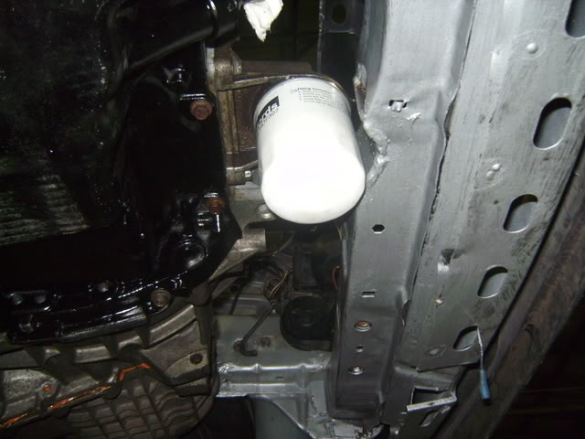

You can see more clearly here why I needed to modify the front panel to clear the oil filter housing!
There’s no chance of it touching – the photos don’t quite illustrate how much room there actually is, plus the way these engines mount, they can’t lunge fore/aft like the CVH’s used to – knocking chunks out of the rad/bonnet!
Starter motor fitted.
As you can see, the actuator bracket needs some trimming!
 There’s plenty of room to “contour” its shape around the brake linkage bar so that the two never meet.
Fiesta ST150 PAS Reservoir Needs A Rethink.
When the power steering pump was re-fitted, it became apparent that I need to use a remote reservoir though as the pump-mounted Fiesa ST item is just too tall for my diminutive MK3!
Obviously it’s fingers-crossed time for the inlet plenum – I’ll see whether it takes weld next week if I can when my mate who’s good a TIG is back.

Notes ref Caterham inlet not suitable & new manifold fabrication
As I showed a few weeks ago, the Caterham Cosworth inlet plenum was just WAAAY too big to have even the smallest hope of fitting in what’s left of my engine bay . As a result I sold it on ebay for near enough what I paid then set about designing and fabricating a custom compact aluminum plenum that’s more suitable for my needs.
There’s only about 7.5″ room between the face of the head and the rad/slam panel, so I’m aiming to keep the depth of the plenum to 6.5″ to allow room for movement etc, also as it’s located right at the front of the ‘bay it can’t protrude too high as the bonnet won’t shut!
I’m using 4″ X 4″ section 400mm long aluminium extruded tube for the main plenum body (I cut this to size today) and have already made a throttle body mounting plate for the end, complete with time-sert steel m6 threads. This is housing the standard 2.3 Duratec 65mm throttle body. I’ve also ordered a twin DCOE/Throttle bodies Duratec inlet manifold from ebay which is going to be TIG welded to my plenum as soon as it arrives!

Plenum / Inlet coming Fabrication coming along
Some Aluminium bits from those nice chaps at Earls Performance Hoses arrived today – the weld-on fitting for the A.C.T Sensor, along with the -4 & -6 fittings that my vacuum/boost fittings are connecting to  Also, the FRST ISCV turned up too
I cut the plenum along its length yesterday so that it tapers in from the throttle end, just waiting on the Ally velocity stacks + throttle cable so Mick and I can get this thing put together.
Here’s how the inlet plenum is taking shape – in the pic the inlet is upside-down as all the vacuum/boost take-offs, ACT sensor and ISCV will be mounted on the underside for a clean, un-cluttered look. The main reason though is clearance for closing the bonnet!
 As you can see the velocity stacks arrived but as the first pic shows, they were a bit too tall for my compact plenum
 A bit of a tickle in the metalsmith’s workshop later and they’re now a decent size.

Cosworth front discs / RS2000 rear discs fitted.
Escort Cosworth front brakes now installed, a nice well-proven budget brake upgrade and perfect for my car as it’s staying on 15’s (NOT the hideous TSW Stealths that it’s wearing now!

For now I’ve reverted back to a conventional single coil ignition setup as I just want to get this thing up and running for the least outlay and hassle for now – I’m keeping the individual coils stored in case I get adventurous at a later date
Pro Alloy rad fitted.

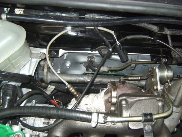

Also fitted the Pro-Alloy rad, firstly so I could check that the plenum will fit, but also so I could gauge the route my coolant hoses will take.
Here’s a view of the turbo oil return to the sump and also the one from the oil catch tank.
As is normally the case with project cars, I rushed something when I was tired on a previous spannering session (that night when I fitted the engine) and as usual, it all needed ripping out and doing properly with a fresh mind and body!
 I’m referring to the rear “torque-link” mount that stops the whole powertrain from swinging fore and aft as you take up drive – I got both the main top-mounts spot on but when I fitted the torque link it wasn’t 100% straight and also the engine was “canted” slighly (swung on its axis so that the front was higher than it should be and the rear was lower), meaning that driveshaft alignment wouldn’t be acceptable. As the torqe link just bolts through welded on mounts on the lower cross member, I ground off my original ones and started again with the engine held in the position for perfect driveshaft alignment.
It’s better just to crack on now and rectify any problems than just bodge it and suffer massive failures once it runs!
Here’s the pics of how it sits now
Engine totally straight (not swung on its axis). The best bit is that now the actuator and turbo are totally clear of the brake linkage bar. Also it means that I have slightly more room height-wise for the plenum at the front
Those that have followed this thread will have seen how close the oil filter housing was to the front panel originally
 As you can see, with the revised rear mount there’s plenty more room
O/S driveshaft fitted.
After all that messing around I managed to get the O/S driveshaft fitted, looks straight to me
Oil returns fitted.
One last pic of the car before I collapsed in the bath at home
Finished Custom Inlet plenum built and fitted.
At long last – the inlet plenum is finished!
 Here’s a pic of how the underside looks, (busy!!)
As you can see, all the unsightly stuff is tucked out the way so that it’s all clean and simple from the top.
Bonnet still closes, even with the throttle body and cable fitted (thank fcuk!
RS 2000 servo & master cylinder fitted.
The eagle-eyed amongst you will have seen that the Escort MK5 servo & master cylinder are now fitted too
Originally, the RS2000 MK5 servo came with this 2-outlet master cylinder, useable but a pain in the arse due to the fact T-pieces would need making…
On Ebay I managed to win a MK5 “4-outlet” master cylinder for ยฃ5.00!
 Here it is fitted to the RS2000 Servo (the rear part of the cylinders are identical).
Here it is fitted to the car.
Some of you will have noticed that I’ve started to fit the intercooler, it’s a Radtec S2 Escort item that a friend in the Army gave to me in return for a couple of beers!

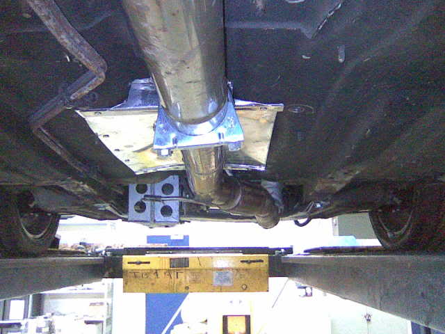

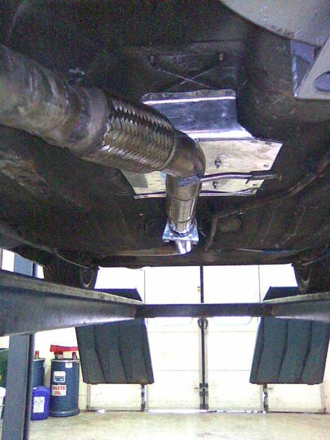

Exhaust fabricated and fitted.
Started fitting some of the Mongoose FRST system too, the pic shows the rear part and centre section are dangling down pathetically at the moment!
 I dummy-fitted it all with the front section as well just to gauge how much i need to remove from the front section (the Duratec exhaust is on the back of the engine unlike CVH/Zetec lumps where it is at the front). It’s looking like around 400mm needs removing but I’ll do a lot more measuring/fitting just to get it perfect, then it’s going to be assembled by my mate Mick
I’ve ordered a Garrett GT28 5-Bolt stainless exhaust flange plate, a lamda boss and some 2.5″ stainless pipe bends etc so we will be making up a new downpipe in-house before making it fit the Mongoose system as soon as it all arrives…
Here’s the pics that I should have taken on Friday!
 I know it’s not the prettiest pipe ever but I had to do it all myself as my skilled welder friend was away
 I know I could have just towed it somewhere and given someone a fat wedge of cash for the priveledge but that’s not what this car is about
Focus RS Clocks fitted.
Notes ref focus RS Clocks in Mk3
As for the FRS clocks I paid about ยฃ100 for them about a year ago. Although they look good, they are by no means straightforward to get functioning in a Fiesta MK3!
You need a VSS (Vehicle speed sensor) in the gearbox, reading the ring mounted to the crownwheel (where your speedo drive pinion normally goes). Both later MTX75 and IB5 ‘boxes came with these in Focus/Mondeo derivatives.
You also need some kind of frequency modifier as the standard setup is calibrated for 18″ rims on the Focus RS – Most people only use 15 or 16 inch rims on Fiestas with smaller tyres too so this requires the speedo to be re-calibrated by use of a “Speedo-Healer” (used commonly for motorbikes – cost about ยฃ50ish).
Lastly you need a Focus partial loom and ECU for the clocks to be driven correctly – there are CAN bus signals that cannot be replicated without great effort so it makes sense to use the Focus bits.

RS 2000 Alloys fitted.
Injectors, fuel pressure regulator & fuel hoses fitted.
Those nice-looking fuel system components that I had laying on my passenger seat for months are now fitted!
Siemens 630cc injectors now fitted with the fuel rail:
Goodridge 200-series -6 hose and connectors are all connected up to the fuel filter, Sytec FPR and return line:
Not 100% happy with the filter being where it is but it had to be relocated due to the Focus Transmission mount stealing its original home.

Just bought a Sytec “F1” (their name for it not mine) Hi-flow billet fuel filter – mine has -6 AN/Jic fittings not the push-fit ones shown, should improve the aesthetics of my engine bay slightly!
… a nice M14 X 1.5 female to -6AN Male anodised adaptor from Earls:
…and a female -6 to female -6 to join that adaptor to the fuel filter (there was no female M14 x 1.5 to female -6 available on Earls or anywhere else I looked which was a bummer as it would have made things more simple!  )

I managed to get a Focus clutch pipe from the same scrappy too as the Fiesta MK5 one I have in the car already does not fit the Focus MTX 75 hydraulic clutch cylinder (see pic below). The MK5 Fez one is at the top:
The problem is that I need half the MK5 Fez pipe from the clutch pedal and half the Focus pipe from the clutch cylinder! Luckily there’s a place in Colchester that makes up custom hoses pretty cheaply so I’ll be paying them a visit soon…

Been having ongoing issues trying to get a suitable aux drive belt and have now got one that fits – a 6pk 2175 (for anyone else that fancies doing the same conversion! )
As I previously mentioned, the Fiesta MK6 PAS reservoir that normally mounts directly on top of the PAS pump can’t be fitted in my car due to it stopping the bonnet from closing
 I bought a Focus MK1 PAS reservoir (yes, from the scrappy! ) today and this is going to be mounted where I’m holding it in the pic below:

Hybrid Focus/Fiesta hydraulic clutch pipe assembled.
For just ยฃ7.00, Hosequip in Colchester chopped the two hoses and then joined the MK5 Fiesta master cylinder end to the Focus MK1 slave cylinder end.

Hard boost pipes fabricated, painted & fitted.
From my previous updates you’ll remember my stroke of luck with the “scrapyard special” Focus TDDi hard boost pipesย
Basically they fitted my setup almost perfectly and I was happy with that. I did try joining them together with coupling hose and jubilee clips but it made things look too cluttered and unprofessional for my likingย
I decided to weld them together instead and here’s the results;
Boost/induction pipes welded together and dummy-fitted;
Removed and sprayed with black lacquer;
Re-fitted once paint dry;

Bumper splitter & small numberplate fitted.
After what seemed like an age, I managed to find an original rubber bumper splitter on ebay for a couple of quid (mine was wrecked). This was fitted and my smaller number plate is now below the FMIC. ( I will be getting a different FMIC or re-manufacturing that one to make it more central once I’ve got the car running).

Gearbox cradle modified and re-fitted to clear Mondeo MK3 Gearbox mount.
 The original cradle that goes under the gearbox was useless with the MK3 Mondeo rear gearbox mount in place and although I no longer required the cradle for gearbox mounting purposes I still need it for the front towing-eye and to keep much-needed strength/rigidity in the car. I chopped the original cradle and modified it to clear the gearbox mount, whilst still retaining ample strengh/rigidity.

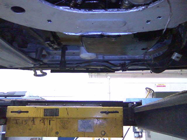

Mondeo Gearshift Mech heatshield fitted.
Firstly, I sorted the gearshift issues by moving the whole assembly back about 10mm which now allows gearchanges without the lever mech hitting the trim!
After that I made a heatshield/cover for the exposed mechanism. (Was all sealed around the edges later on).

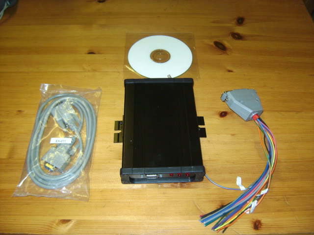

Megasquirt V3 ECU arrives.
Another step towards completion – I now have the ECU!
Megasquirt V3
dangerousdave – yep you were right about the on-board 21 psi MAP sensor!
 No bother though, I’ll still use the FRS one that I bought for the signal to run the boost gauge on the FRS dials…
It was originally bought by a good friend who was going to put a Golf 1.8 20v Turbo lump into his MK1 but has since sold the engine and consequently didn’t need this anymore. He sold it to me for ยฃ100 which was a Godsend just after the Christmas blowout!
Luckily the Golf also uses C.O.P ignition and this is already mapped for that so hopefully it shouldn’t be too much hassle setting this up to run my Ford C.O.P setup.
Luckily there’s a big Megasquirt site with lots of helpful forums and as I’m an Electronics Technician by trade, this hopefully won’t prove too difficult!
Apparently I need to change a transistor for a more powerful one to drive the Ford ISCV that I’m using as the Megasquirt is normally used for stepper-motor type idle valves
Also, I was hoping to fit a boost control solenoid and I’m sure I have to add another driver for that too:-?

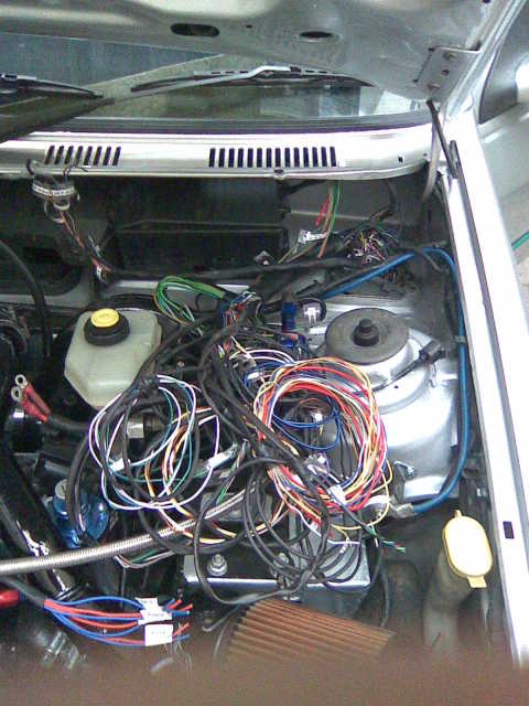

Focus RS Loom arrives
Thanks to “cowie20” on these forums I now have a full FOCUS RS wiring loom which he sold to me for a very reasonable sum, thanks again mate
Seeing this box of wires took me back to when I built the MANJ and had to decipher a whole ST170 loom!

I should have the driveshafts back from recoprop this week and have started making up the engine loom for the Megasquirt, the coil packs and injector loom is all sorted and looking rather neat even if I do say so myself!

Focus RS wiring loom modified & rebuilt to suit my car.
Here’s what a few boring evenings have produced – I have completely stripped the engine loom back to the ECU connector and re-made the loom to suit the layout of my Fiesta MK3 Engine bay + back-to-front Duratec HE engine. I’ve left most of the sensor connectors off for now though so that they can all be added once I have it all in-car once I’m back down south – it will all be tidy and use the normal Fiesta MK3 rubber boot that covers the ECU. The ECU will also be mounted where the MK3 Fez item normally lives.
The driveshafts have arrived from Recoprop and as you can see, they are almost equal-length. O/S one is 380mm, N/S one is 355mm so hopefully torque-steer shouldn’t be as prevalent as it is with the normal Fiesta transmissionย

As per my previous updates, I pared the original Focus RS loom right back to the ECU connector and started from scratch, reconstructing it to suit the layout of my Fiesta’s Duratec engine bay. I’m using the standard MK3 Fiesta ECU mounting location so here is the bare loom emerging from the passenger footwell!
This job is extremely time-consuming!
ย Basically I left all the connectors off the loom so that I could tailor it exactly to my engine bay, and heat-shrink each individual “branch” that goes off to a different part of the bay then soldier the relevant connectors in place (been triple-checking the wiring diagrams and ECU pinouts at every stage!ย ) – we’re partially there in this pic…

Focus RS clocks wired up and all working.
The interior wiring is all done, the dash is all re-fitted and the instruments work!
Almost looks like it was made to fit in an early ’90’s Fez
 Can’t wait to get those other 3 needles moving though

6. Focus RS Post-Cat Lambda sensor needs boss welding further down the exhaust (just for ECU purposes – not planning on using a CAT).

Thought I’d add this pic -you don’t often see the fuel-filler panel on a MK3 Fez looking this good!

1. The Engine is a Ford/Mazda Duratec.
2. The ECU is a Ford Focus RS (basically ZETEC 2.0 Turbo).
3. The Coil-on-plug idea was just a “hit and hope” but works amazingly well driven from the Ford ECU.
4. I haven’t even set the fuel pressure yet.
5. It uses a Fiesta RS Turbo ISCV and still idles like a new car on this ECU.
6. It has Siemens “Deka” 630CC injectors.
7. This is the first engine I’ve ever built from scratch.
I still have to fill the coolant up and tighten the turbo exhaust-flange up properly, and it’s smoking a bit when the throttle is blipped (I’m hoping that this is due to all the oil that I poured into the cylinders to keep it lubed while it’s been satย ). I’ve only started it up twice today and only ran it for about 20-30 seconds each time, so it will probably burn cleaner once it’s settled in…

New custom driveshafts fitted.
Firstly I connected the VSS (vehicle speed sensor) plug to the gearbox, then I lowered the ramps, started her up in 3rd gear (remember – driveshafts still not fitted at this stageย ) and looked at the dash. Lo and behold the speedo works perfectly too!ย
A couple of brews later I had both the new, shortened driveshafts fitted
Nearside;
Offside;

Various issues and smoking, engine taken out
As promised, today I removed the engine & gearbox (space is so tight in there that it’s easier just to lower everything out rather than try to lift the engine out on its own).
Spent this morning removing some more ancills and transmission from the engine and mounting it onto its stand, then I move the whole lot back to my own little part of the workshop ready for it to be stripped down.
The pistons won’t be here until about Sept 10th so I’ll just concentrate on getting everything stripped, cleaned to within an inch of its life ready for the rebuild.
Also will be concentrating on sorting the heatproofing in the bulkhead area – new reflective silver hose covers will be ordered and the new turbo blanket is in the post. I’ll also be sticking some aluminised heat reflective material on the underside of the bonnet just above the turbo/exhaust.
When removing the engine, I found out why it stuttered so much when trying to start it – I’d left the nut off the starter solenoid terminal!ย
Engine stripped
Spent today stripping the engine;
Bores still immaculate.
How I left things today;
The pistons and rings are immaculate and undamaged – selling them on now though as I’ve already ordered the 8.5:1 CP Pistonsย
General thoughts of engine itself not an issue
Still at a loss to find the culprit of the oil-burning – the bores/pistons/rings are all in perfect condition. I didn’t find any sinister particles in the bottom of the sump or in the engine.

Brand-new Garrett GT28R ball bearing turbo (+new water lines, turbo blanket etc).
I decided my car deserves a new turbo – a brand new Garrett GT28R
 Just the same as it had already but obviously nice and new
http://www.turbobygarrett.com/turbobyga … 6541_1.htm
I ordered it today so should have it early next week.
New 8.5:1 CP forged pistons.
Plus my shiny new CP Pistons of 88mm / 8.5:1 comp arrived today
I’ve also splashed out on a rather nice turbo blanket, some new steel Garrett water lines (to replace my shonky home-made efforts!), some more heat matting (for underside of bonnet).

Turbo Arrives
Always nice to find this box waiting for you when you get home…
…especially when you open it and there’s a brand-spanking new Garrett GT28R ball-bearing turbo inside
With new billet alloy compressor inlet fitted.

Inlet manifold leak
Talking of inlet manifolds, I’ve decided to test my homemade effort for boost leaks by fitting a bicycle inner-tube over the throttle-body and sealing all vacuum take-offs off, then sealing it to my stainless work bench!
Lo and behold, I got it to 20 PSI and found a small leak in one of the welds on the O/S edge – I’ll be handing it to Ziggy the welder tomorrow for some remedial attention
 I’d rather find things like this out now than wait until the car’s on the road and losing boost/power and having to rip things back out!

Turbo oil return revised and sump modified.
irstly the redesigned turbo oil drain mod on the sump is done (small brass-coloured connector is the drain for the oil breather tank);

Oil leak cause found – timing cover repaired.
So glad I took this apart now!
 – When I examined the timing-chain cover I found that I’d fitted a bolt that was slightly too long when locking the crank-pulley at TDC during the previous build
 Basically it had punched a hole right through into the timing-chain area, that’ll explain my mystery oil leak then!
 Luckily this has now been rectified by my mate, Ziggy and his Tig welding skills
 (It’s the small bolt right next to the crank-hole)
Turbo Blanket Fitted
The turbo now has all its new water & oil lines connected, is fitted to the exhaust manifold and is wearing its new turbo blanket as-per my endless mission to control radiant heat in the bulkhead area.
I spent a while today setting the gaps on the rings to CP’s specifications – those nitrided top-rings are a real Bicโ„ข to file!
 Even worse when you go straight to filing the second rings which are cast iron, therefore easy to work with so you run the risk of taking too much off – I took my time and got them all bang-on.
Finally, tonight I fitted the rings to the pistons than fitted the pistons to my Eagle rods.

3. Fitted my new wideband lambda sensor into the exhaust downpipe.
