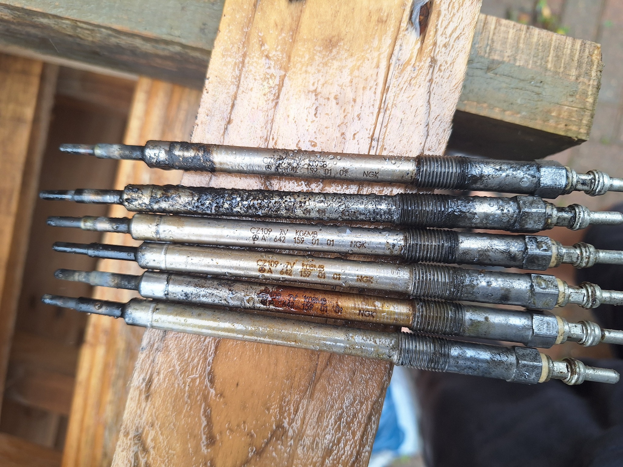

Cleaned all area around glow plugs with air duster. 4 glow plugs came out very smooth(like a butter 😆), only 2 showed slight resistance, but after turning back and forth and a bit of more spray they finally gave up 😅.
I did use glow plug bore reamer to clean all gunk out and yeah it was quite all of carbon build up.
Replaced all glow plugs and used Liqui Moly Pro line grease on a threads and body a bit. Torqued to 11Nm. Cleaned connector caps with electrical connector spray.

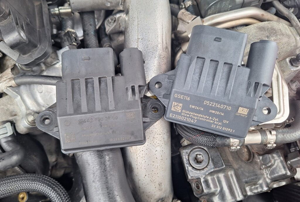

Replaced Beru glow plug module aswell.
