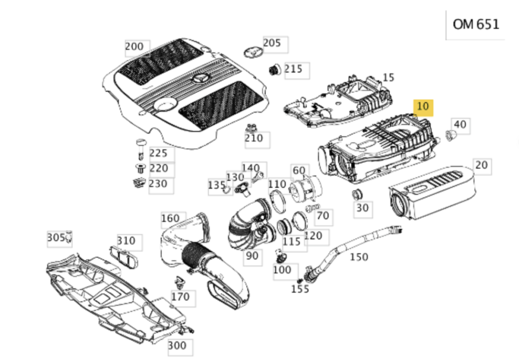

Oil filter – A6511800109
Air filter – A6510940004
(Euro 5) Length 350 mm, Width 176 mm, Height 96 mm
Air filter – A6510940104
(Euro 6) (With AdBlue) Length 350 mm, Width 176 mm, Height 68 mm

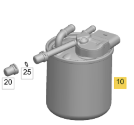

Fuel filterA6510902852

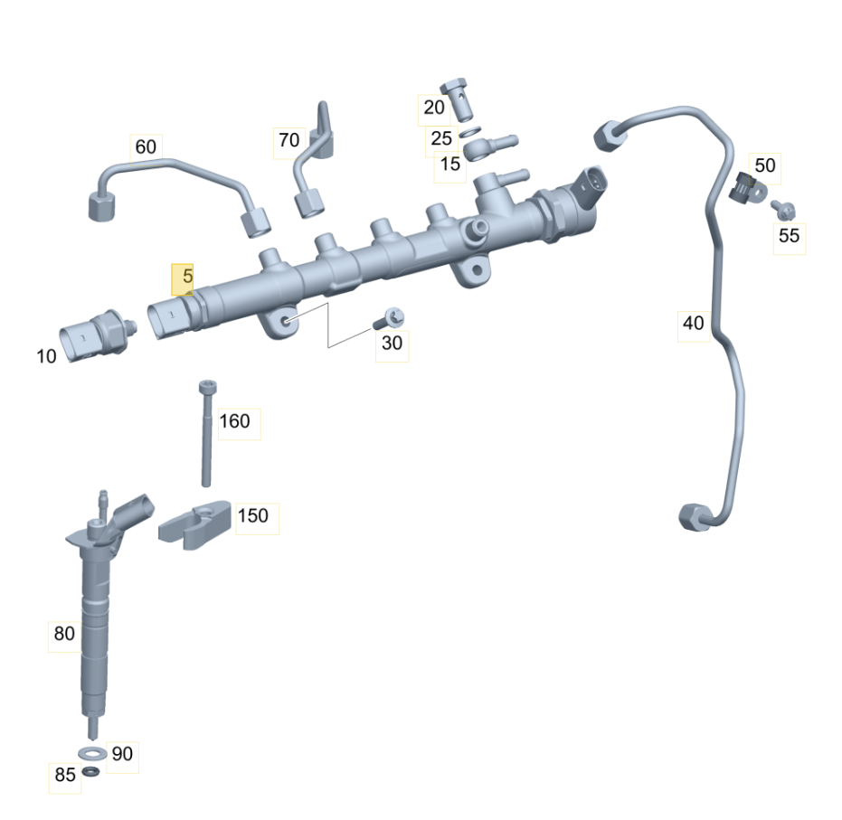

Injectors / Rail
90 – Injector Copper Washer – A6110170060
160 – Injector bolt – A0019902607
150 – Injector bracket – A6510160438

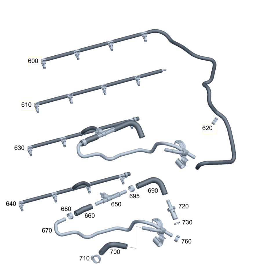

Injector Leak Off Lines
Note, only 600 / 610 applicable to OM651
600 – Injector leak off line complete – A6510700132
610 – Injector leak off line repair – A6510702432

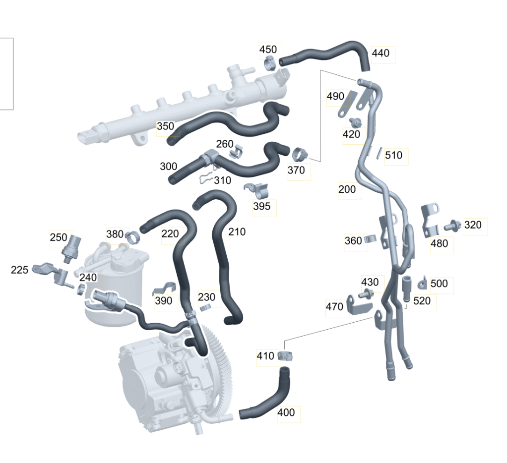

Fuel lines, Engine Bay
Item 380 – Fuel filter hose clip – A0069971890

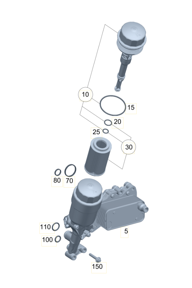

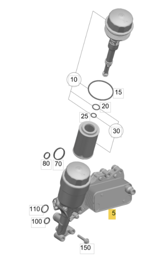

Oil Cooler / Filter Housing Setup
Item 5 – Oil cooler / filter housing – A651180131090 (Old PN A6511801310)
Item 10 – Oil filter housing cover – A6511800138
Item 70 – Oil cooler to cylinder crankcase seal – A6511840480
Item 80- Oil cooler to cylinder crankcase seal – A6511840880
Item 100 – Oil cooler to cylinder crankcase seal- A0199970445
Item 110 – Oil cooler to cylinder crankcase seal – A0199970545

Note, if you are stripping down all of this system to replace these seals, you will almost certainly want to replace the coolant flange (ie fuel filter housing). This has coolant run through it and is incredibly common to leak.
A6512006000 (£32.50+)
