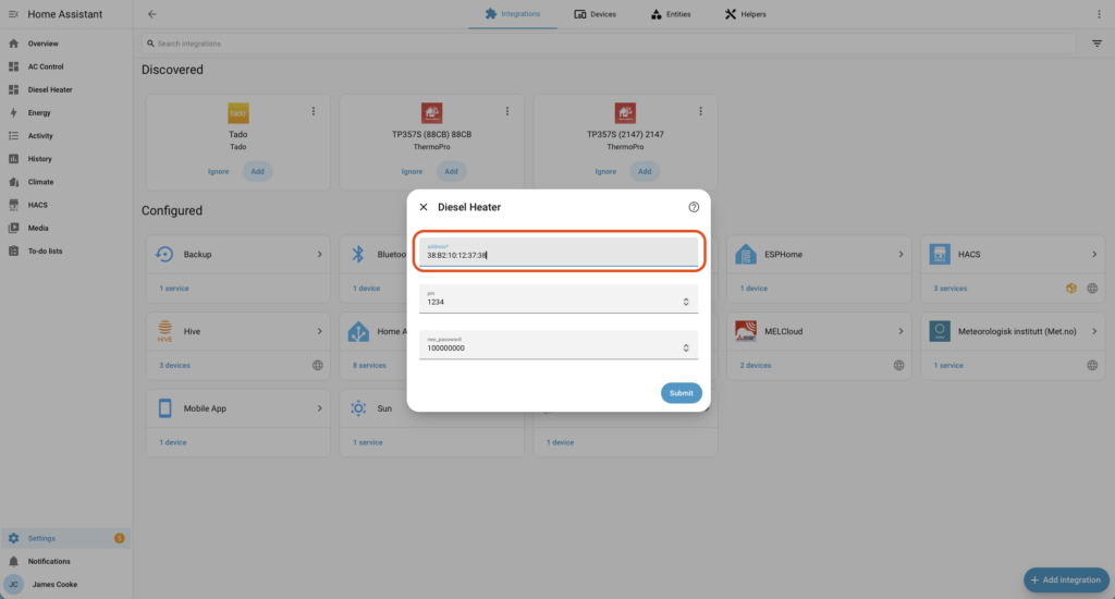

- Step 5 – Install ‘Diesel Heater’ Integration
- Step 6 – Add the Diesel Heater to Home Assistant!

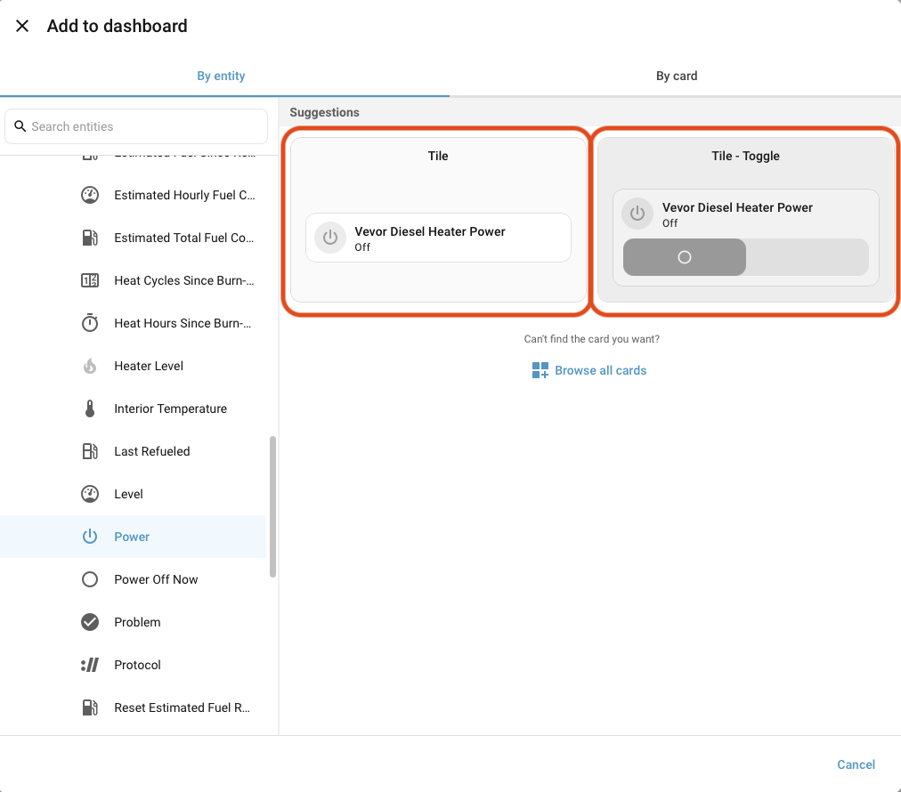

- Step 7 – Create a Dashboard.

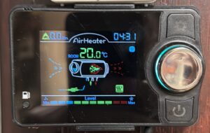

My controller is this one;
In my my instance, the controller the unit has lets me do the following:
- Either, control the ‘power level’ ie set fan speed between 1 – 10. Higher numbers mean faster fan and more diesel = hotter.
- Or, set a temperature in thermostat mode and the controller will adjust its level to achieve. Once set point reached, it can either continue to heat at slowest speed / heat or turn off untill 2 degrees under set point.
- Time display
- A schedule can be set to turn on, and the length of time its on for, from turn on time, scheduled
- Track fuel remaining (based on calculation of usage) (to suit 5L, 10L or 15L tanks only)
- Display additional information by holding the settings button (faults, temp of unit, voltage, altitude)
- Control via bluetooth on a pretty basic app

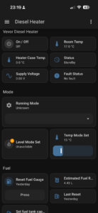

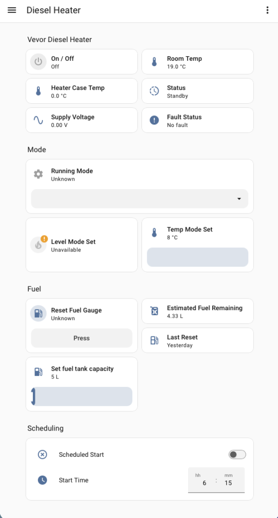

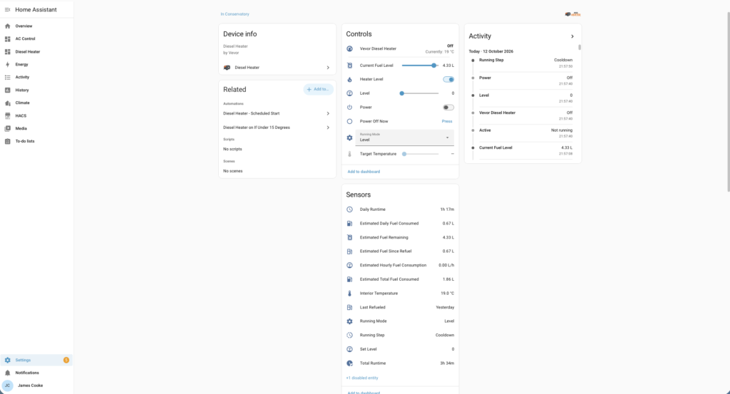

We can also build our own custom dashboard within Home Assistant. Featuring mine below;
Another nice feature of the ‘Diesel Heater’ HA integration that Im using is that it essentially creates more features.
- Burn off mode – Run at max power to burn soot – adjust how often, how long, when etc (Burn-off has been verified only on heaters that use the AA55 encrypted protocol (AirHeaterBLE))
- Time Sync – Synchronize heater clock with Home Assistant
- Fuel Consumption Tracking – Local estimates for the established air-heater protocols. Hourly consumption rate (L/h) – real-time instantaneous rate. Daily consumption (L) – automatically resets at midnight. Total consumption (L) – lifetime tracking
Its ‘local’ – no data will leave your HA setup to the internet for it all to work. If you have remote access set up to HA, you can control it from anywhere.

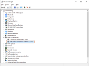

Once plugged into a USB port, windows should automatically recognise it as a USB-Enhanced-SERIAL CH9102
If you buy a slightly different unit, it may have a different chip and be called something similar.
You can check this on device manager;
A different COM port maybe assigned but you need not worry about that if it is.

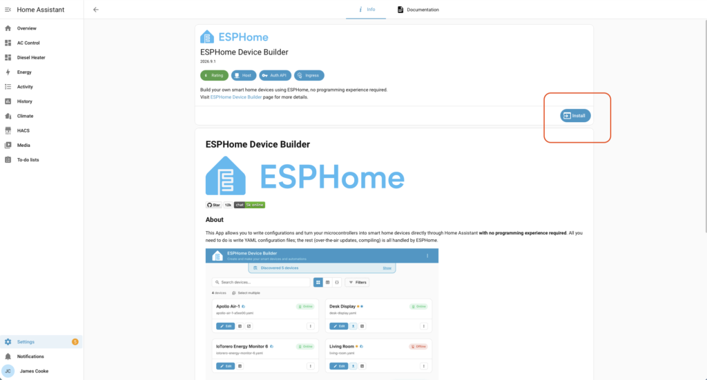

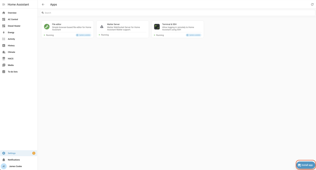

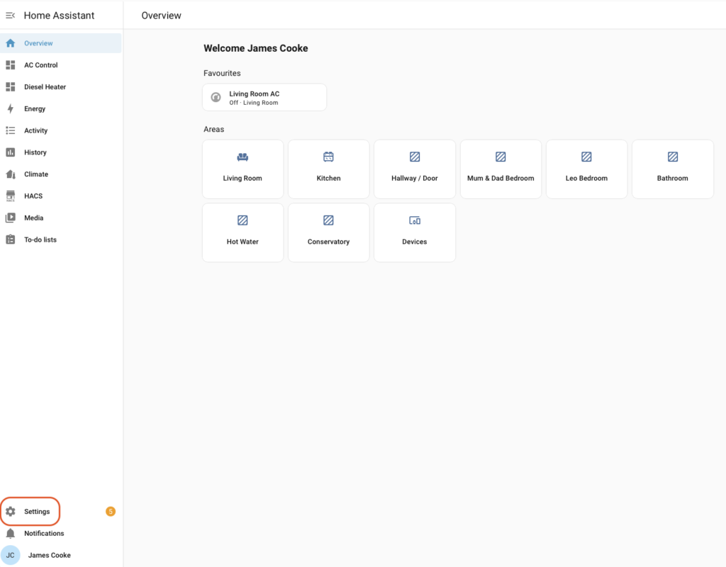

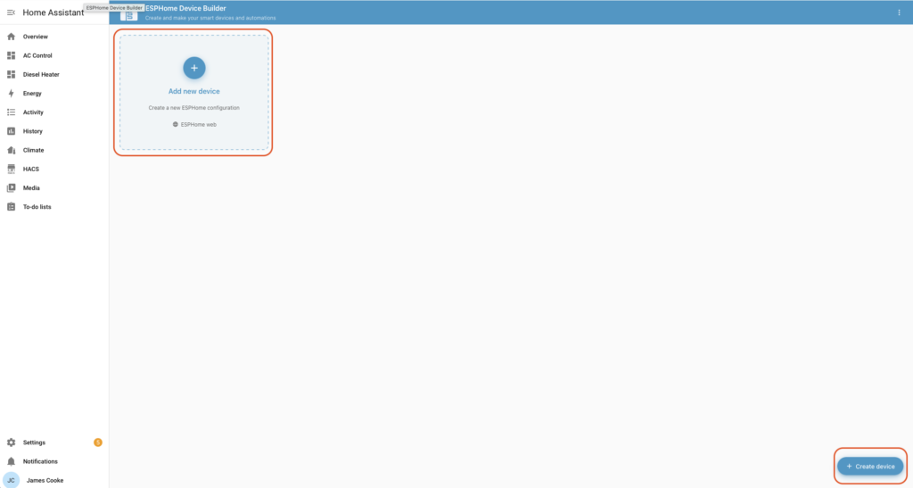

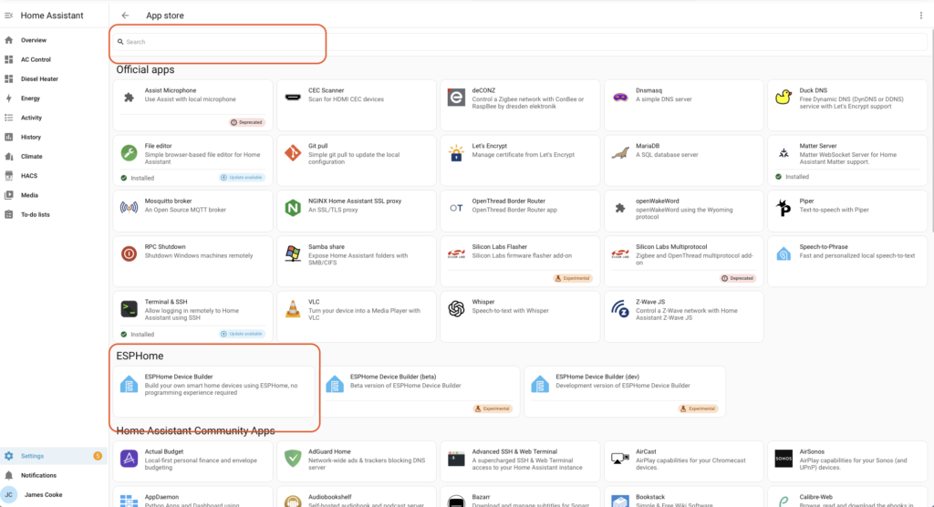

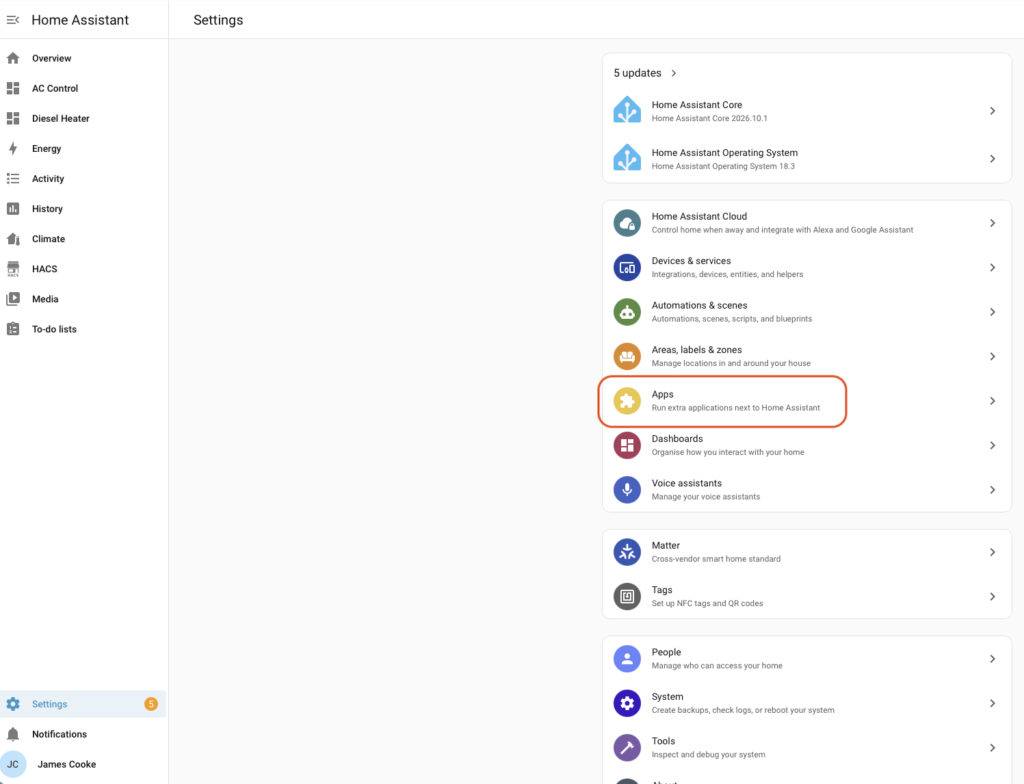

Open Home Assistant in your browser, http://homeassistant.local, head to ‘Settings’ at the bottom left corner then select ‘Apps’ then ‘Install App’ at the bottom right.
It will open this search page, search for ‘ESPHome Device Builder’. Click on it. (not dev or experimental versions!)
Click install;

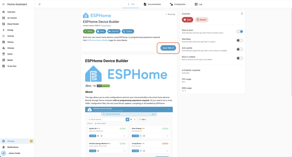

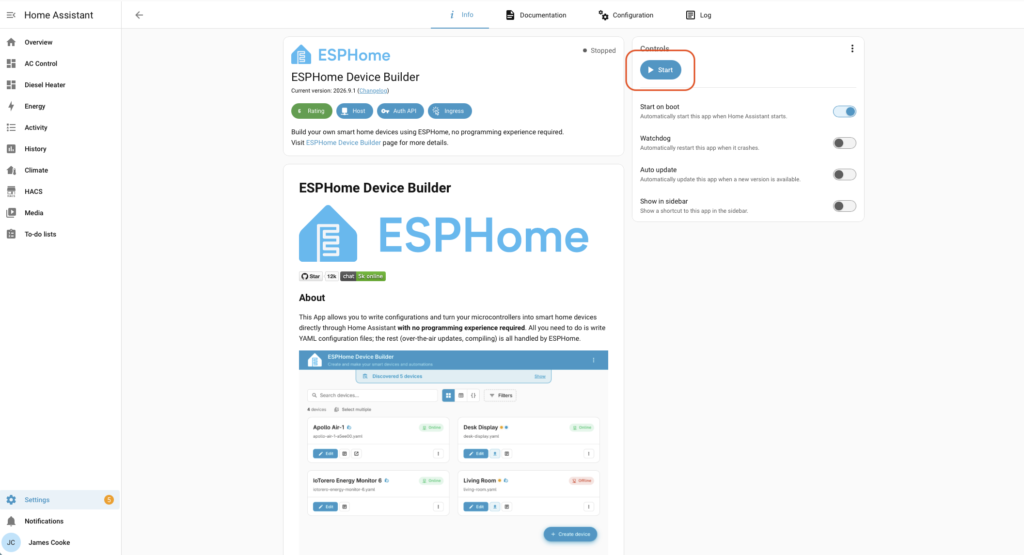

One installed we want to start the application
And then open the application

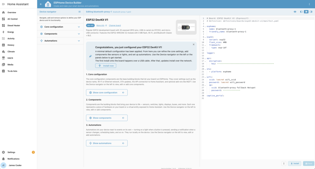

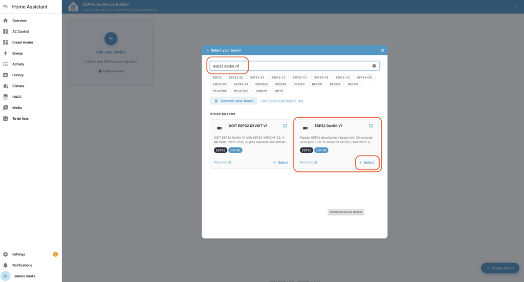

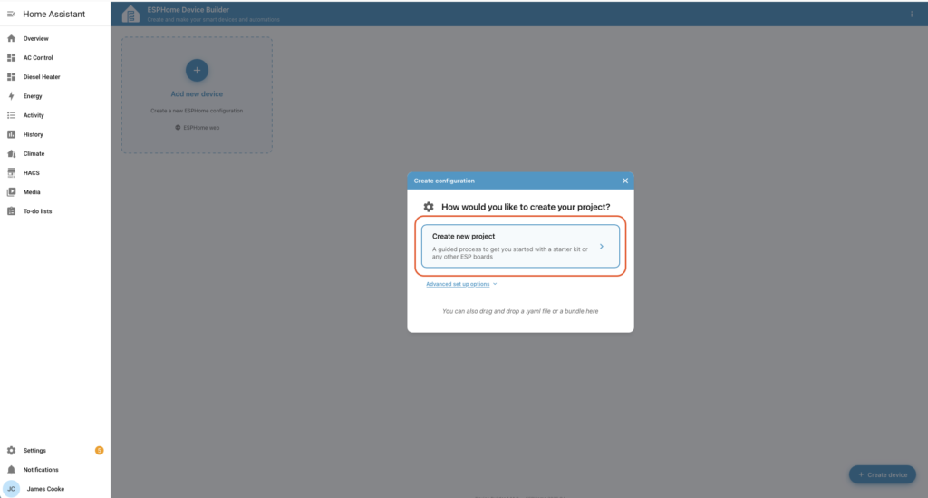

Add new device
Create new project

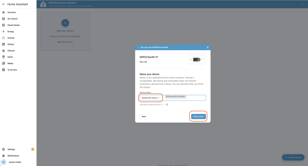

Search ‘esp32 devkit v1’
We are going to name it ‘bluetooth-proxy-1’. Then click finish setup.

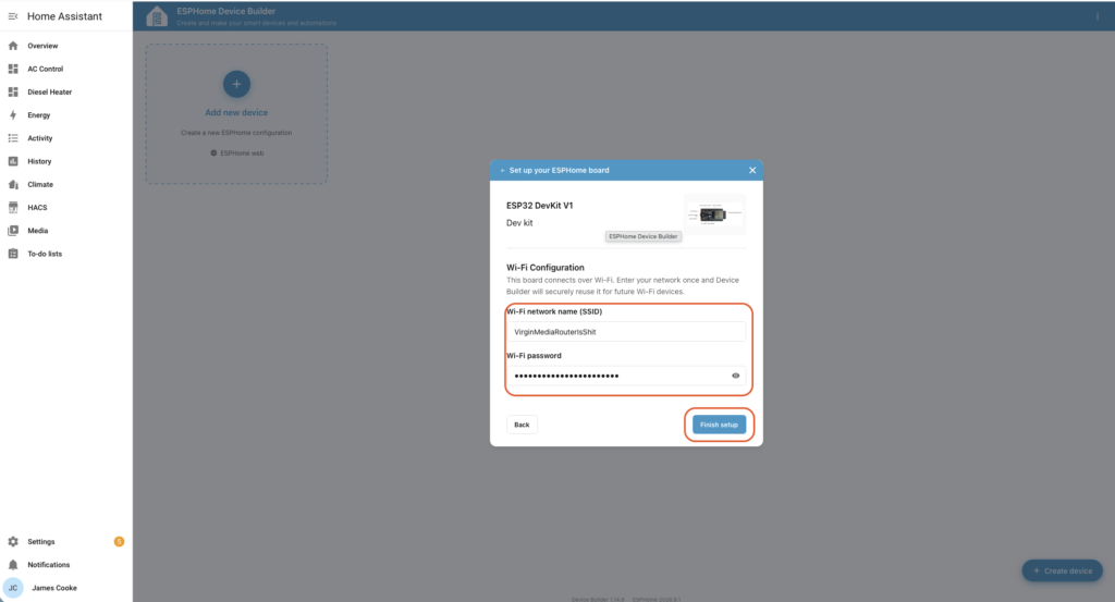

Add your wifi network credentials. Note – the ESP32 module supports 2.4Ghz wifi only – so if your router has separate 2.4 GHz and 5 GHz networks, the ESP32 needs to connect to the 2.4 GHz one. Click ‘Finish Setup’

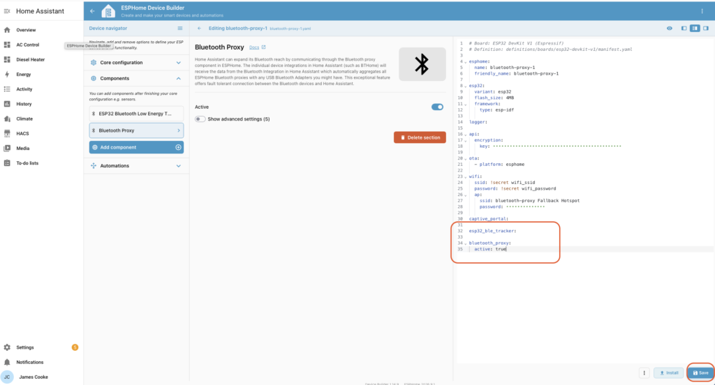

You will be presented with this, the basic initial configuration file. This tells the app that we want our ESP 32 to be called ‘bluetooth-proxy-1’, the module is an ‘esp32’ module, the wifi details are as follows.

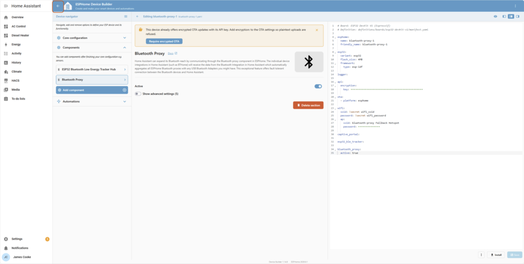

The code section on the right needs a a few lines added to it, so that the operating system builded knows that its a bluetooth proxy:
esp32_ble_tracker:
bluetooth_proxy:
active: true
You should end with it looking like this, this click ‘Save’ then ‘Install’

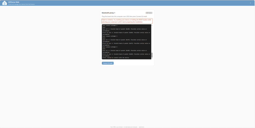

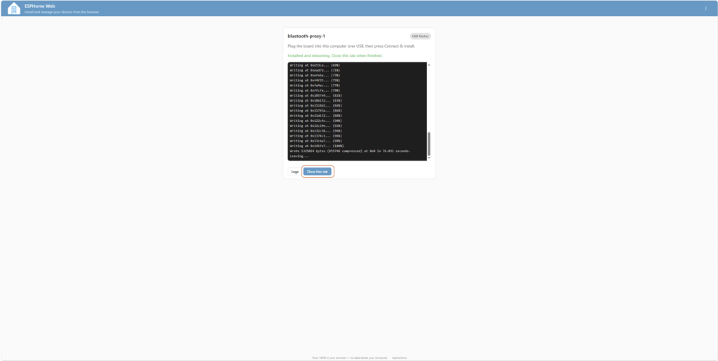

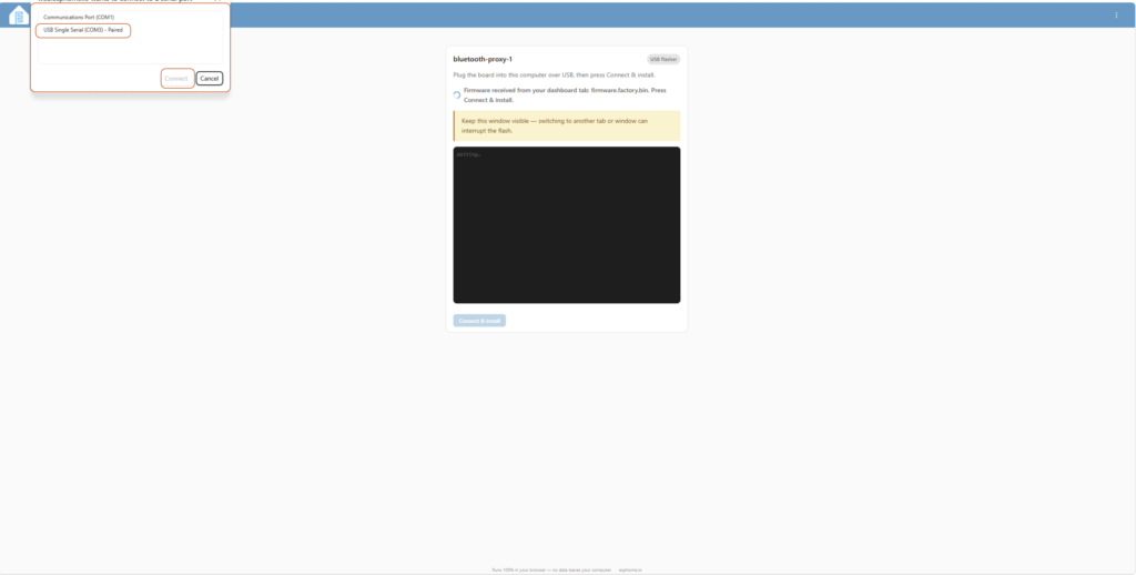

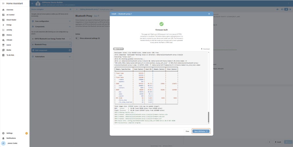

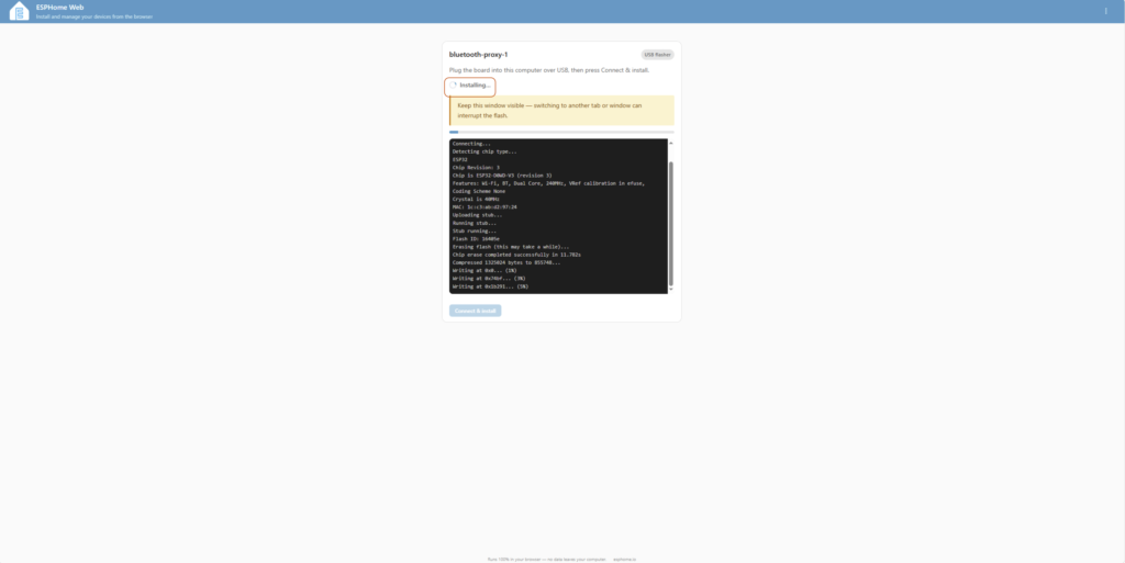

Then click ‘Plug into this computer’. You’re going to see a series of screens here. The app is taking the configuration and writing the whole operating system.
If you ‘Show Details’

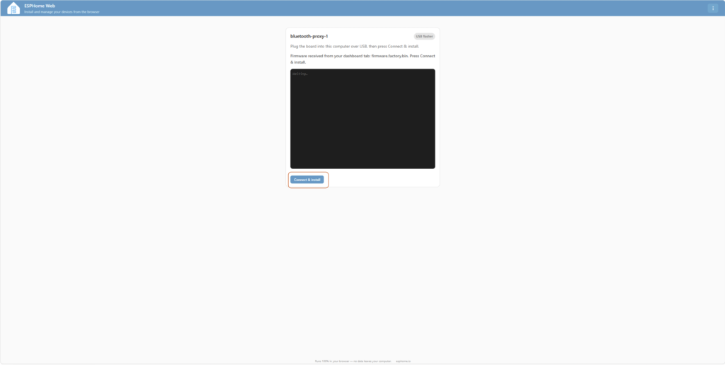

Once finished ‘Open USB Flasher’
Follow the prompts to ‘Connect and Install’, Authorise connection to ‘Com3’ (or what has been assigned per Device Manager). It will now flash the operating system to the device.
You may need to hold the ‘BOOT’ button on the device when you connect and install

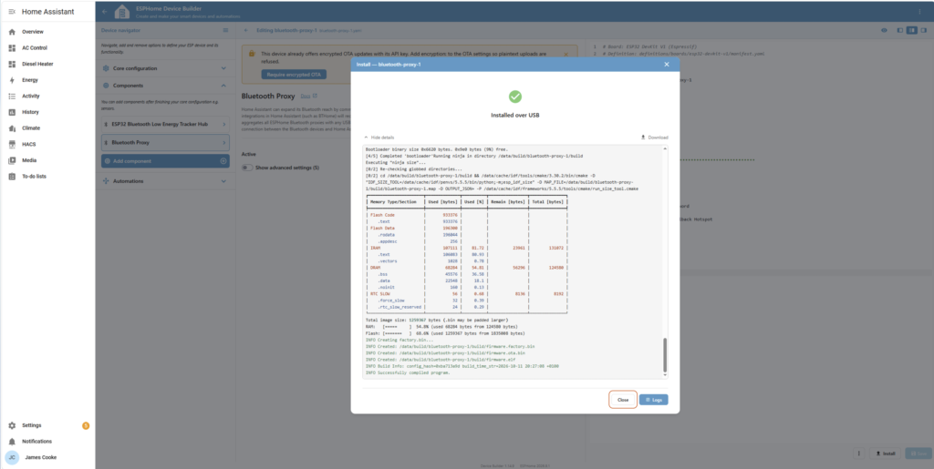

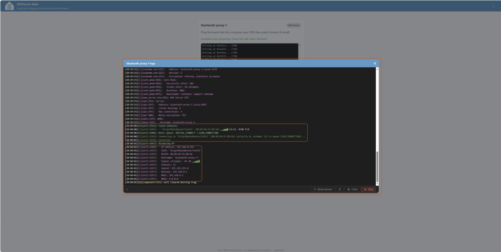

One going will say installing
Then will finish with some logs. Check here that it says connected to your Wifi successfully. It will show the connection details. Close the box
Click ‘Close this tab’
Close this block
Click the back arrow

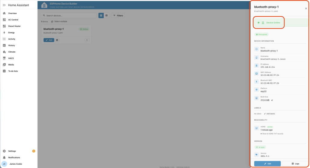

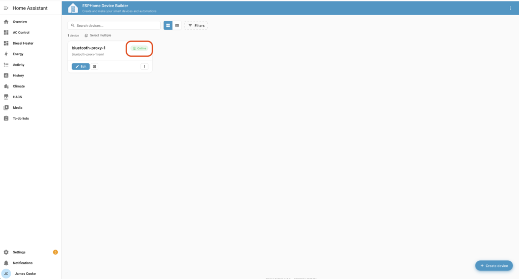

Now your device will say its online. Click on it
And you will get all of the details of your newly running ESP32 module.

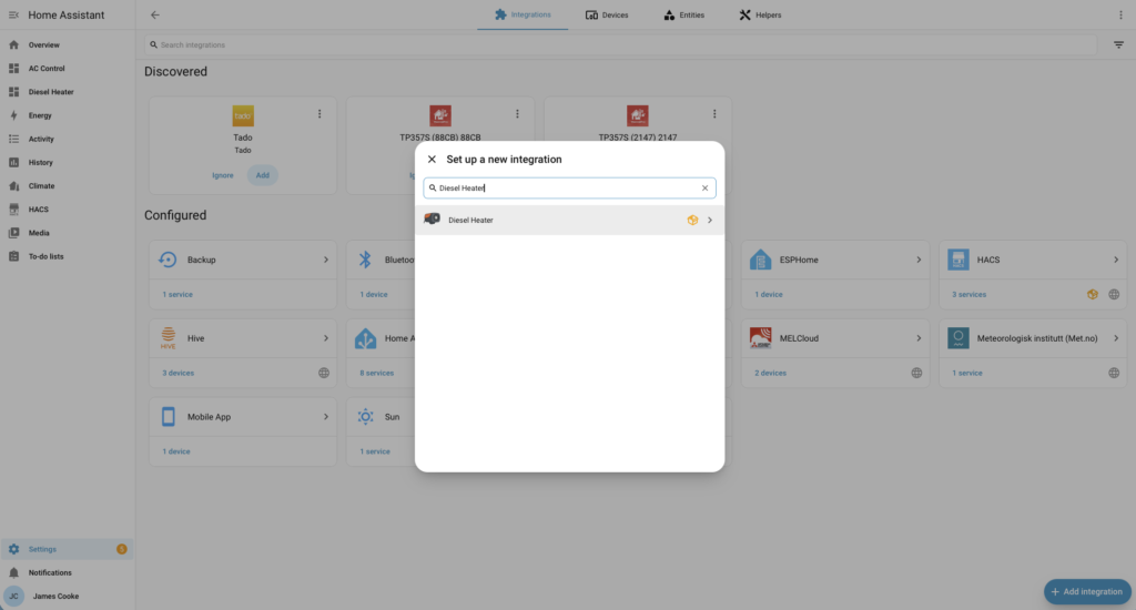

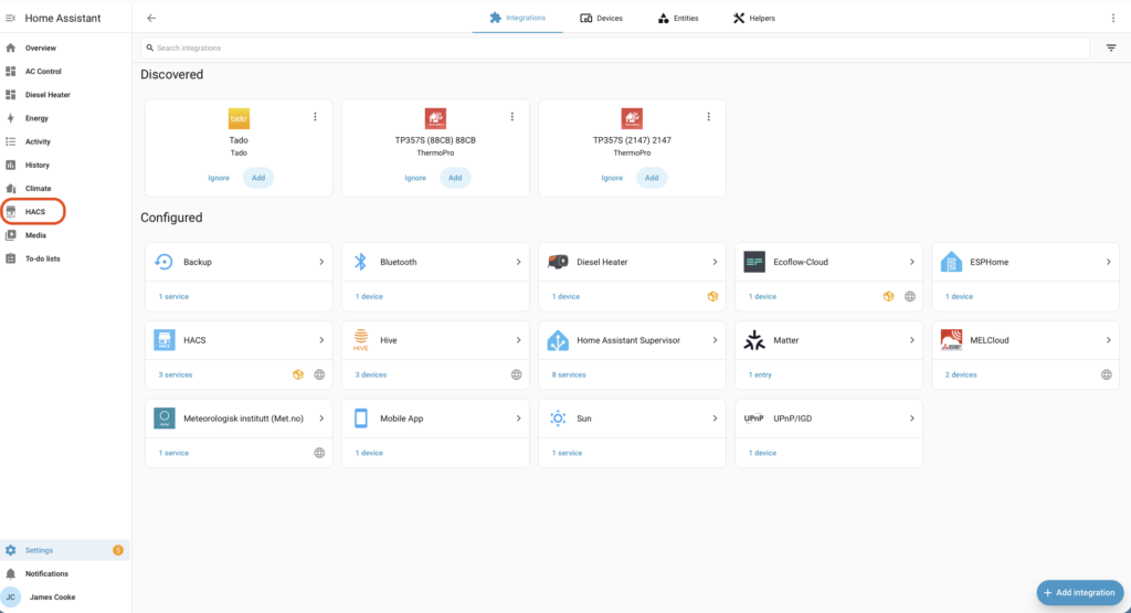

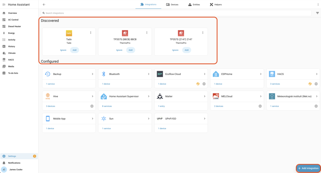

Head to ‘Settings’, ‘Devices & Services’. Under integrations, it should have discovered the ‘module – Add ‘bluetooth-proxy-1’ module as an ESPHome Device – Add it.
If for some reason it does not, click ‘Add Integration’ in the bottom right, search for “ESPHome’ and enter the IP address shown the device builder app.
Name your device and assign it an area if you wish.
Now under Integrations you will also see that ‘Bluetooth’ is configured.

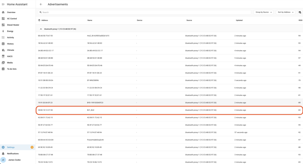

Just to check it’s working OK, head to ‘Settings’, then the newly appeared ‘Bluetooth’. Click ‘Advertisements’ and it will show any bluetooth signals that are being picked up by the unit.
In the list on mine I can spot my heater;
Congratulations, you have added bluetooth to Home Assistant with an ESP32 module!

Now let’s install HACS. Head to Settings > Apps > Install app
HACS will not be in the list – we need to add a custom repository. In the top right hand corner, clink the three dots and then Respositories
In the bottom right corner, click add. Enter ‘https://github.com/hacs/addons‘. Click Add
Head back to the add ons list. Refresh the page.
There will be a section called get HACS Add-ons Repository. In it will be ‘Get HACS’. Click it and then click install. Once installed, click start.
Once installed there will be a Logs section, click that and look for anything that says install complete. It will also say to restart Home Assistant.

Now we want to head back to the Integrations page. Click Add Integration. Search for HACS.
Click on it and then you will need to confirm a few safety warnings / disclaimers.
The next step is where we need the GitHub account.
A code will appear, we need to copy that code then open the link. Then we sign in if we are not already and enter / paste the code.
On the next page we confirm that we authorise HACS – then we can close the page and back to our Home Assistant where it will tell us a new device has been created. We can click skip and finish – no need to assign an area.
HACS is installed.
Now on the right hand side of Home Assistant you will see a tab for HACS.

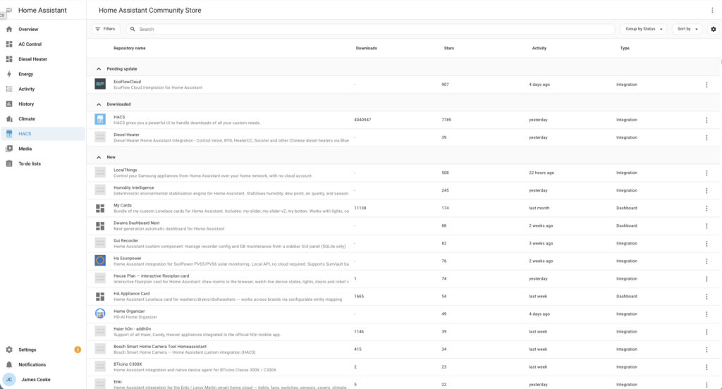

Open it and you will see a screen like below. There are hundreds of unofficial integrations that can be added from here. Choose wisely and remember they are not polished like official integrations.
Install ‘Diesel Heater’ from HACS
To install ‘Diesel Heater’ from through HACS we will need to add custom repository as it is not in the standard HACS list.
Open HACS from the left hand side and click the three dots in the top right. Select Custom repositories.
Enter: ‘https://github.com/Spettacolo83/homeassistant-diesel-heater‘. Set the category to Integration and click Add.
Search for Diesel Heater in HACS and install it.
If we head back to Settings then Integrations, it’s pretty likely that Home assistant will have discovered your diesel heater. My image below doesn’t show it but you see the idea.
Click add it.
Or if not, at the bottom right click Add integration.

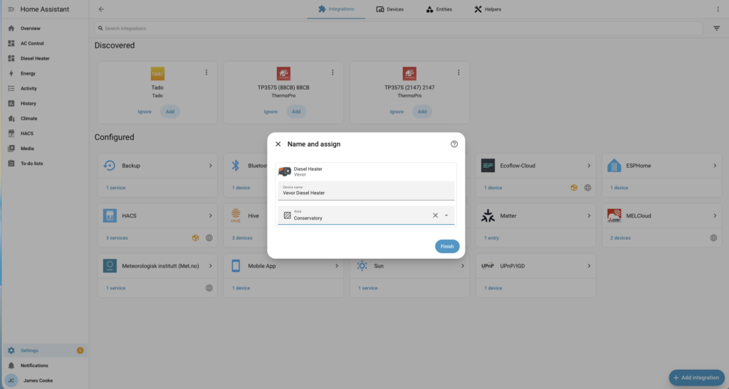

Enter the Bluetooth Address of your heater. You can find it from Settings > Bluetooth > Advertisements
The default pin and password should be OK
Name and assign the area. Click finish
99% of the time it will be auto Discovered anyway. Ensure your phone is not paired to it. You may also need to turn it on.
It will configure everything and then present you with all of the controls, sensors and associated information from it.
You can start controlling it from here. But we don’t want to navigate to the integrations page every time to control it.

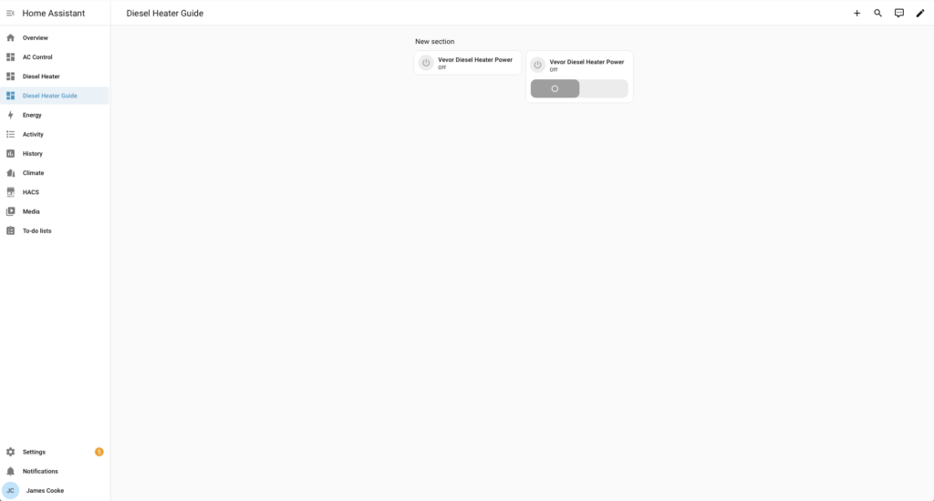

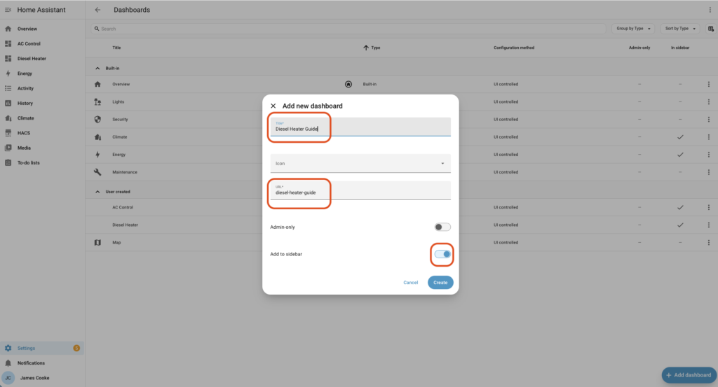

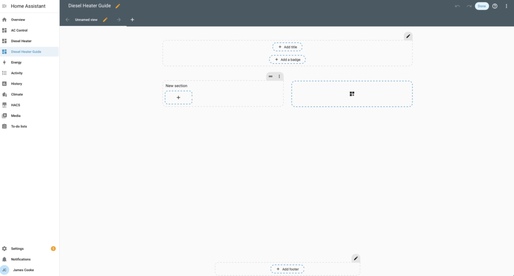

Go to settings > Dashboards > Add Dashboard. Select New Dashboard from scratch.
Enter a Title for the Dashboard – the URL will auto complete. Ensure Add to sidebar is selected.

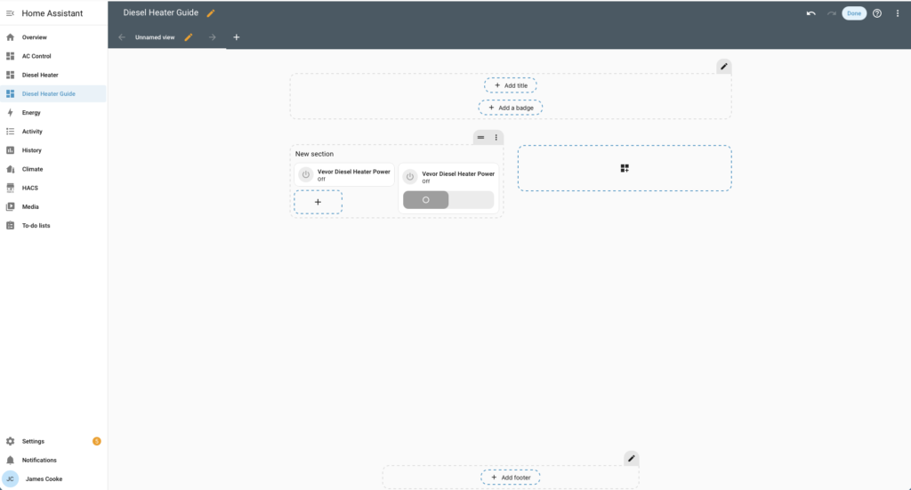

Head back to your Dashboard, it will be blank. Click the pen in the top right corner.

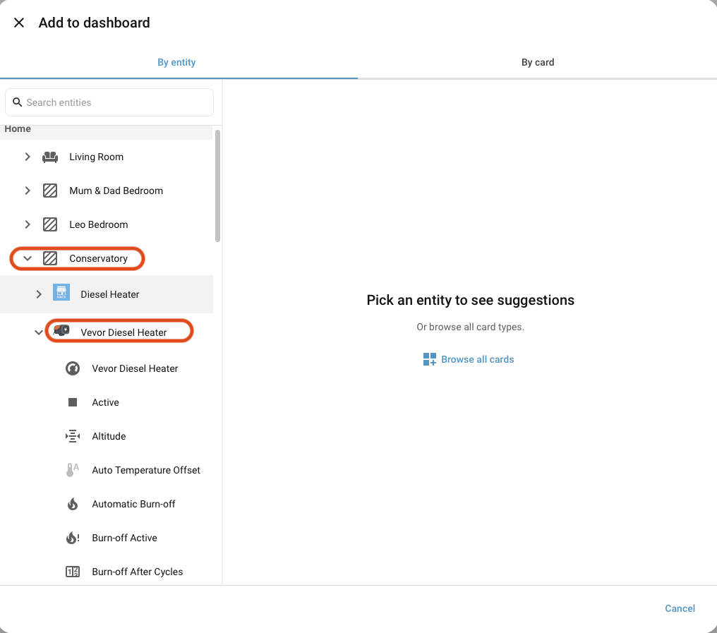

Click the + button in New section. Then navigate to the room the heater was assigned to, then the heater and find ‘Power’.
Add the Tile then also the Tile – Toggle so you can see the different type of buttons that can be made.
Then you will get this. Select done at the top right.
That’s it. We have the most basic control of our heater on a dashboard. You can interact with each button to get a feel and notice if you press one, the other changes as it is all dynamic.
This can be customised to your hearts content. Some buttons and information you add will need the buttons editing to show something more pleasing.
With a little bit of time and effort, you can have a clean useful dashboard similar too mine;
Worth noting that anything to do with fuel level is completely separate from the unit and calculated by Home Assistant. The fuel capacity needs to be set for this to estimate correctly.
Also the Scheduling in my dashboard is done via automations. Perhaps will cover that on a separate post.
