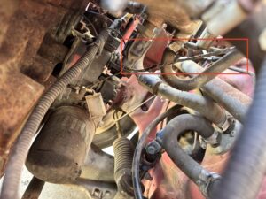

My first thought was perhaps the air filter was blocked however that turned out to be a bit blocked but nothing terrible and was replaced anyway. Next suspect was perhaps a coolant temperature sensor issue – making it think it was running cold. On this 1.1 the coolant temperature sensor is under the inlet manifold. A quick check of the temperature sensor area and I found a wiring issue as detailed below.

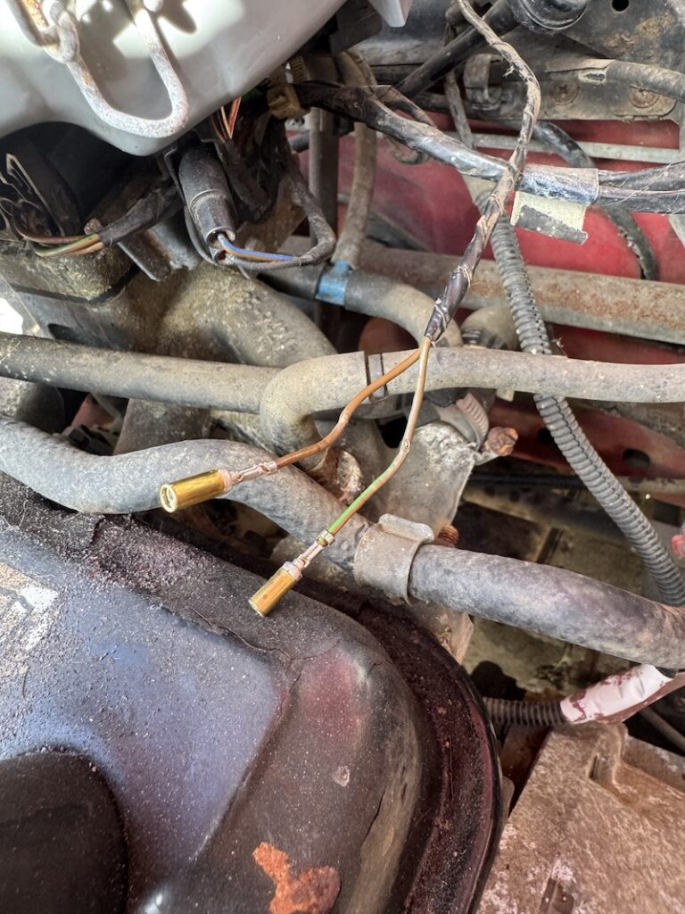

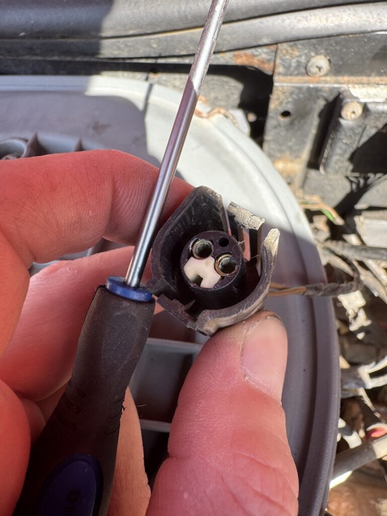

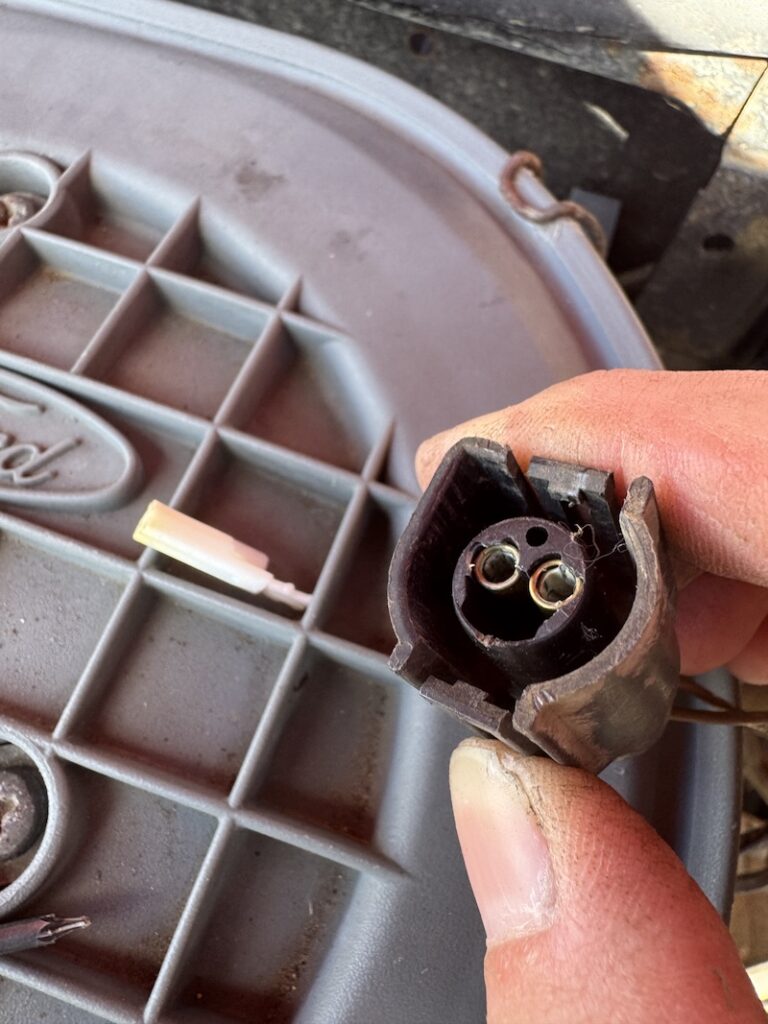

On inspection of the wiring to the coolant temperature sensor, it had been stretched / routed incorrectly.
Once the plug was removed, the damage was pretty clear and the exposed copper in each wire had been shorting to each other.
With the wires shorted together, the low resistance could make the ECU interpret the engine as being much hotter than it actually was which would affect fuelling and warm-up/catalyst strategy and so could well make it smell a bit.

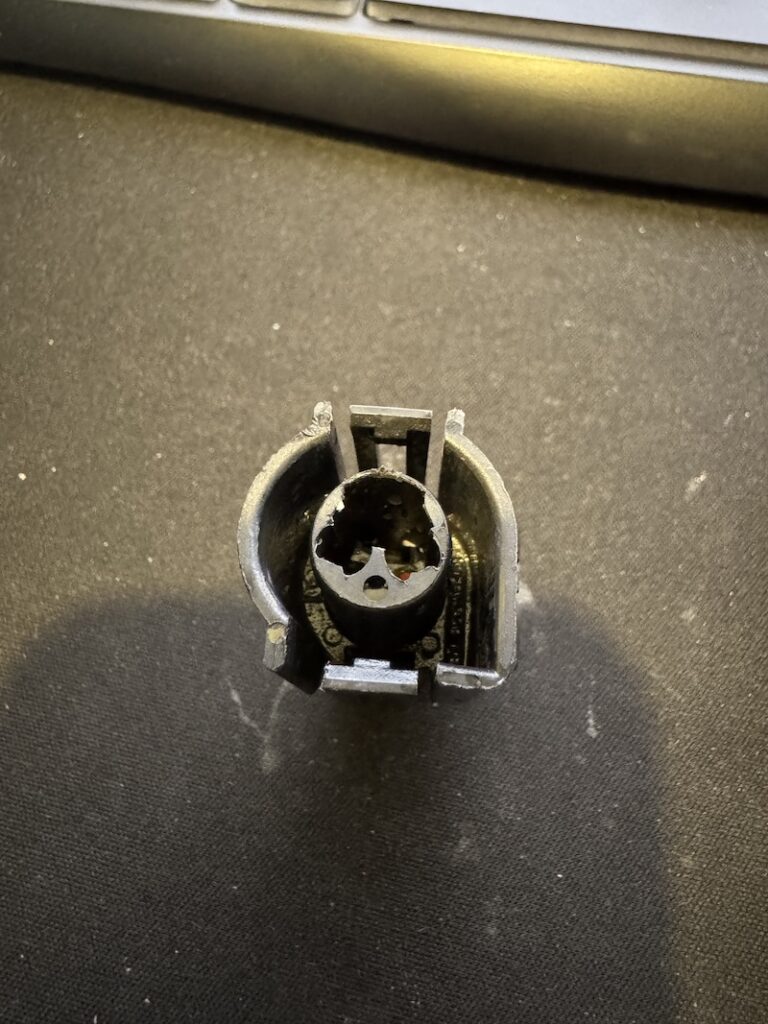

Planning to extend the wiring and re-pin, I removed the wires / pins from the connector, the white locking wedge come out OK – but the terminal locking tab inside broke off very easily – to be expected given its age.
This is where this became testing – trying to get the connector proved not so straight forward.
Inside the connector housing the Ford engineering part number is listed; 89FG-14A464-FBA
After lots of searching I come to the conclusion that it’s probably a TE or Delphi connector. I managed to find various other listings for 14A464 but nothing with the ‘FBA‘.
In particular, the other ‘hand’ seems to be very common and also used Fiesta’ / Escorts’ from this era on the air temp and fan connector.
I almost resorted to updating the sensor and plug to the later style used on Mk4/5 Fiestas / Focus / Mondeo etc but was concerned that resistances may be slightly different as they all use EEC-V over EEC-IV ECUs.

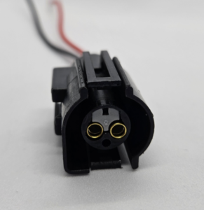

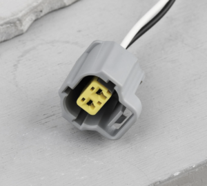

Last resort was Automotive Connector Identification – Facebook Group – great success;

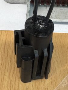

Either from Shop BHP or eBay; Listed as for Granada Cosworth. Number listed against it as ‘LX40’
The wire seals were a little to big for the wiring but I sealed it up with a little silicone for good measure;
I lacked the ability to take images of the final repair in situ and generally the engine seems to run a bit smoother.

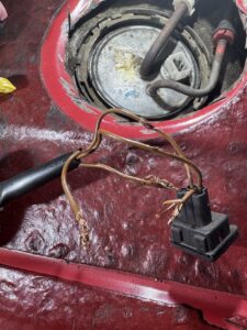

Fuel Pump Module Wiring / Repair

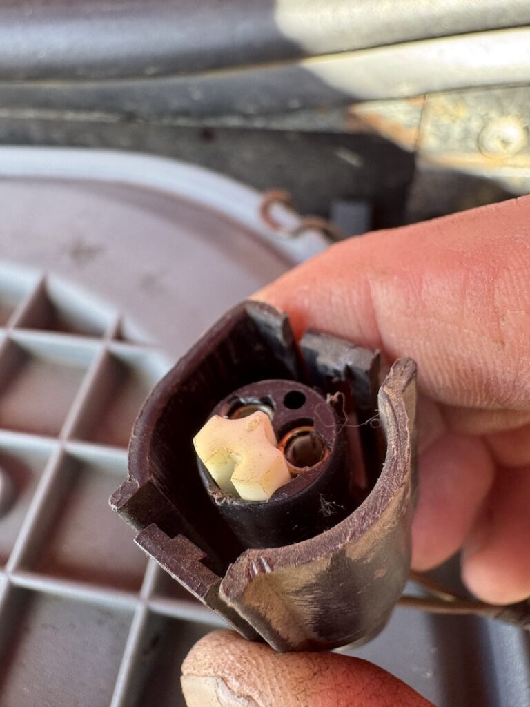

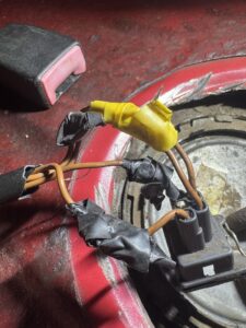

Here’s the top quality repair I found whilst doing the seats;

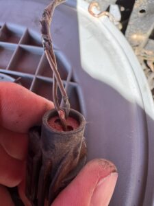

I admire your creativity but come on now! Two wires twisted together and two with exposed copper.

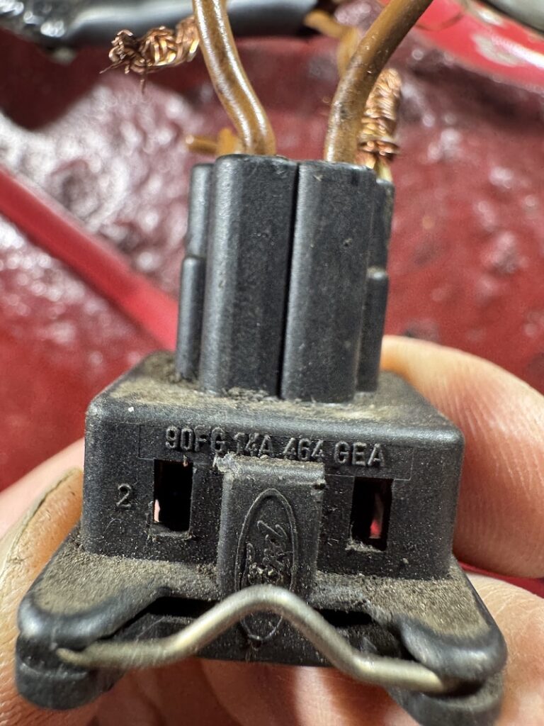

Initially I was going to remove the terminals from the housing, cut the wires back, extend and re-terminate. However on removal of the blue locking tab then releasing the pins from the housing, the tabs broke in the housing.

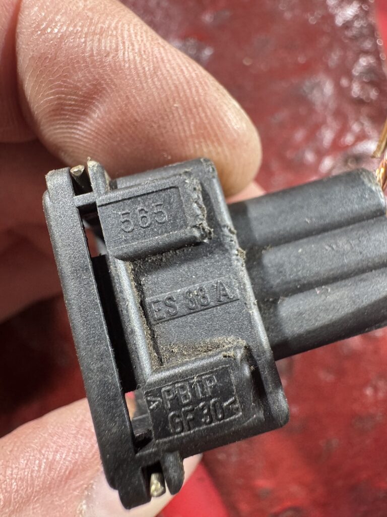

The Plug part number is 90FG-14A464-GEA. The Ford mould markings include ES88A and 565. It’s a Ford-specified connector housing, rather than a conventional aftermarket connector part number.
It appears to be from the JPT/TE-AMP family of connector systems, although I couldn’t find anything to back this up.
This connector does all of the Fiesta Mk3 fuel pump modules. Probably some escorts too.

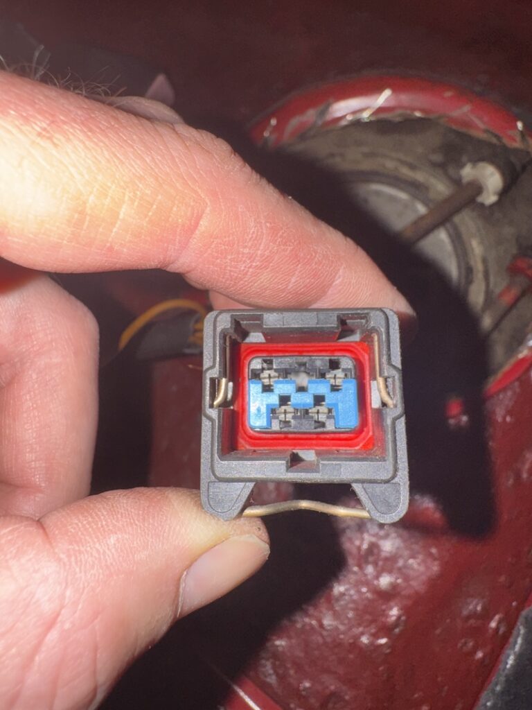

I did manage to find one on ebay again;
In my haste I once again failed to take pictures of the finished wiring repair. The fuel level gauge is working correctly now!
Lastly, I used some duck tape to seal up the opening that has been hacked into the floor. Not ideal by any stretch, maybe one day will repair properly – certainly a job for another day. Its better than the underside of the seat foam being essentially outside

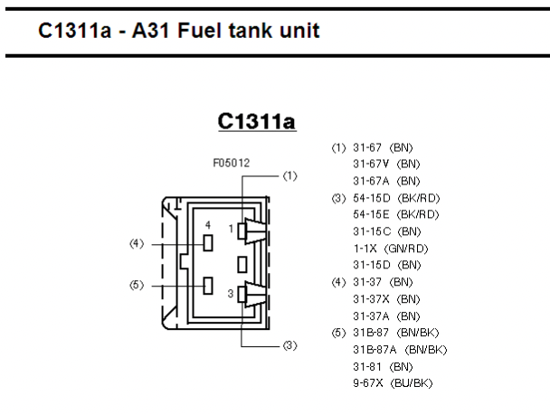

Info – Fuel pump module wiring / pin out
On later vehicles, all the wires are brown for security purposes. Thankfully I was able to extend the wire, terminate and pin the housing wire by wire.
If you’re working with no plug, then Ford wiring diagrams are not the best for this but I could make out the following for the pins;
Pin 1 – Ground for fuel pump
Pin 2 – Not used
Pin 3 – 12v to fuel pump (If PATS fitted, goes to PATs box) (if no PATS probably fuel pump relay) (all via inertia cut off switch where fitted)
Pin 4 – Ground for level sensor
Pin 5 – From instrument cluster / fuel gauge (goes to pin 4 on instrument cluster)
