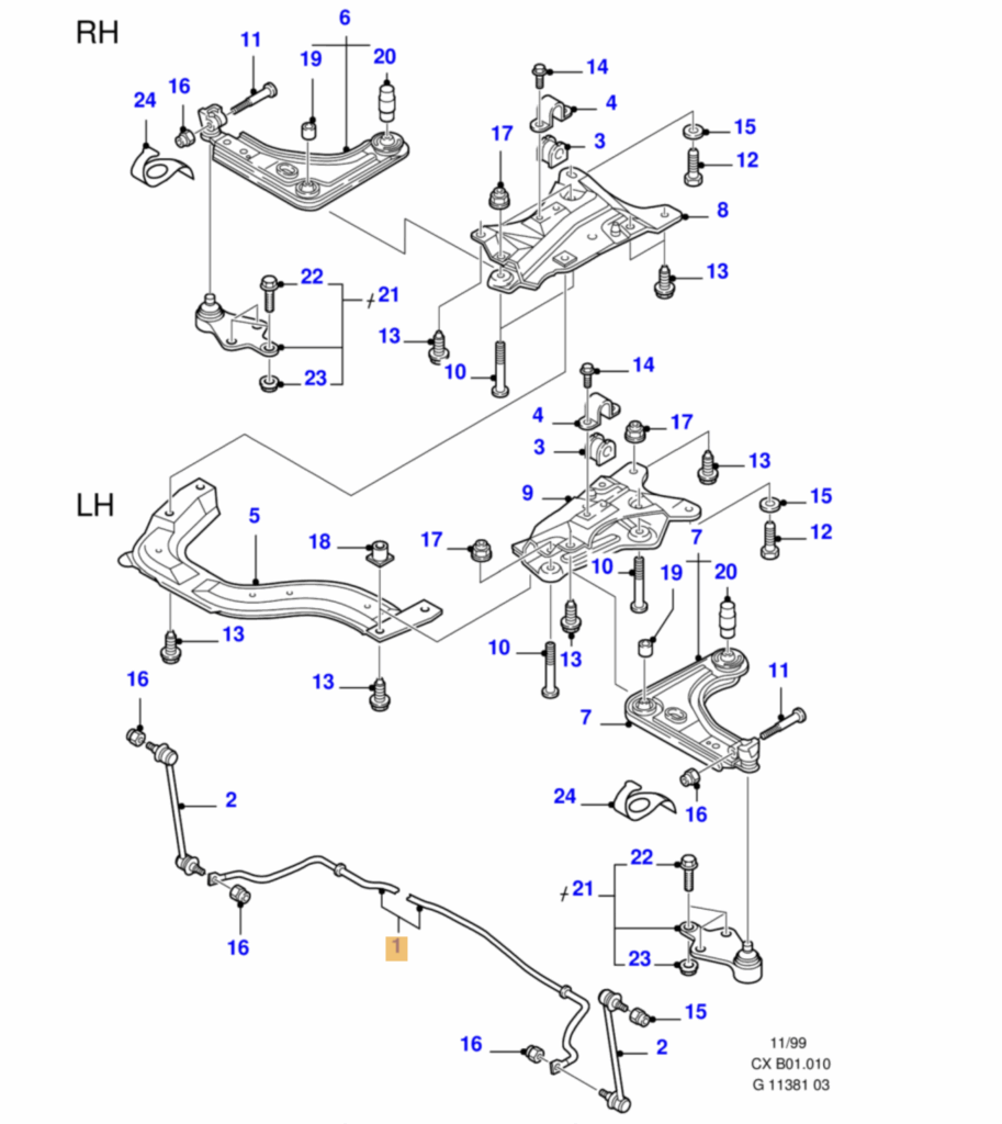

Suspension
Wishbone Carriers / S Brace / Anti Roll Bar
1 – Anti Roll Bar – 1661190 – 12mm Version (possibly RHD only)
6868842 – 16mm Version
6937024 – 12mm Version (possibly LHD only)
in most cases, XR / RS or Zetec-E variants get the 16mm version, not fitted to some base models at all
16mm version seems to cover LHD or RHD
2 – Anti roll bar link – 1130273 – Ball joint threads are M10x1.5 – Length of rod is 238mm
– Apec AST4023
– Blueprint – ADM58506
– Borg & Beck – BDL6368
– Delphi – TC720
– Febi – 07989
– Lemforder – 18048 02
– Meyle – 716 060 0040 (/HD)
– MOOG – FD-LS0090 (Steel) FD-LS0950 (alluminium)
– QH – QLS3075S
– SKF – VKDS 344006
– TRW – JTS405
3 – Antiroll bar bush – 1145272 – 16mm bar variant – Mounting time noted as 1/1/94 to 8/31/96
1652936 – 12mm bar variant – Mounting time noted as 1/1/94 to 8/31/96
6185809 – 16mm bar variant – Mounting time noted as 1/1/89 to 1/31/94
I don’t know what the difference is meant to be between the two 16mm variants. On cross reference to OE, seem to come to the same number.
4 – Anti roll bar bush clamp
6169163 – 12mm version
1495282 – 16mm version
5 – S Brace 7078054
6 – RH wishbone – See wishbones
7 – LH wishbone – See wishbones
8 – Right Carrier     1042313
9 – Left Carrier       1042319
10 – Wishbone to carrier bolt x2 (each side) 1479651 M12x72
– Febi 24381 – Length: 86 mm, Thread Length: 34 mm, Quality Grade: 8.8, Spanner size: 15, Shaft Length: 41 mm
– Also see aftermarket kits listed below
11 – Wishbone ball joint stretch bolt 6080625  M10x51 (note normally T50 head)
– Febi 24391 – Screw length below head: 50 mm
– Febi 24395 (pair) – External Thread Size: M10 x 1,5, Screw length below head: 50 mm,
– MEHA MH90056
– STELLOX 79-09003-SX
– SWAG 50 92 4391
– QH QSK226S (with nut)
– Monroe L16860
– Delphi TD602W
– Meyle 7166540002
– First Line FSK6537
– Borg & Beck BSK6537
12 – Bolt for carrier x1 (each side) 6577074.   M14x37 (one flat washer on this one)
13 – Bolt for carrier x3 (each side) 7110255    M12x42
14 – Antiroll bar bush clamp bolt 6179008 M8x25 hex head flanged
15 – Washer 6180741 (15.1x28x4.0mm)
16 – Wishbone ball joint stretch bolt nut 1505594  M10 self locking
17 – Wishbone to carrier bolt nut x2 (each side) 6797866 M12 flanged
18 – Nut (special) 1475985 M12
19 – Wishbone front bush – 1829508
20 – Wishbone rear bush 1035929
21 – Ball joint – these are riveted to the wishbone from factory but can be ground off and replaced with bolts. Not really worth it as might as well replace the whole wishbone.
21 – 104779701.01.94-08.31.96With 3 Rivet fixing
21 – 104779801.01.89-01.31.94With PAS, Version Not Xr2With 3 Rivet fixing
21 – 104785201.01.89-01.31.94Version XR2With 3 Rivet fixing
21 – 167939201.01.89-01.31.94No PASWith 2 Rivet fixing
22 – Ball joint bolt 1479052 (from factory is riveted)
23 – Ball joint nut 1471967 (from factory is riveted)
24 – Cover 1205289 – normally get removed and not put back on!
Bolt kits aftermarket – for wishbones
Wishbone mounting kit inc carrier to wishbone nuts/bolts and ball joint pinch nut/bolt
– QH QSK261S
– Febi 24393
Wishbone to carrier bolts/nuts
– Delphi TD603W
Ball joint bolt kit
FAG 828 0003 30
Wishbones
Deserves its own section. A few different types here, from what I’ve worked out over the years + catalogue notes is below.
They all look the bloody same however the differences are to do with the ball joint pin size and the angle of the ball joint mainly. If the angle is wrong can affect steering feel, tyre wear etc.
Just to make it more confusing, some Ford references in aftermarket are the same part & then sometimes not depending on the manufacture.
The whole 2 or 3 bolt situation is further confusing as in after market it depends on manufacture again.
If you had a genuine one of each then you could compare I suppose, but in reality can’t see that happening!
Have listed QH & first line references as they are generally pretty solid in the cross referencing world.
Have not been able to find any other technical information on this other than from parts lookups / experience – if you have anything, feel free to pass it on.
SideFinisMounting Dates (not always specified)ApplicabilityJam Application NotesBall joint pin notesQH ReferenceFirst Line Reference
EARLY ‘Mk 3’EARLY ‘Mk 3’EARLY ‘Mk 3’EARLY ‘Mk 3’EARLY ‘Mk 3’EARLY ‘Mk 3’EARLY ‘Mk 3’EARLY ‘Mk 3’
RH1054984CVH & Less PAS & Version XR2
or
CVH Turbo & Less PAS
RS Turbo
or
Xr2i 1.6 CVH
No PAS
17mm Pin QSA1650S
(3 bolt or rivets)
FCA5667
(3 bolt or rivets)
LH1054985CVH & Less PAS & Version XR2 & Production date > 10.1.90 & Production date < 3.31.92
or
CVH Turbo & Less PAS & Version RS Turbo & Production date > 4.1.90 & Production date < 8.31.96
RS Turbo
or
Xr2i 1.6 CVH
No PAS
17mm Pin QSA1651S
(3 bolt or rivets)
FCA5666
(3 bolt or rivets)
RH10549863.1.92 – 1.31.941.8 Zetec-E & No PAS & Version S/XR2iXr2i Zetec
Or
RS1800
No PAS
17mm Pin QSA1473S
(3 bolt or rivets)
FCA5722
(3 bolt or rivets)
LH10549873.1.92 – 1.31.941.8 Zetec-E & No PAS & Version S/XR2iXr2i Zetec
Or
RS1800
No PAS
17mm Pin QSA1474S
(3 bolt or rivets)
FCA5721
(3 bolt or rivets)
RH1111411 CVH 1.6 & No PAS & Version XR2 & Production date > 4.1.89 & Production date < 10.31.90
or
Less PAS & Version Sub C/C/CL/CLX/S/Ghia & Production date >1.1.89 & Production date < 1.31.94
or
Courier / Kombi
Very early Xr2i
or
basic model up to around end of 94
No PAS
17mm Pin QSA1473S
(3 bolt or rivets)
Above replaces
QSA1149S
(2 Bolt or rivets)
QSA1431S
(2 Bolt or rivets)
FCA5614
(2 Bolt or rivets)
or
FCA5717
(3 bolt or rivets)
LH1111413CVH 1.6 & No PAS & Version XR2 & Production date > 4.1.89 & Production date < 10.31.90
or
or
Courier / Kombi
Very early Xr2i
or
No PAS
17mm Pin QSA1474S
(3 bolt or rivets)
Above replaces
QSA1150S
(2 Bolt or rivets)
QSA1432S
(2 Bolt or rivets)
FCA5613
(2 Bolt or rivets)
or
FCA5716
(3 bolt or rivets)
Late Mk ‘3.5’Late Mk ‘3.5’Late Mk ‘3.5’Late Mk ‘3.5’Late Mk ‘3.5’Late Mk ‘3.5’Late Mk ‘3.5’Late Mk ‘3.5’
RH71522691.1.94 – 10.31.95 Less PAS18mm QSA1428S
(3 bolt or rivets)
FCA5712
(3 bolt or rivets)
LH71522711.1.94 – 10.31.95Less PAS18mm QSA1429S
(3 bolt or rivets)
FCA5711
(3 bolt or rivets)
RH71522701.1.94 – 10.31.95With PAS
or
Courier / Kombi
18mm QSA1471S
(3 bolt or rivets)
FCA5647
(3 bolt or rivets)
LH71522721.1.94 – 10.31.95With PAS
or
Courier / Kombi
18mm
3 bolt or rivets
QSA1471SFCA5646
RH107033710.01.95 – 08.31.96Less PAS18mm QSA1428S
(3 bolt or rivets)
FCA5712
(3 bolt or rivets)
LH107033810.01.95 – 08.31.96Less PAS18mm QSA1429S
(3 bolt or rivets)
FCA5711
(3 bolt or rivets)
RH111141010.01.95 – 08.31.96Courier / KombiAssuming all these last lot of Couriers had PAS as same aftermarket refs first lot of mk3.5s with PAS18mm QSA1471S
or
QSA1900S
(was QSA1537S)
(3 bolt or rivets)
FCA5647
or
FCA6001
(3 bolt or rivets)
LH111141210.01.95 – 08.31.96Courier / KombiAssuming all these last lot of Couriers had PAS as same aftermarket refs first lot of mk3.5s with PAS18mm QSA1472S
or
QSA1899S
(was QSA1536S)
(3 bolt or rivets)
FCA5646
or
FCA6000
(3 bolt or rivets)

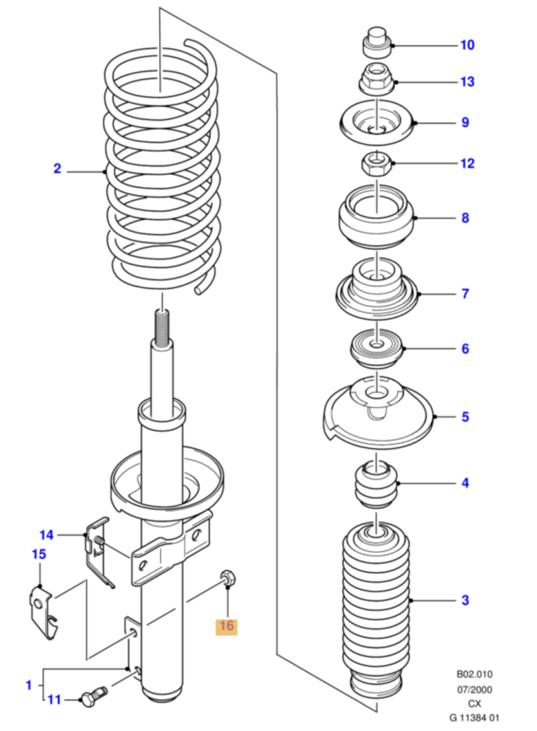

Front Springs / Shock Absorbers
Main difference here is that early ones have ‘thinner’ shock absorbers where it goes into the wheel bearing hub / carrier. You can use the early ones on later ones if you make up some form of shim.
Some models don’t have an anti roll bar and therefore have the shocks have no bracket for the antiroll bar to attach.
1
2
3 – Boot 1654205
4 – Bump stop
6167869 01.01.89-01.31.94
6532212 01.01.94-08.31.96 or CVH Turbo
5 – Spring seat 6836914
6 – Top mount bearing 6150276
7 – Cap 6150341
8 – Top suspension strut mounting 6150277
9 – Retaining plate 6110212
10 – Nut cover 6134302
11 – Bolt 1473444 M12x45 Hex head
12 – Nut 6150483 M12x1.25
13 – Nut 1381995 M12x1.25 Self locking nyloc
14 – Bracket, hose support, only if with antiroll bar
6638964 LH
6638965 RH
15 – Bracket 1661447 (with no antiroll bar???)
16 – Nut 4649493 – Head head M6
