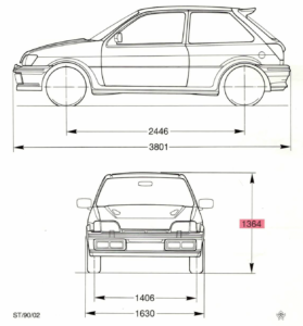

Vehicle Dimensions
Vehicle Data
Weight (kg)
– Unladen weight 930
– Permissible total weight 1350
– Permissible axle load – front 750
– rear 650

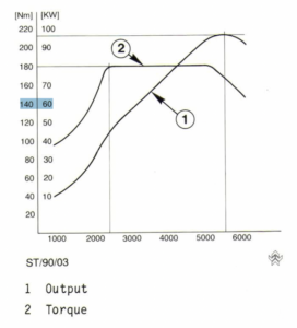

Output
– 96 kW (130 HP) at 5500 rpm
Torque
– 180 Nm at 2400 rpm

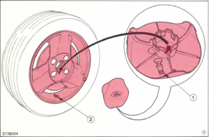

Wheels / Tyres
Unique aluminium rims, size 14 x 5 1/2 J
Note: Install wheel caps in the correct position. Align mark on rear of cap with the valve (see fig.)
New tyres, size 185/55 R 14 78V, with same tyre pressure as XR2i.

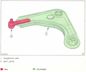

Suspension Arm
The ball joints (2, see fig.) of the suspension arms (1) have been offset by 10 mm to the outside and rear.

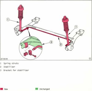

Rear Axle / Suspension
The multiple link axle has been adapted from the Fiesta XR2i, but with the following modifications:
In the no-load setting, the unique spring struts (1, see fig.) for Fiesta RS Turbo are 25 mm shorter with revised damping rate.
Additional stabilizer (2) for improved vehicle handling.
Two brackets (3) for stabilizer welded to rear axle.

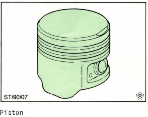

Pistons
Carryover Escort RS Turbo pistons (see fig.) with flat piston crown.

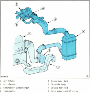

New Intake Duct
Additional intercooler (4, see fig.) between compressor-turbocharger (3) and cross over duct.
New aluminium cross over duct (5) mounted on rocker cover.
Idle speed control valve (8) allows intake air to flow from the air chamber directly to the intake manifold (7) at idle speed.

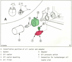

Lubrication Circuit
The lubrication oil circuit has been extended in order to supply the turbocharger.
The oil pressure switch (6, see fig.) is now mounted on an adapter (5), which also connects the oil supply pipe to the turbocharger.
An oil cooler (2) is additionally installed between the crankcase and oil filter ( 4).
Tightening torques:
– Oil cooler mounting 55 – 60 Nm
– Adapter 15 – 41 Nm
– Oil pressure switch 25 – 29 Nm

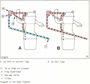

Positive Crankcase Ventilation
The direction of flow of crankcase fumes depends on the load status of the engine.
In the idle or partial load range, the crankcase fumes flow from the sump via the crankcase and the rocker cover to the filter (A, see fig.). Here, fresh air is added from the air cleaner and the fumes flow back to the crankcase-rocker cover connection point.
In the full load range, the fumes flow from the filter to the air cleaner and are then made available for combustion.

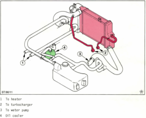

Cooling System
The cooling system has been adapted from the XR2i, however;
New radiator and fan
Additional cooling facilities for turbocharger
Oil cooler as Escort RS Turbo

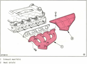

Exhaust Manifold
New exhaust manifold (1, see fig.) made of ni-resistant cast iron, providing improved corrosion resistance.
New heat shield (2) to protect hoses and wiring from the heat of the exhaust manifold.

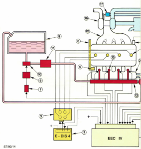

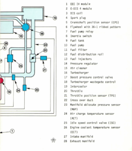

Engine Management
The engine management system is based on that of the XR2i, however, modifications have been necessary due to the use of a turbocharger.
Modfiications:

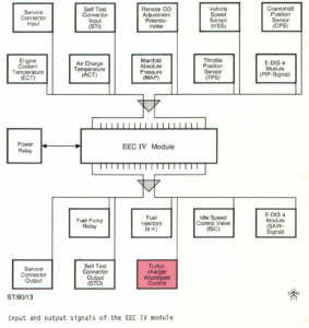

– Additional boost pressure control valve and turbocharger wastegate control
The engine management consists of the EEC IV module, the electronic fuel injection system EFI and eleectronic distributorless ignition system E-DIS 4. A Garrett T2 exhaust turbocharger is additionally used to increase output.
Turbocharger System
The Fiesta RS Turbo is equipped with a new Garrett T2 turbocharger.
The EEC IV module controls the charge pressure by way of the boost pressure control valve and the turbocharger wastegate control.
The turbocharger system is additionally equipped with an intercooler.

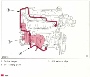

Turbocharger Oil Supply
The oil supply for the turbocharger (1, see fig.) is taken via the oil supply pipe (2) from the adapter next to the oil cooler on the crankcase to the turbocharger.
The oil return pipe (3) leads from the turbocharger via the crankcase to the sump.

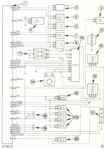

Wiring Diagram
Worth noting that there is an early type and late type here and I don’t know which one the below exactly refers to.
From the info I have searched, there is an ECU ‘OFAB’ that is the early type & ‘OFAC’ that is the later type.
The ‘OFAC’ has a digital MAP sensor. The plugs are different and the pinout at the ECU may be different.
This info is sourced from a 1990 document, so would imagine is the early type.

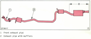

Exhaust System
Due to the use of a turbocharger, it has been necessary to modify the front exhaust pipe. The exhaust system is similar to XR2i but has larger pipe diameter and revised mufflers.
Modification;
New front exhaust pipe
NOTE: A single-piece exhaust system is used in production. If only the rear muffler is to be changed during service operations, the exhaust system must be parted at dimension X=756 mm.

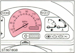

Instrument Panel
New 150 mph speedometer

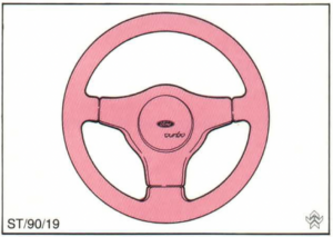

Sports Steering Wheel
Unique 3-spoke sports steering wheel (0 360 mm) with ‘turbo’ badge

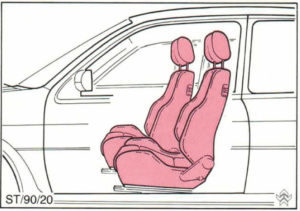

Seats
Recaro seats with unique seat covers.
Seat lock at front right for both rails.

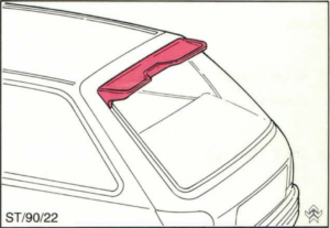

Rear Spoiler
Larger rear spoiler (see fig.) painted to match car colour.

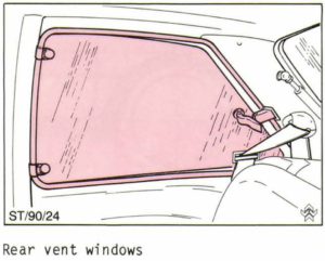

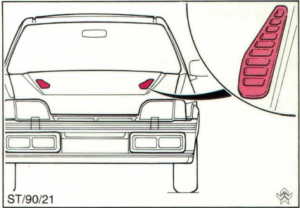

Rear Windows
The rear windows are designed as vents (see fig.)

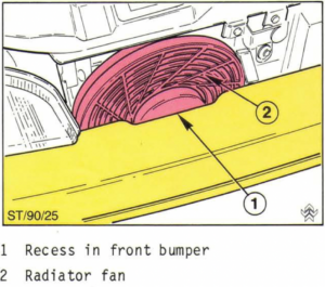

Bumper
The front bumper is recessed (1, see fig.) to accommodate the new radiator fan (2).
