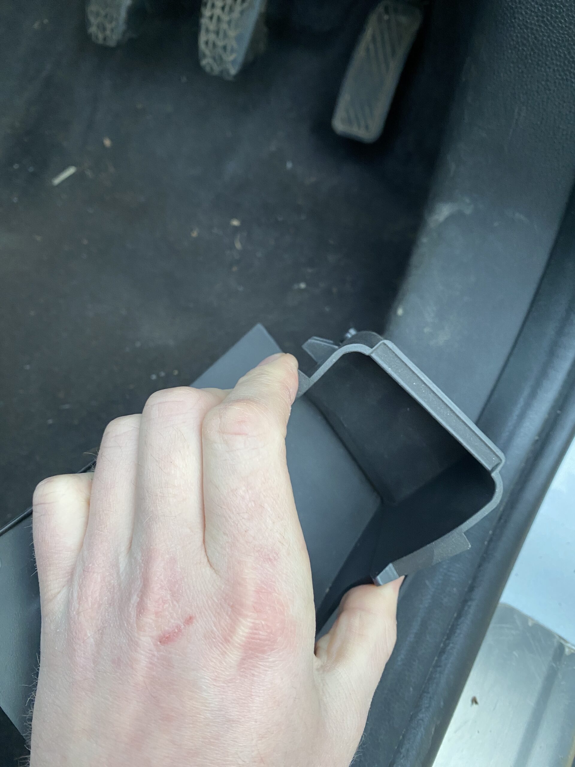

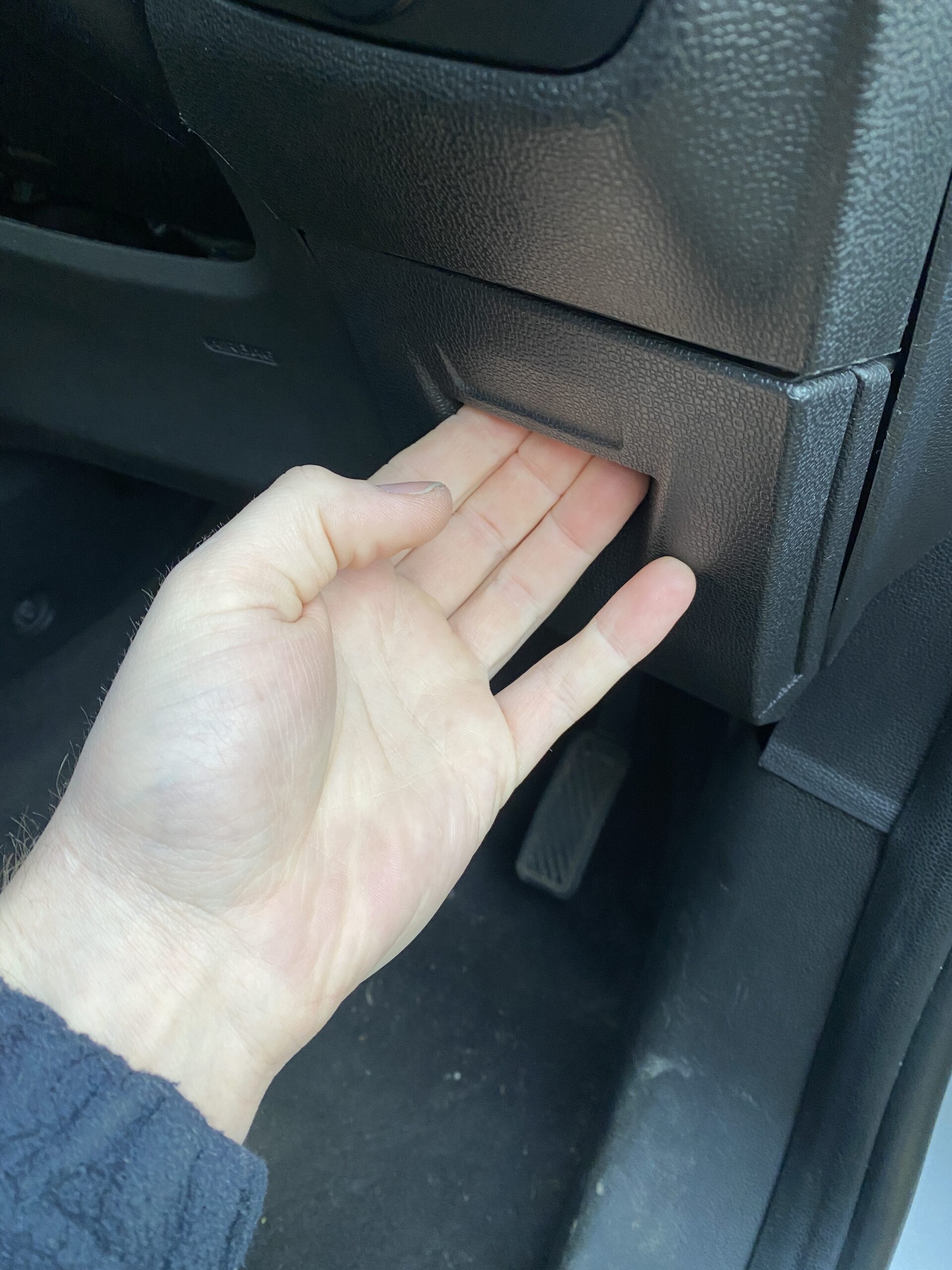

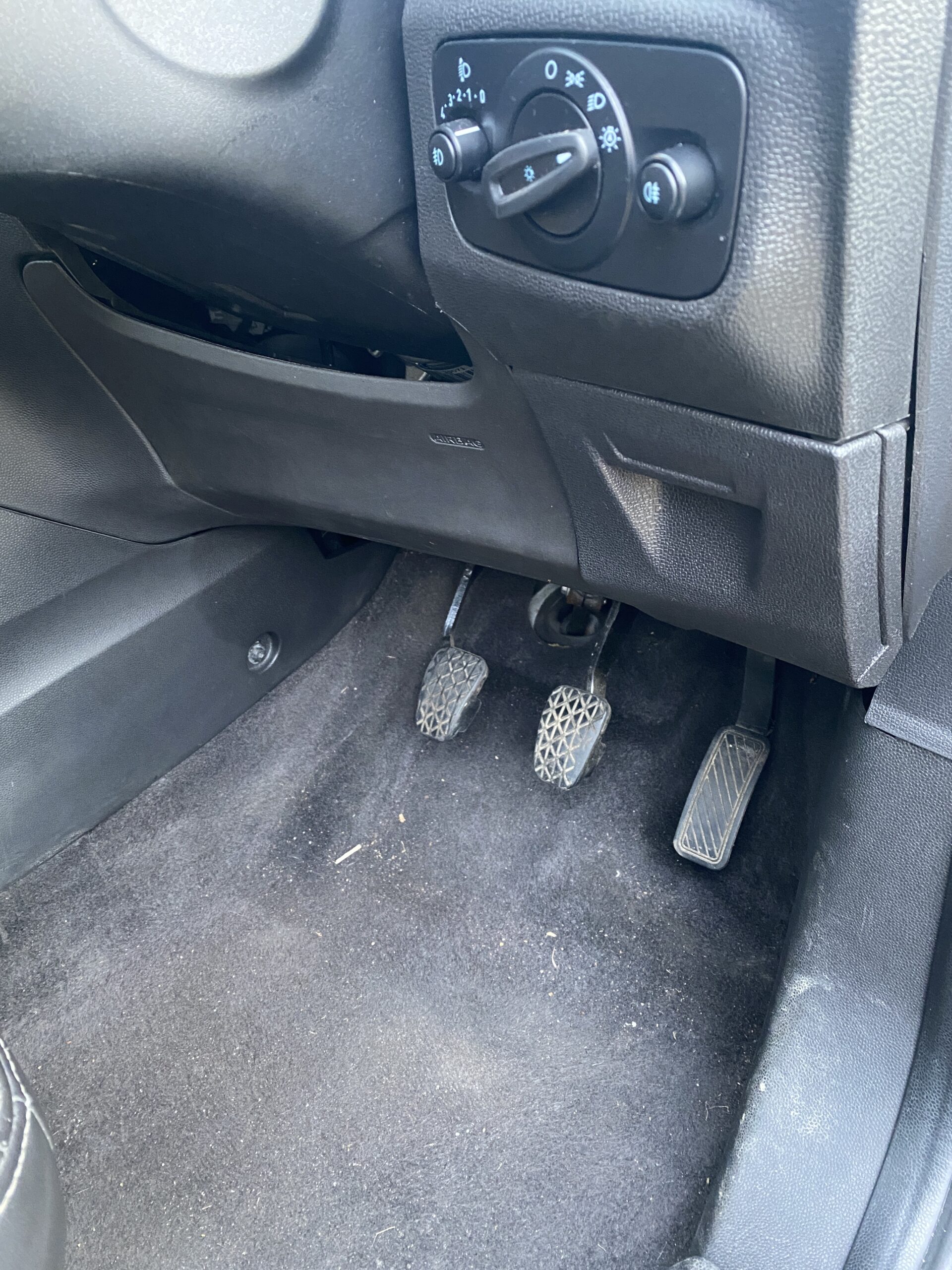

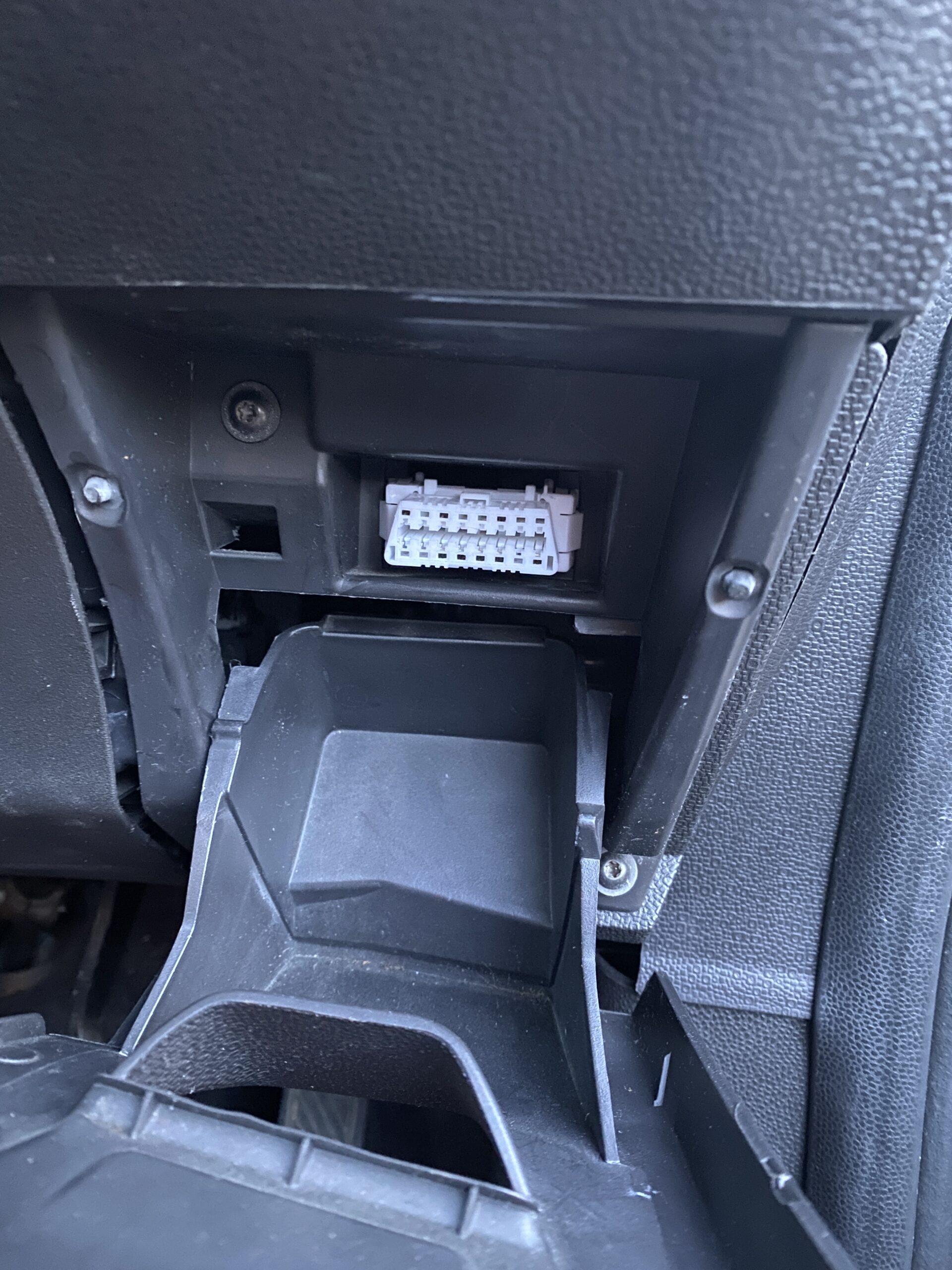

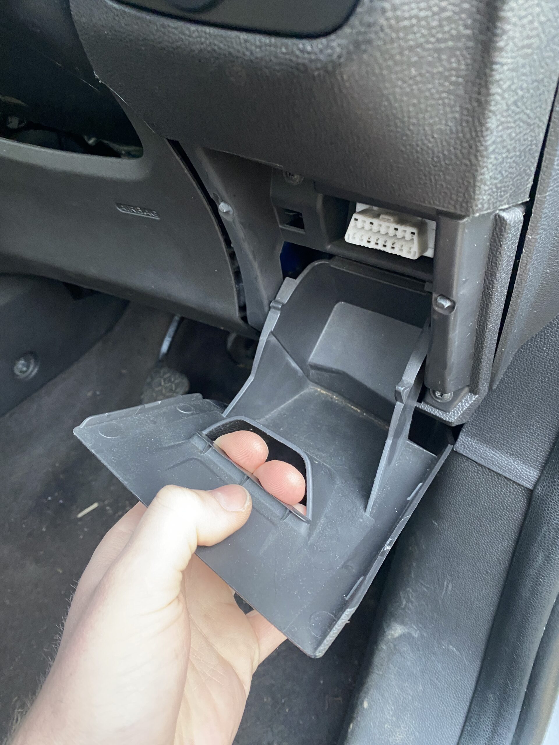

First step is to remove the OBD plug from the dashboard. Under the exterior light switch pack, there is a small compartment. Open it, and then squeeze the compartment to allow you to pull it out of its hinges.

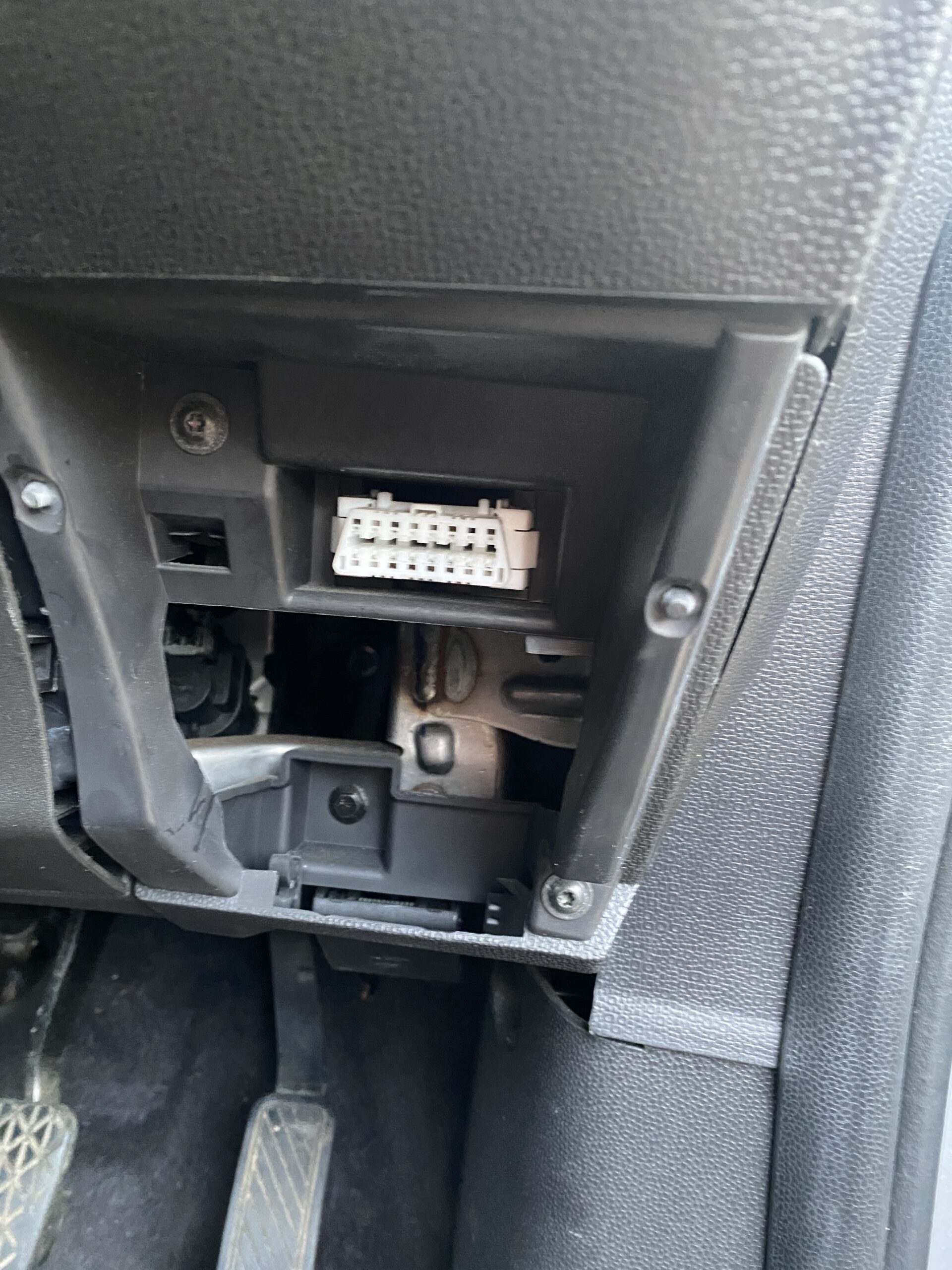

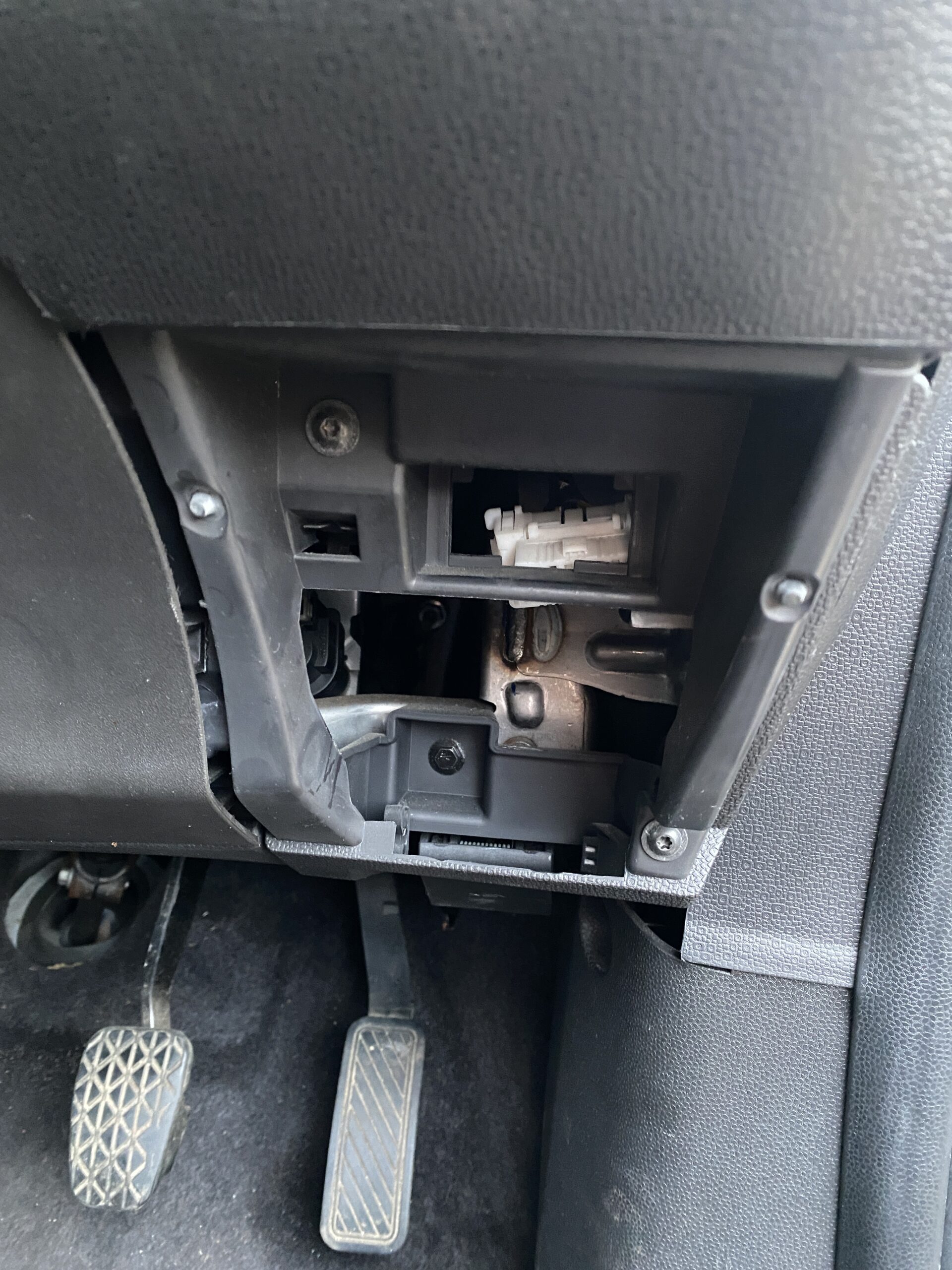

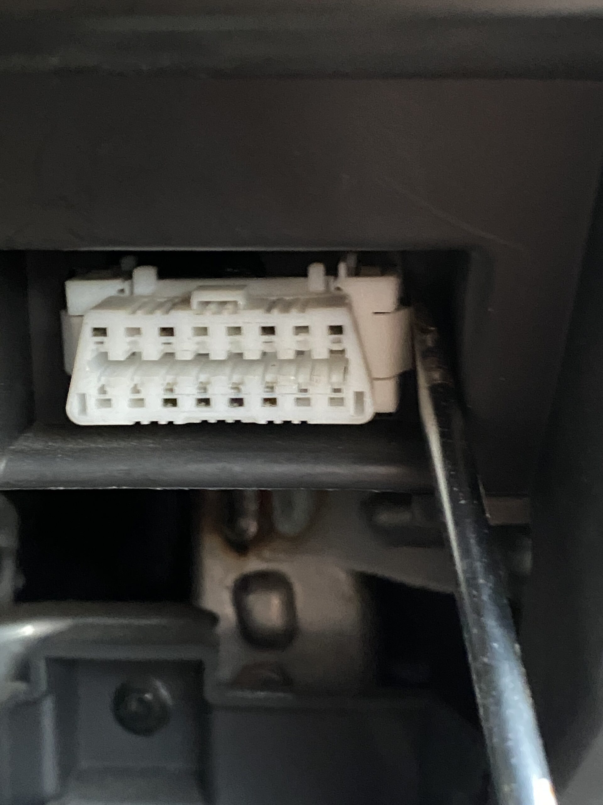

Next remove the plug from the dashboard. Use a flat blade screwdriver to push the tab on on the side of the plug to release it and push it through.

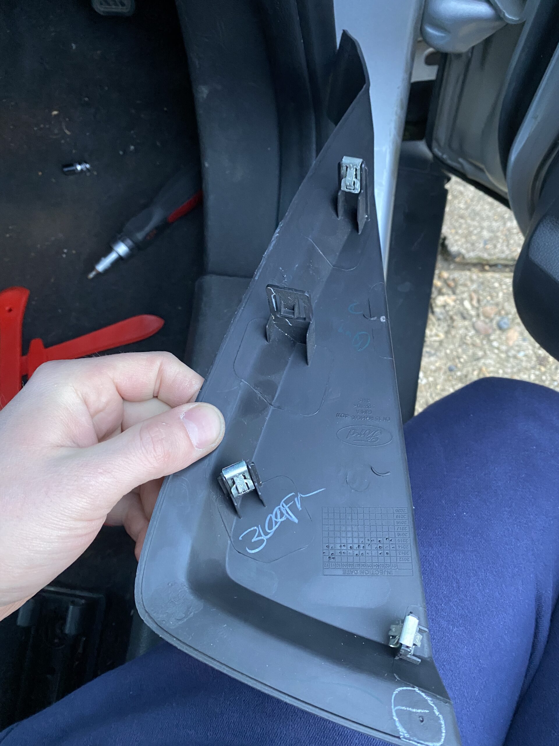

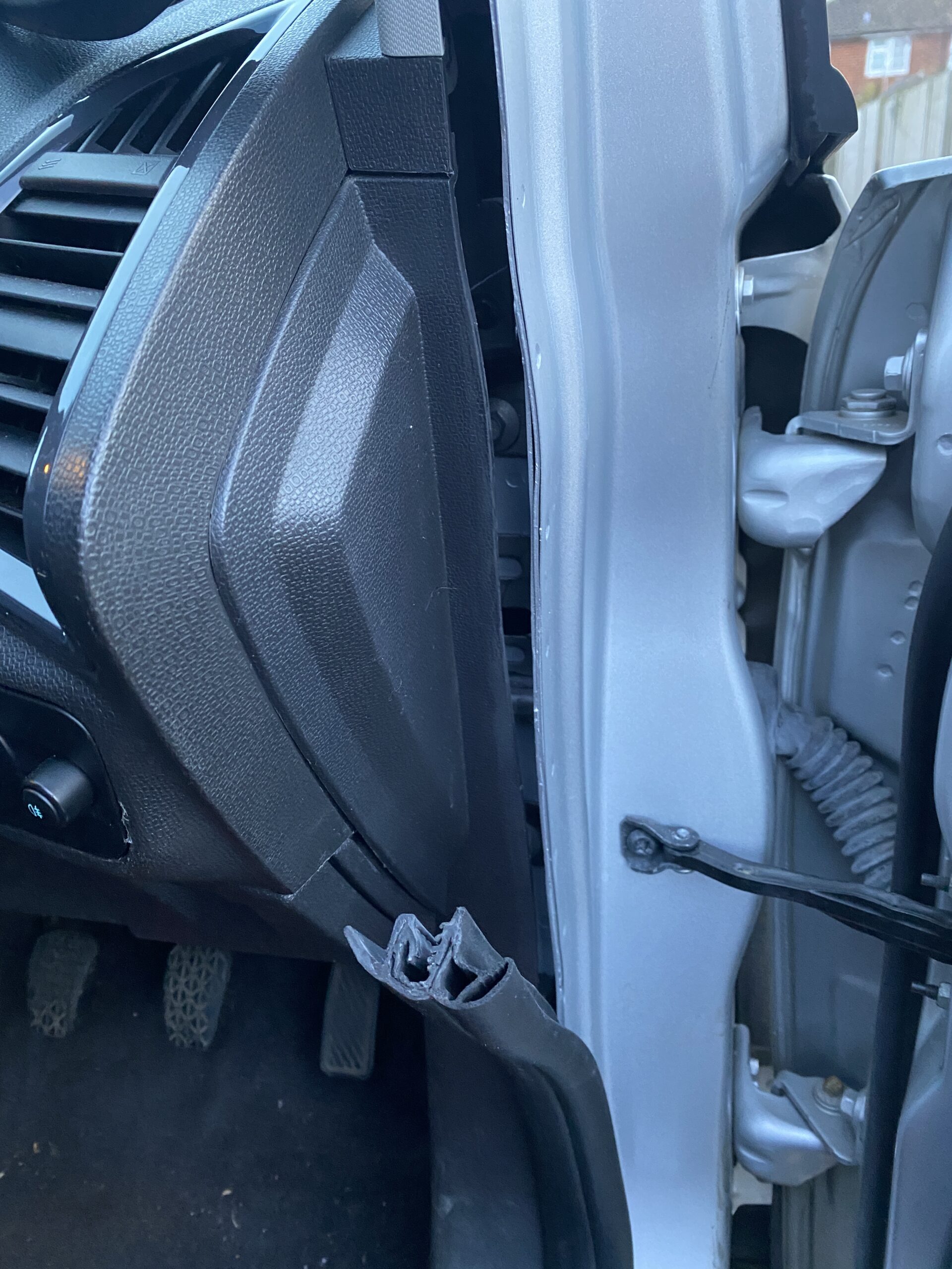

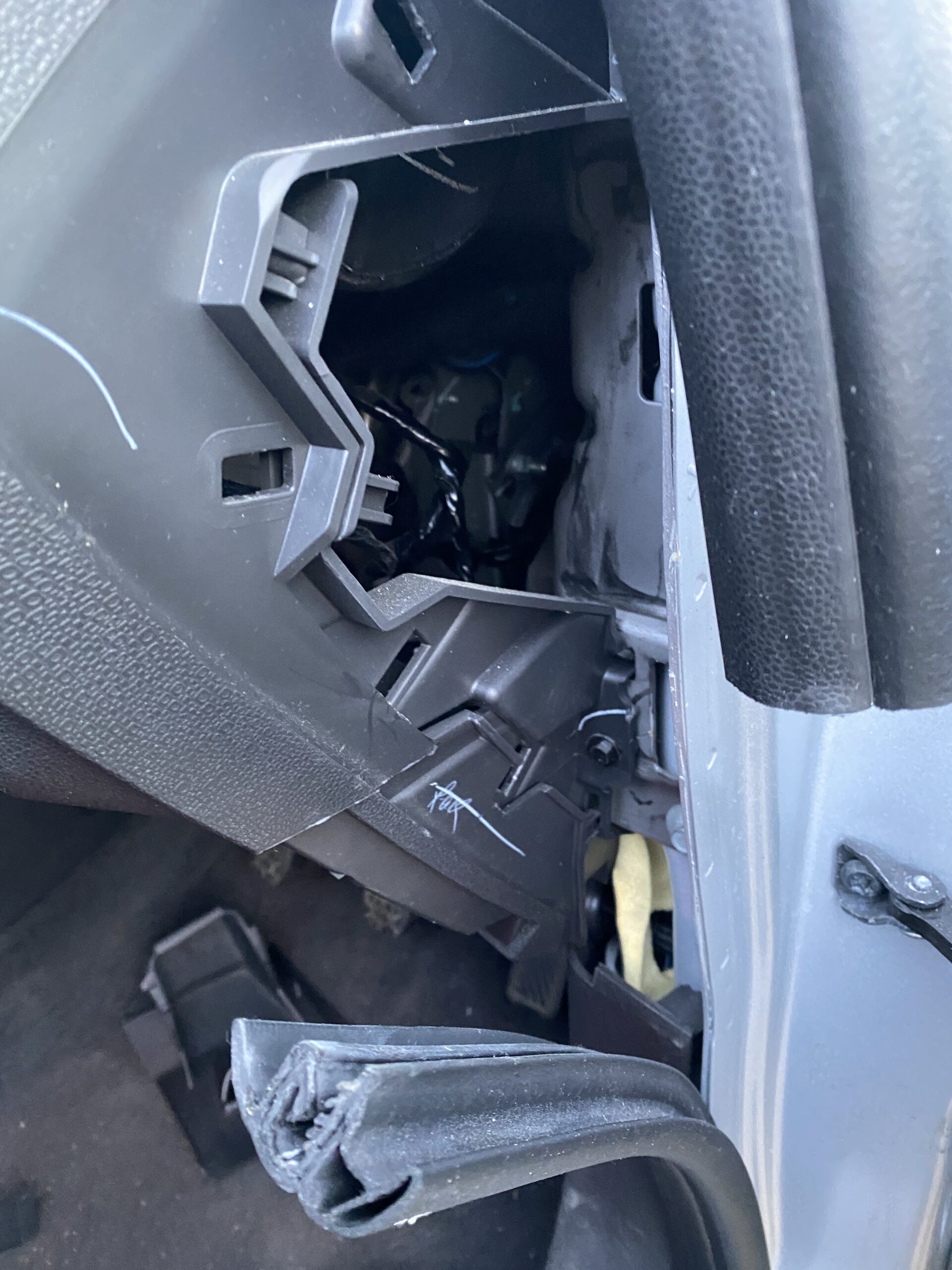

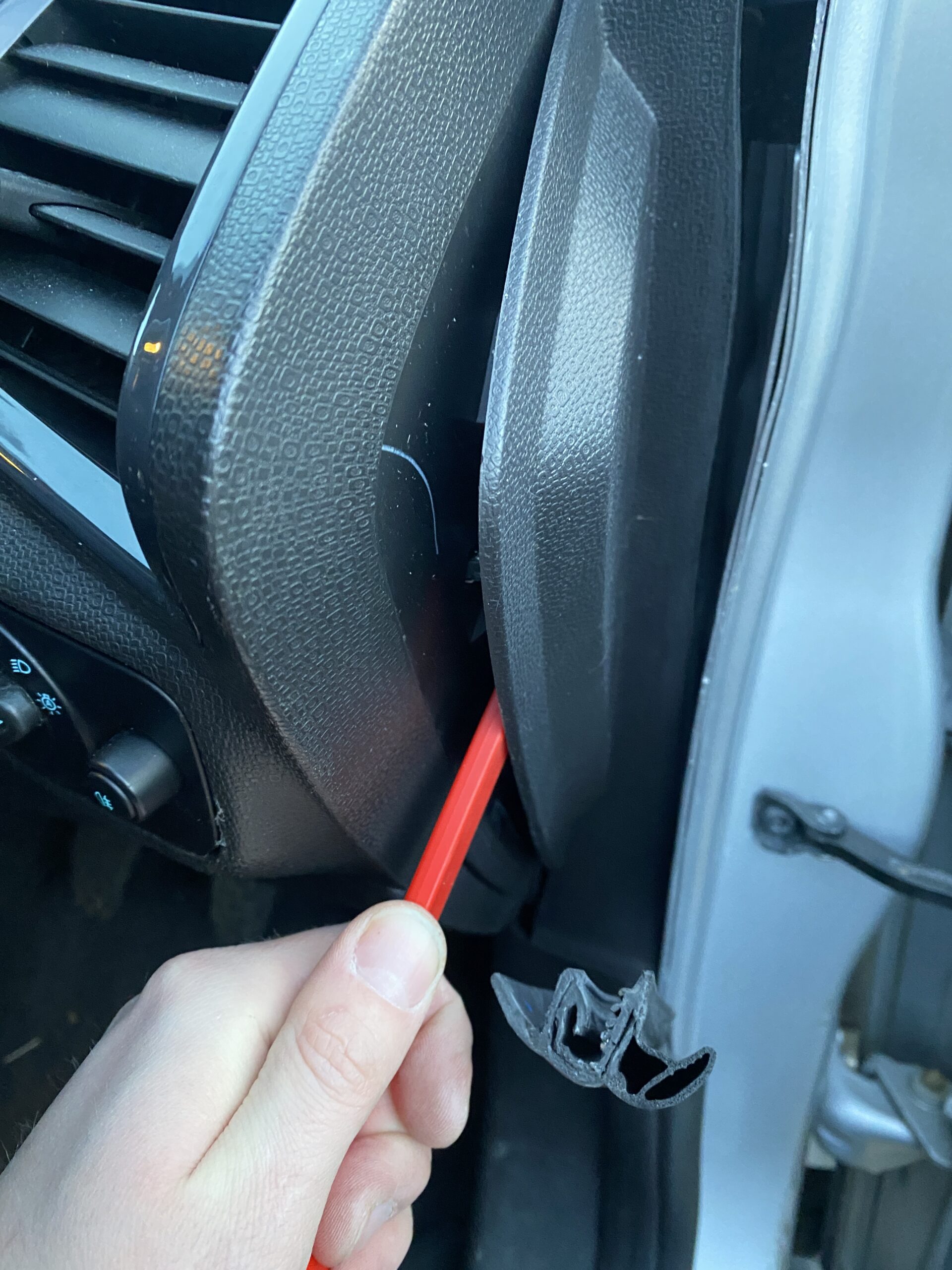

Now remove the end cover on the side of the dashboard. Pull the weather seal back, then using a plastic prising tool (or a flat blade screwdriver), pop it open and remove it.

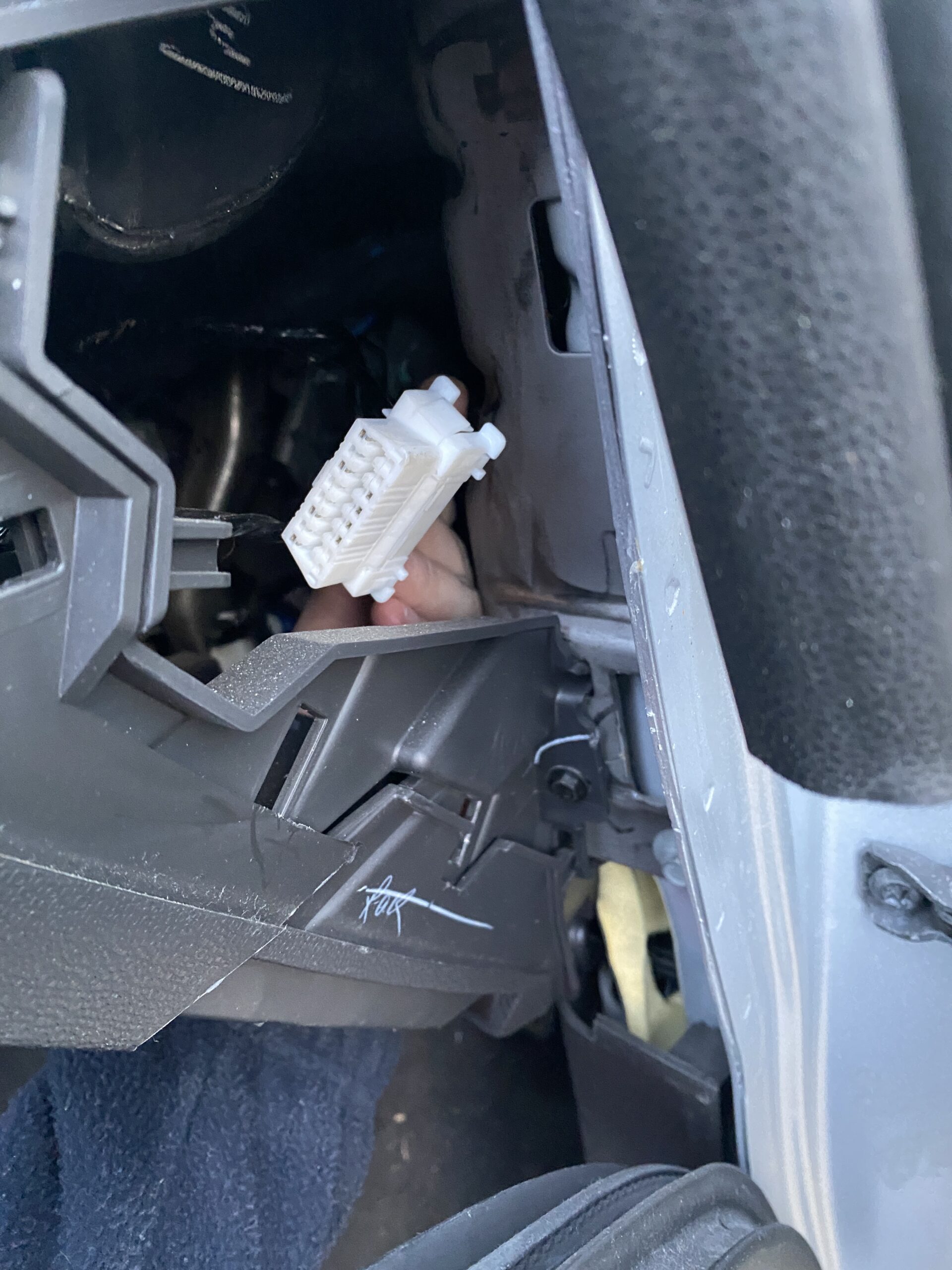

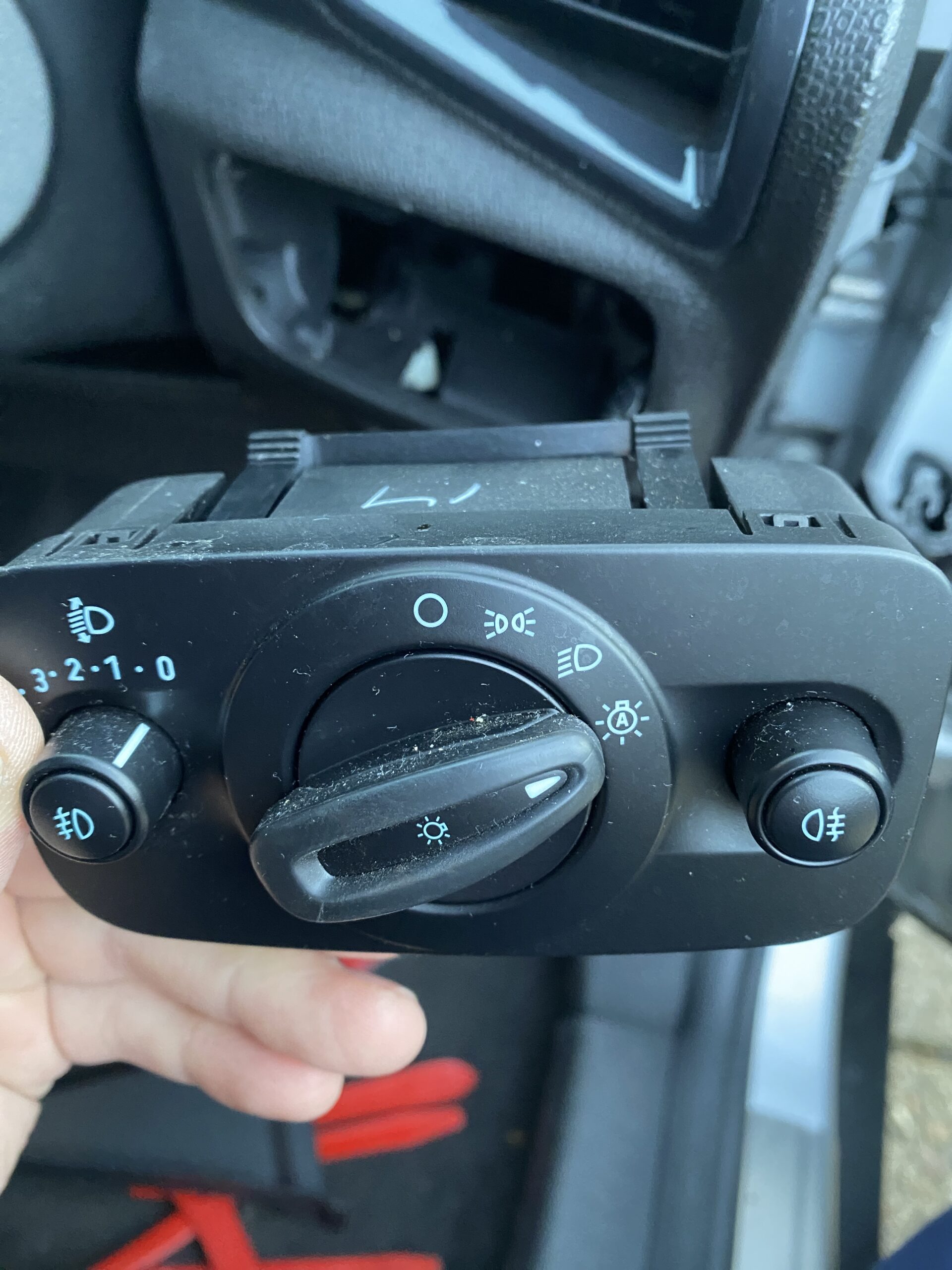

For a little bit more access to the area, remove the exterior light switch. Put your hand through where the cover you’ve just removed was and release the switch clips and push through.

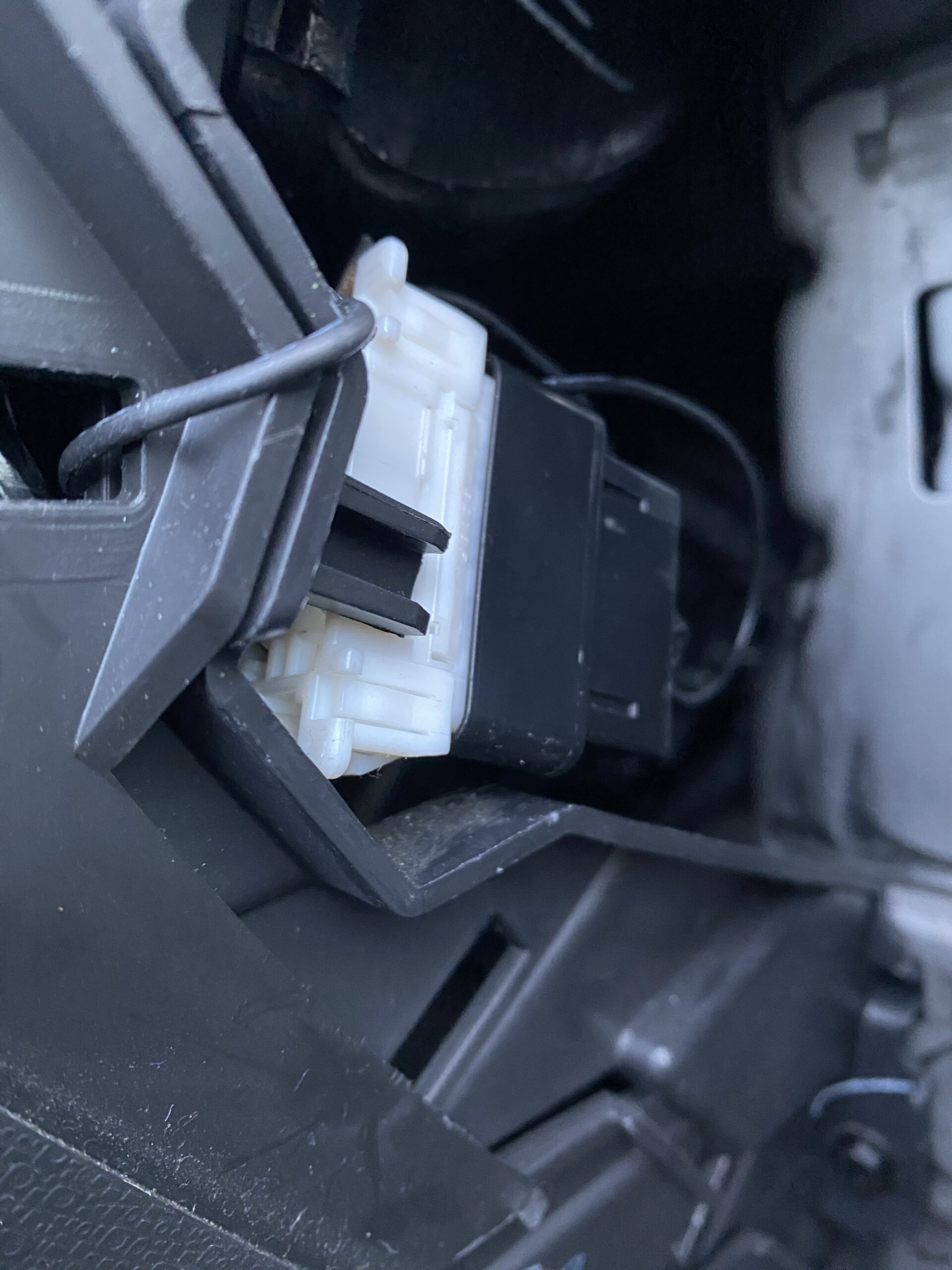

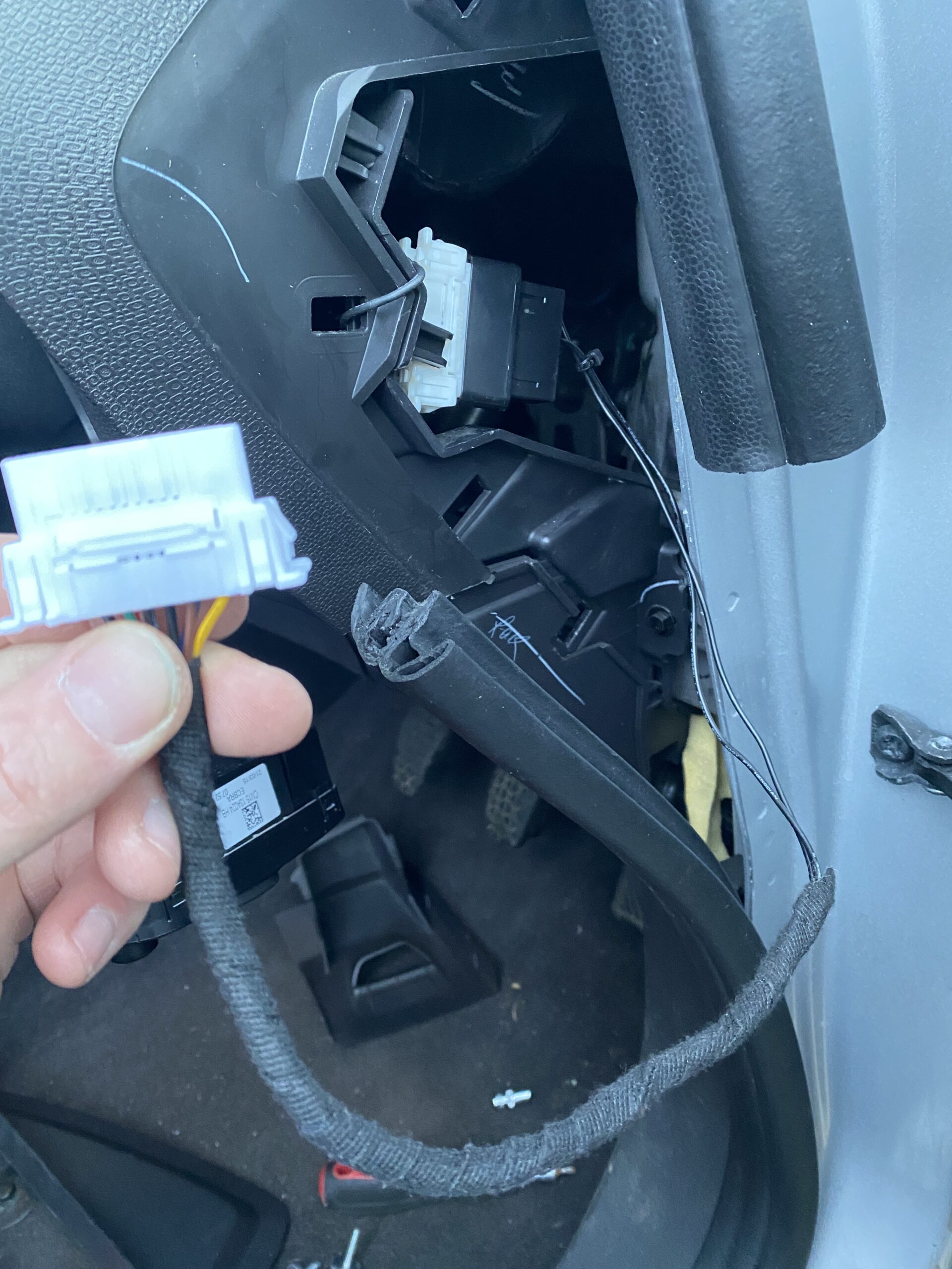

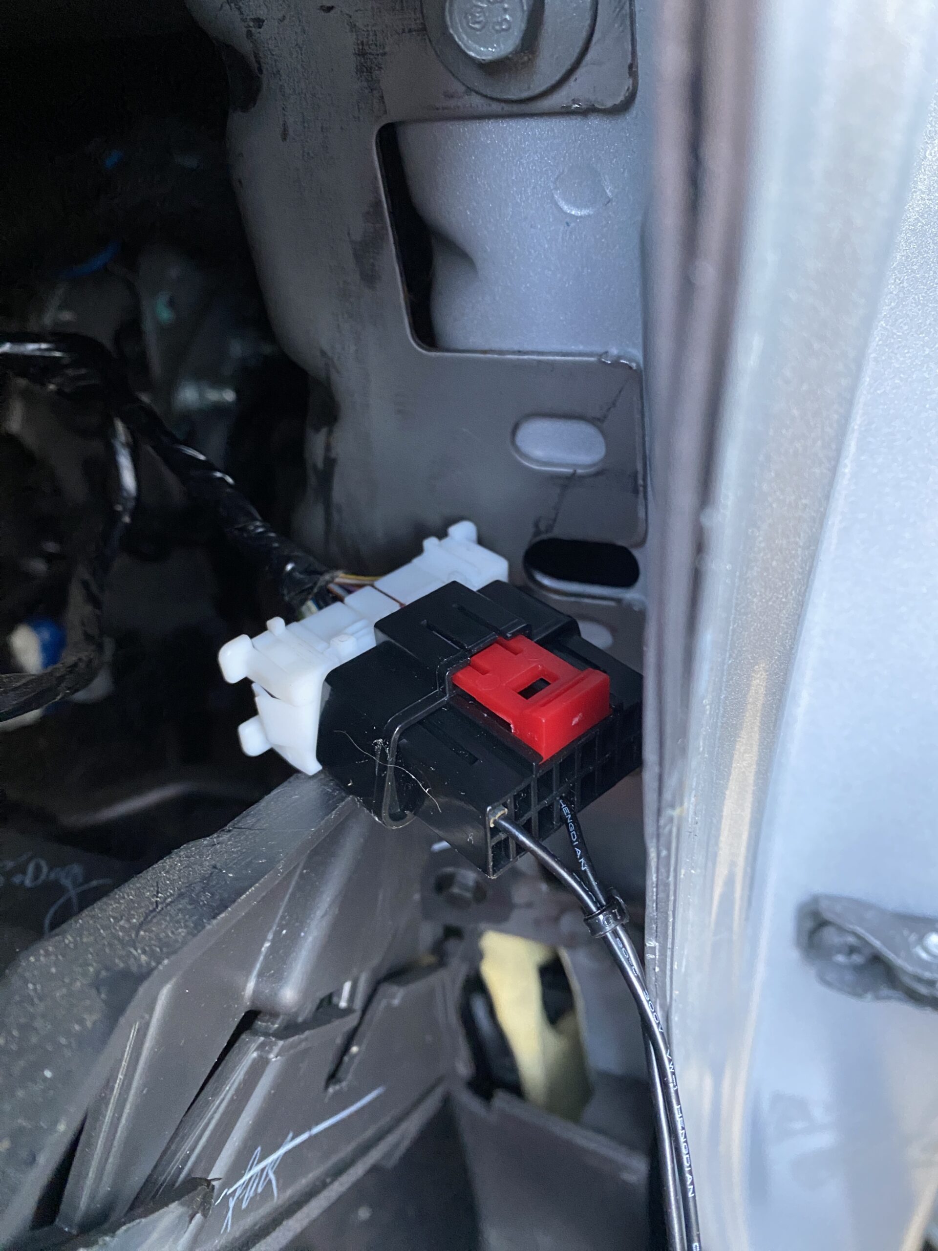

Pull the ODB port through and attach the dummy wiring loom. (dont forget to push the red tag in to lock it in place). I also used a tie to secure the actual OBD port up by the light switch. (We don’t want potential thief to pull loom through to get the real one).
