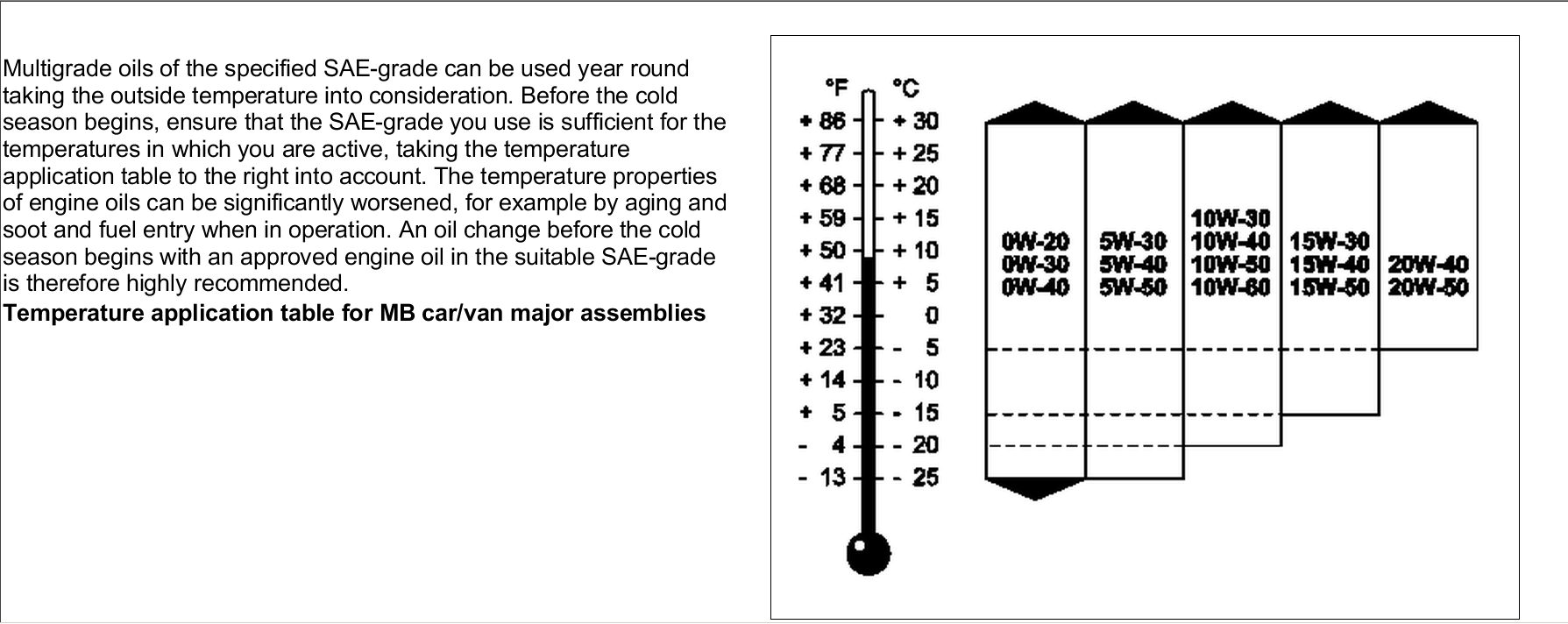

Whilst the topic of engine oil grades is important, its a whole different scope not for this post (see MB info here). You can have the same specification with different grades. You must ensure that you use the correct grade – I’ve been using 5W30 in the UK. Other climates need the correct grade accordingly.

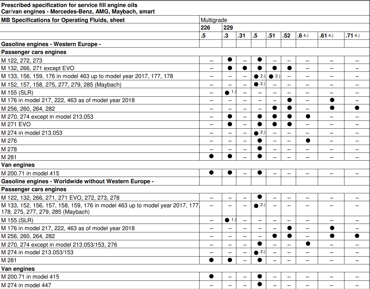

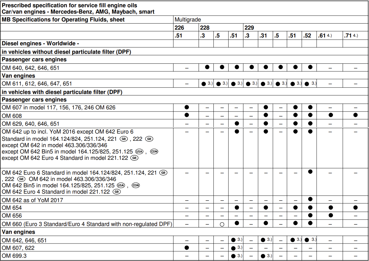

Back to specifications – Mercedes-Benz make this nice and easy with this little specification chart;
For Petrol (click to enlarge)
For Diesel: (click to enlarge)
There are multiple listed for some, but the lower numbers are basically earlier specifications, that have been superseded by the later numbers.
Simplified spec list for W212
If your not sure on the above table; For W212 E Class’s;
Petrols
M271 Engine – 229.3 / 229.31 / 229.5 / 229.51 / 229.52
M271 EVO Engine – 229.3 / 229.5 / 229.51 / 229.52
M274 Engine – 229.3 / 229.5 / 229.51 / 229.52 / 229.6
M272 / M273 Engine – 229.3 / 229.5
M276 Engine – 229.5 / 229.6
M278 (E500 4663cc) Engine – 229.5
M156 (E63) Engine – 229.5 / 229.51
M157 (E63) Engine – 229.5
Diesels
OM642 (V6) Engine – 229.52
OM651 (4 cylinder) Engine – 228.51 / 229.31 / 229.51 / 229.52
229.52
In a lot of cases, always with a diesel, 229.52 is what you want. Pick the suitable grade for your climate. Remember me mentioning ‘Approved’. Well what better than genuine. Never bad on the price either.
