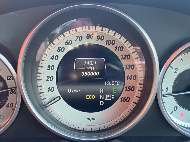

2016 W212 OM651 E-Class Now Up to 350,000 Miles / 7 Years Old – What’s gone on
3 years a go I posted this: Running A 2016 W212 M651 E-Class Up to 300,000 Miles / 4 Years Old – What’s It Like. This post mainly was about the life it had in previous ownership, however the last three years have been my use. My use of this car was always going to be much less than the last owner which was going to and from airports, in addition, my 80 ish mile round trip to work become around 16 miles with a job change.
Now we are here and the old girl has made it to 350,000 / 7 years, what’s gone on? Honestly, not a lot. Following the same format as the previous post, here’s what’s needed to be done;
Servicing
Always serviced using Fuchs Titan GT1 5w30 229.52 (Approved by Mercedes-Benz)
  • 314043 Miles. 26/06/2020 – A Service
  • 328894 Miles. 09/04/2021 – B7 Service (Additional: Gearbox oil and filter change)
  • 340000 Miles 09/04/2022 – A1 Service (Addtional: Brake fluid change)
  • 350031 Miles. 08/04/2023 – B3 Service (Additional: Air filter, fuel filter)
  • Each time it was serviced the adblue has been topped up, taken around 25 litres.
