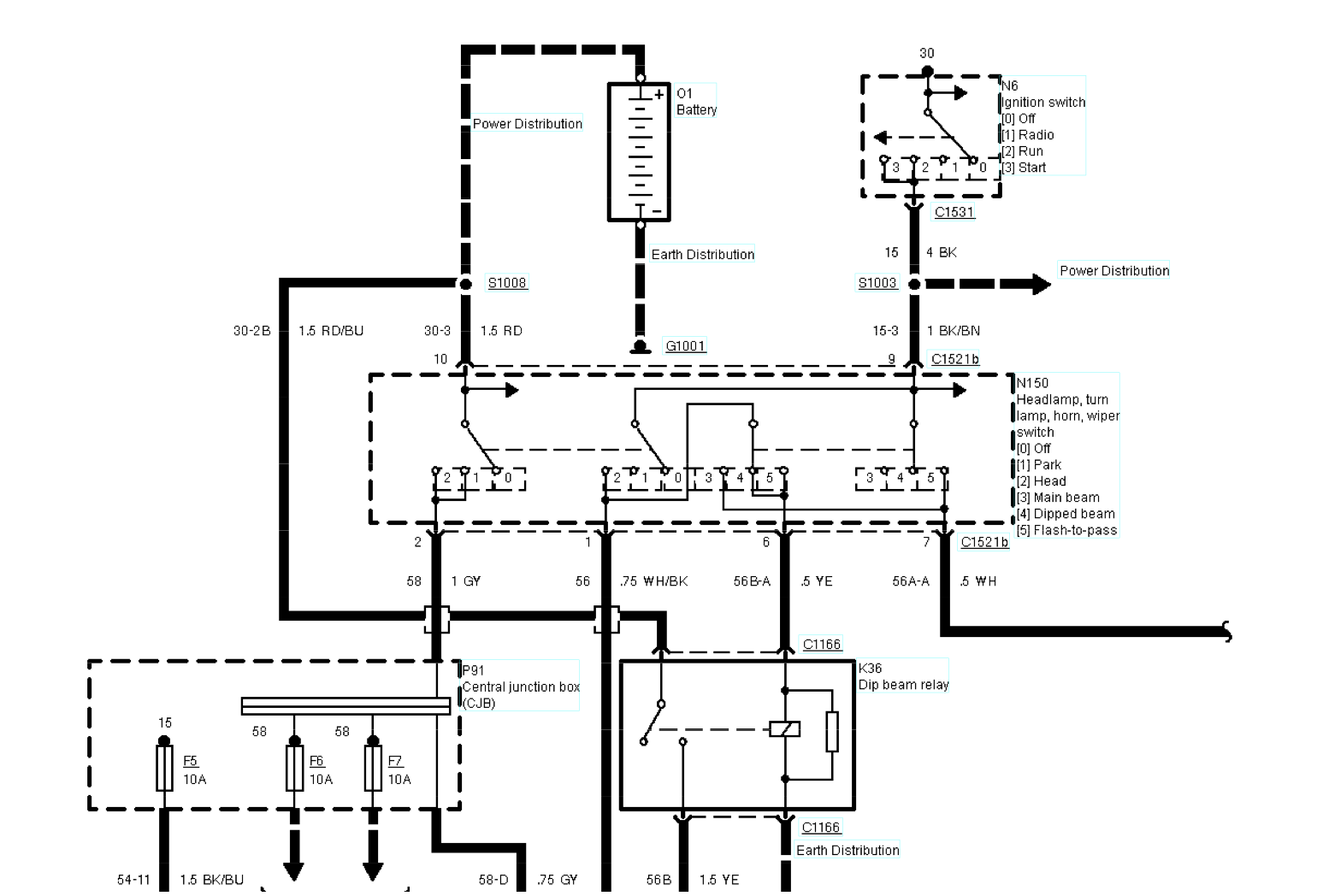

Headlamps
Daytime Dip Lamps
With the ignition switch (N6) in run and the headlamp, turn lamp, horn, wiper switch (N150) in position 1 (park), current flows through the switch (N150), the dim dip relay I (K78), the dim dip relay II (K79) to the high beam lamps (E1, E7) and the indicator in the instrument cluster (A70) further to earth. The high beam lamps do not illuminate due to insufficient voltage, but the dim dip relay II (K79) energizes. Current then flows from fuse 5 through the relay (K79) to the headlamps. Before model year 1994, each headlamp (E1, E7) is thus connected in series with an additional headlamp (E79, E80), and the strength of the illumination is dimmed. As of model year 1994, the dip beam lamps (E1, E7) are connected in series through fuses F8 and F9, and the strength of illumination is dimmed.
Dip Beam Lamps
With the ignition switch (N6) in run and the headlamp, turn lamp, horn, wiper switch (N150) in position 2 (head), voltage is applied through the switch (N150) and the dip beam relay (K36) to earth. The dip beam relay (K36) energizes, allowing voltage to be applied to fuses 8 and 9 and to the dip beam lamps (E1, E7).
The right dip beam lamp obtains earth through the dim dip relay II (K79).
Main Beam Lamps
The main beam lamps may be illuminated with the headlamp, turn lamp, horn, wiper switch (N150) in position 3 (main beam) or position 5 (flash-to-pass). For both methods, with the ignition in run, voltage is applied through the switch (N150) and to the main beam relay (K37). The main beam relay (K37) energizes, allowing voltage to be applied to fuses 10 and 11 and to the main beam lamps (E1, E7) and to additional headlamps, main beam (E79, E80). With the main beams on, the indicator in the instrument cluster (A70) is illuminated.
