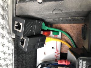

For the ProDJ Link function to work when using rekordbox it all needs to be connected via a ethernet hub. I have mine hidden away underneath the mixer, with two extra cables coming out for laptop connections. I just coil them up and poke them behind the mixer which was never ideal as when you need to get to the back of the mixer its another cable in the way. This is easily solved by a ethernet joiner
Just run cables from the hub to where suits and easy connection / disconnection point, for me the top corner of the box.
