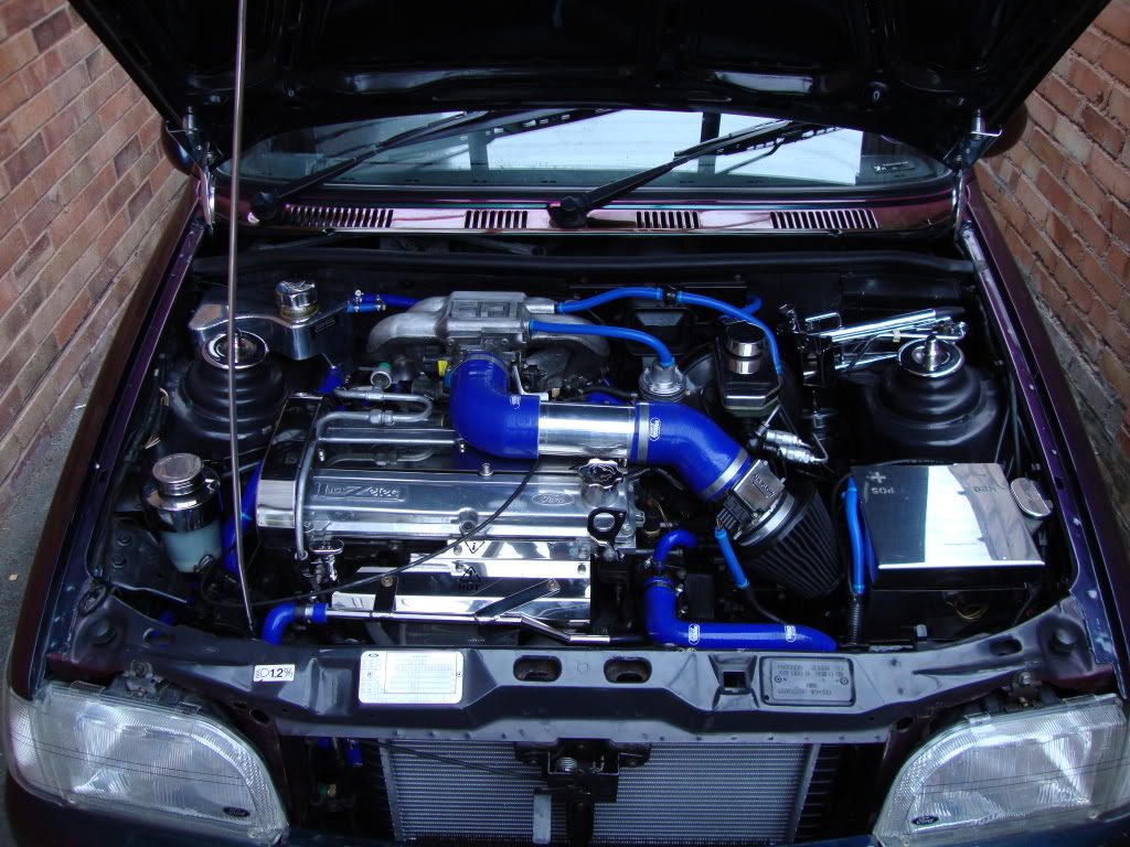

Basically its made up of 3 parts, 2 samco hoses, a aluminum tube and 4 hose clips (2 each end of the tube, 1 on the throttle body and 1 and the maf)
Total cost for this mod should be about £50-£60 (Without the Filter itself)
Ive had to use bonnet raisers to help clear the gap between the samco hose and the bonnet when its shut.
This will fit any throttle body with an outer diameter of approximately 70mm.

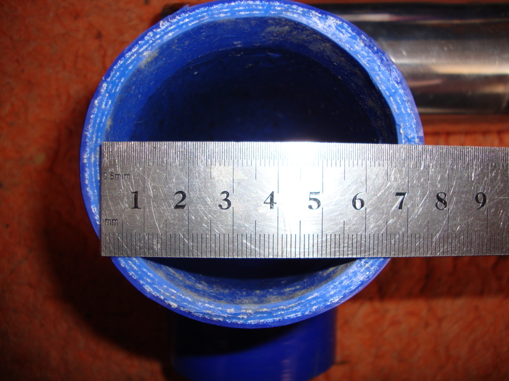

Aluminum Tube.
Length: 220mm (22cm)
Inner Diameter: 66mm (6.6cm)
Overall Diameter: 70mm (7CM) – 2mm thick
90 Degree Samco Hose (Part No. E90 70) RRP £24.27 Inc VAT
Inner Diameter: 70mm (7CM)
Overall Diameter: 800mm (8CM) – 5mm thick
Leg Lenth: 125x125mm (12.5×12.5cm)
45 Degree Samco Hose (Part No. E45 70)RRP £27.56 Inc VAT

Its a bitch to fit the hose at the MAF end as its bigger then the 70mm Samco hose but it will stretch over it.
You could use 2x 90 degree hoses and have the filter pointing right down instead of the 45 degree angle as seen in mine. The Hoses can be cut to length to suit your requirements. Ive cut my hoses back to show more tube and less hose.. The tubing i guess you would have to seek yourself, although i know Samco also do tubing in aluminum or carbon here: http://www.samcosport.com/uk/acc_alloy_jointers.asp
Lee at Fusion Fabrications also does them i think. PM me for his details
End Result:
