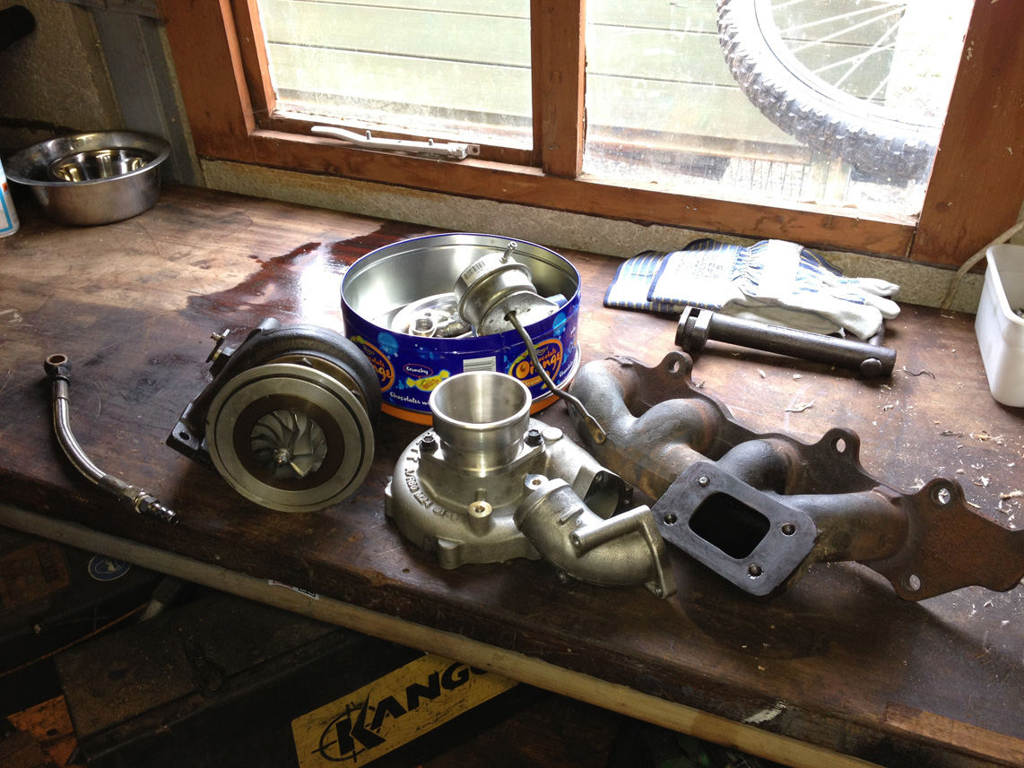

I was desparate to sort the exhaust blow, but you know when you get that feeling youve started do something thats gnna take a long time…. The turbo/manifold assembly was a nightmare to get out as it had to come out in one piece. I had the car on a 2 post ramp and then had to jack the engine/gearbox up to manage to manouvure it out (brake linkage is what made this so hard). This was after struggling getting a downpipe to turbo bolt out that was mashed and having to take some manifold to head stubs out with everything in situ.

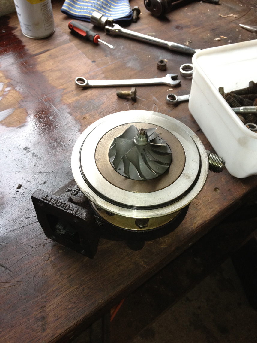

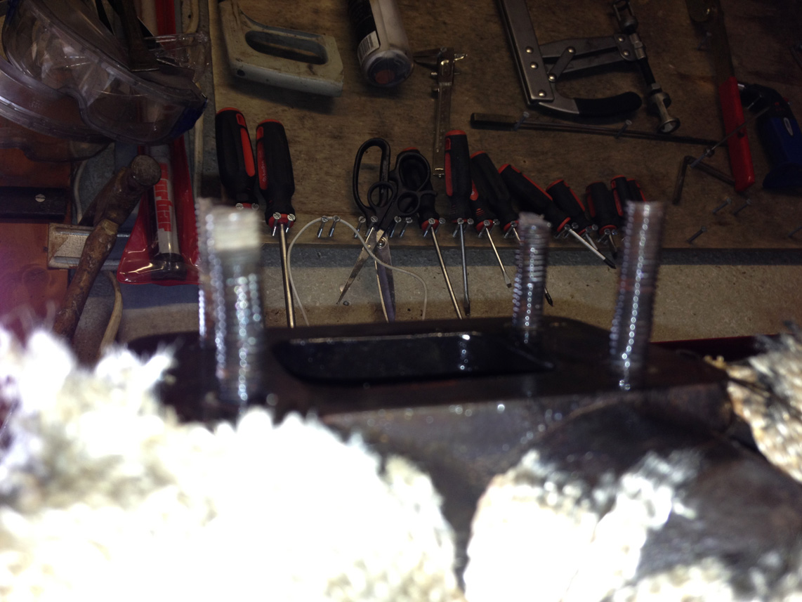

Some pictures will tell some talking…
01 IMG_0537
02 IMG_0538
03 IMG_0539
04 IMG_0540
05 IMG_0541
06 IMG_0542
07 IMG_0542
08 IMG_0544

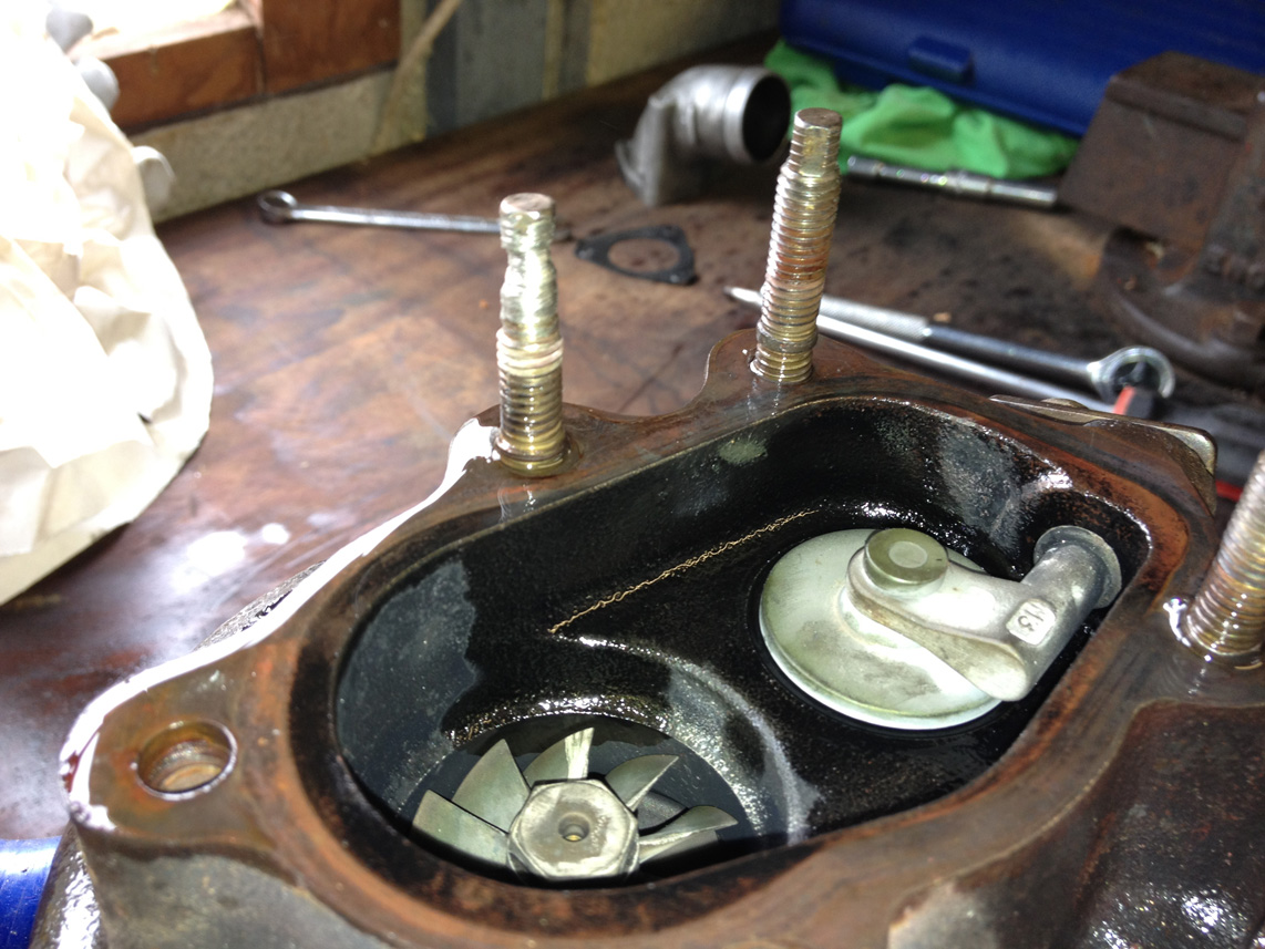

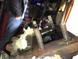

Every stud from the manifold to turbo is bent. Not to mention that none of the bolts where actually tight lol. I put this down to the fact that the turbo had been hitting the brake linkage (which ive allready amended). The more concerning part to these studs… not to sure what thread size studs its ment to have from manifold/turbo but its been helicoiled with 8mm inserts…. (now removed) apart from one that snapped. 😡 So ive got too get the snapped stud out, then get it sorted to take whatever size its ment too take. (anyone know?)
Also the totalled stud in the turbine housing snapped whilst getting out.

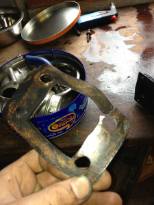

Its allways had a little leak from turbo area, ive put this down to the fact that the oil return flange was finger tight (&oil return gasket was naffed) and then the fact the turbo/manifold gasket was in pieces this was blowing oil residue around.

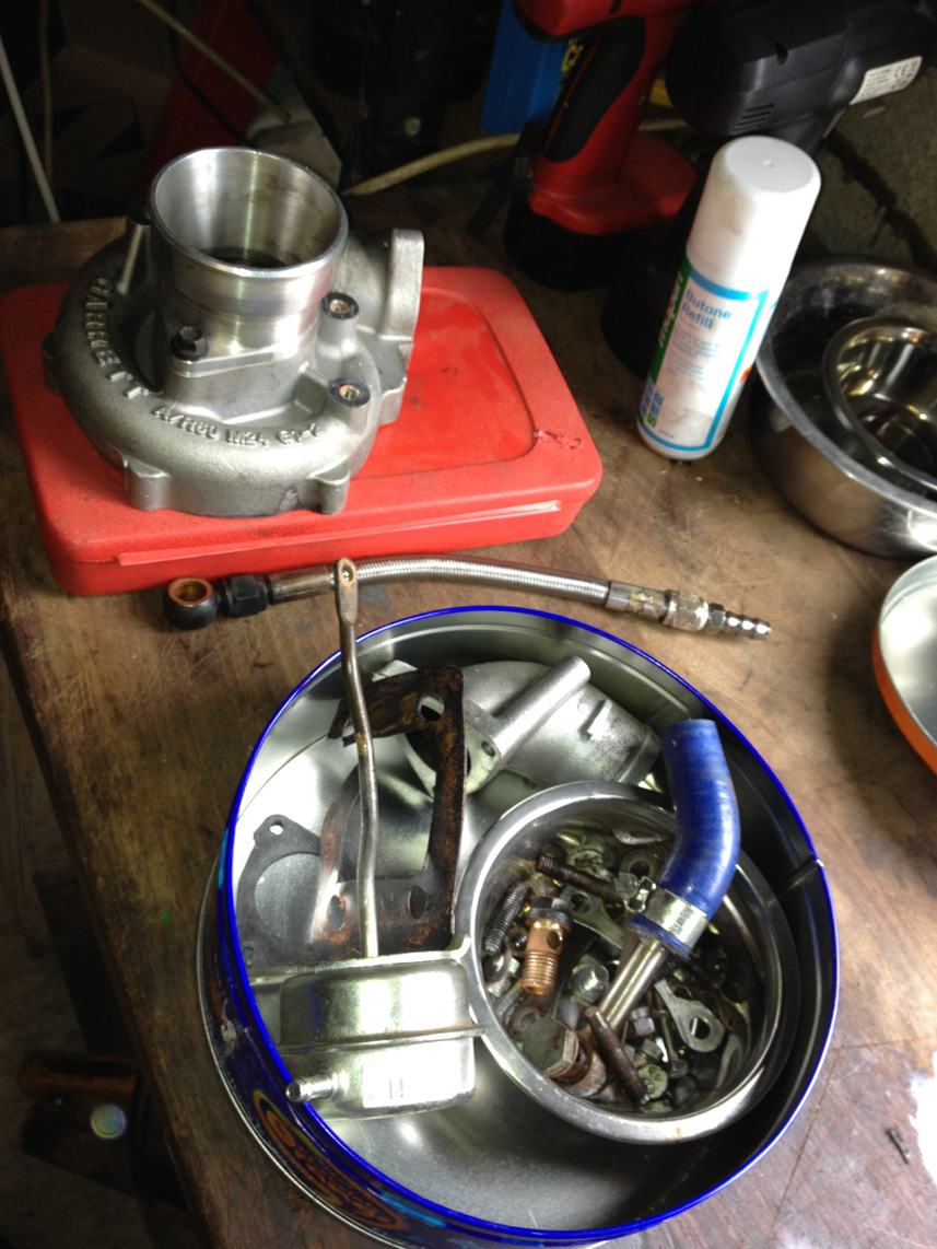

As i want to replace all gaskets, copper washers etc for bango bolts, water/oil lines ive had to take the compressor housing off to get to some of the bolts.
Shopping list is: New studs for everything and washers/nuts. All copper washers for banjo bolts. Oil return flange gasket. turbo/manifold & manifold/head & turbo/downpipe gaskets. Compressor housing seal. New heatwrap OR ceramic coating for downpipe & manifold.
Anyone know a place to get good gaskets, dont want cheap crappy ones?
