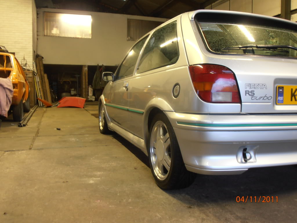

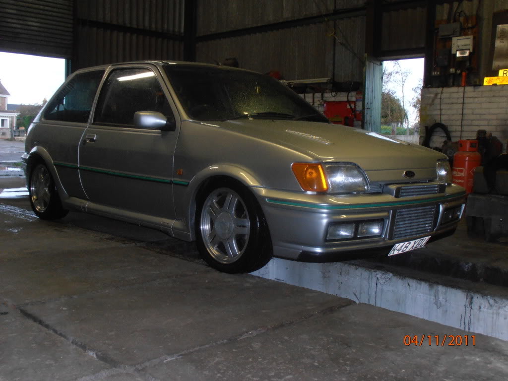

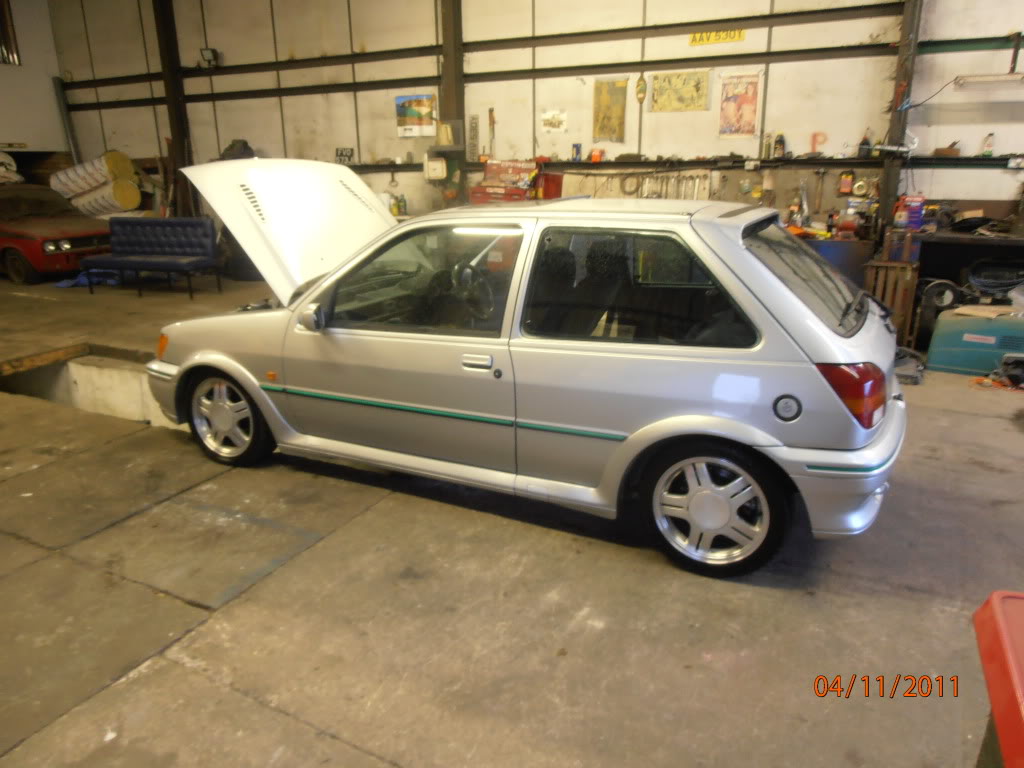

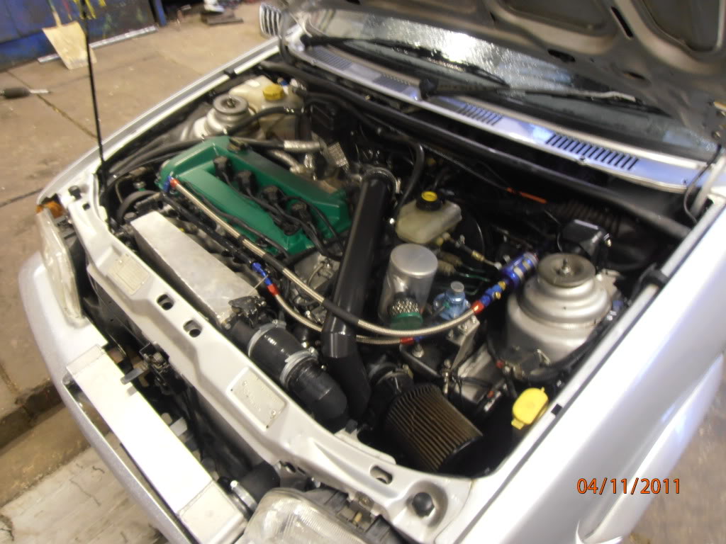

These are the pictures from the ebay auction when i purchased it. It appears that after being sold to some guy in wales, it made its way to another chap in isle of white, then to a guy in colchester.
This chap in colchester done a few things:
  • -When he first got it, he had running issues. Popped and banged at anything over 4K.
  • Took to jamsport, they remapped to suit the duratec and upped the boost to 15psi.
  • Jamsport noted it struggled to make any power at full throttle, said most likely due too restrictive boost pipes and intercooler

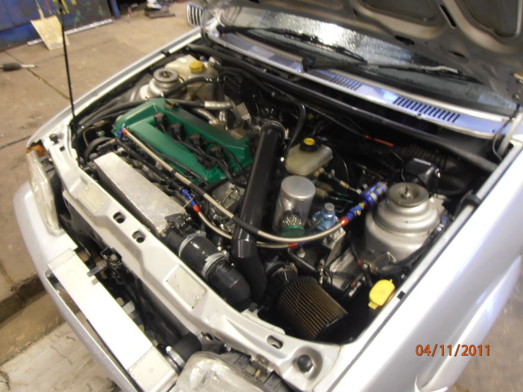

  • He was sheet metal worker by trade, so fabricated an intercooler and hard boost pipes as in photos below.
  • It ran alot better, but smelled very rich so dropped the fuel pressure and in his words it absolutely flies.
He was a nice fella, genuine. I visited twice, on the second time i paid a deposit and he agreed to deliver the car on his truck. Which he did!

For those of you that don’t know about it, its a 2.3 Duratec Turbo. Run down on spec:
Quote:
Engine:
American Ford Focus (2005 model-year) 2.3 Duratec-HE 16V all-alloy block. (Same base-engine as Mazda MZR 3 & 6 MPS and bigger brother of UK Fiesta MK6 ST 2.0 engine).
Stripped down and bored to 88mm (standard bore is 87.5mm). Now 2286cc.
Fitted with 8.5:1 compression CP Pistons from the USA.
Eagle Con-Rods fitted
Cosworth head gasket and mains/big-end bearings from Burton Power.
ARP fasteners used for the Head, Mains, Big-Ends, Flywheel fastenings.
Garrett GT28R Ball-bearing turbo (new from Horsham developments – done 3,500 miles cost £700)
Exhaust manifold from Pumaspeed (the same one they sell for MK6 ST Fiestas).
Fidanza Flywheel (replaced standard dual-mass one).
Sytec fully-adjustable fuel-pressure regulator
Sytec “bullet” fuel filter
Goodridge “200-seies” braided hose used for fuel feed/return and Turbo oil-drain.
Walbro 255 LPH Fuel pump.
Bosch 460cc injectors.
Focus RS MK1 ECU and custom engine loom.
Mondeo MK3 2.0 Duratec Starter motor & Alternator.
Mondeo MK3 2.0 Duratec Engine mount.
Escort S2 RS Turbo Bailey oil separator.
Custom 3″ intercooler and hard pipes.
Pro-Alloy full-width radiator.
Twin Spal fans.
Custom Alloy inlet plenum
K & N Cone Filter
Modified Fiesta RS Turbo Mongoose full exhaust system.
“Coil-On-plug” ignition with Iridium spark plugs.
Castrol Magnatec 5w30 fully synthetic oil.
Stainless braided turbo oil lines with oil feed filter.

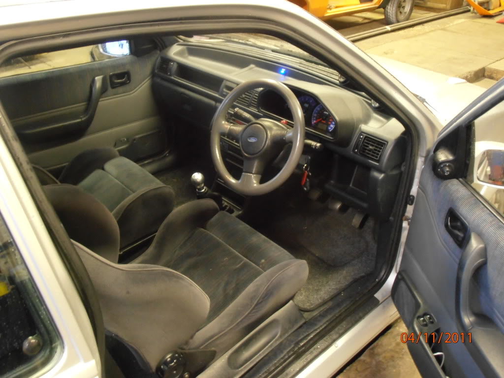

Interior:
Nomad twin A-Pillar gauge pod in matching Raven trim.
STACK wideband lambda gauge & sensor.
STACK capillary water temp gauge.
Alpine head unit, CD.
Alpine door and rear speakers (in original Ford housings – not visible at all).
Full Fiesta RS Turbo Recaro interior – no wear on bolsters or piping.
Fully-functioning Focus RS MK1 Instrument cluster.
Later MK3.5 Darker “Raven” Dash and interior plastics.
Black Carpet & Parcel shelf.

The guy i bought it from has had it remapped, but they said that the restrictive pipework/intercooler was causing problems, so as he’s a metal fabricator he made new pipework up and a new intercooler. (compare the last pic of the intercooler in performance ford mag vs current pics!) It was much better and after he turned the fuel pressure down it absolutly flies! Still needs remapping to finish it off though as can be a bit stuttery at times.
