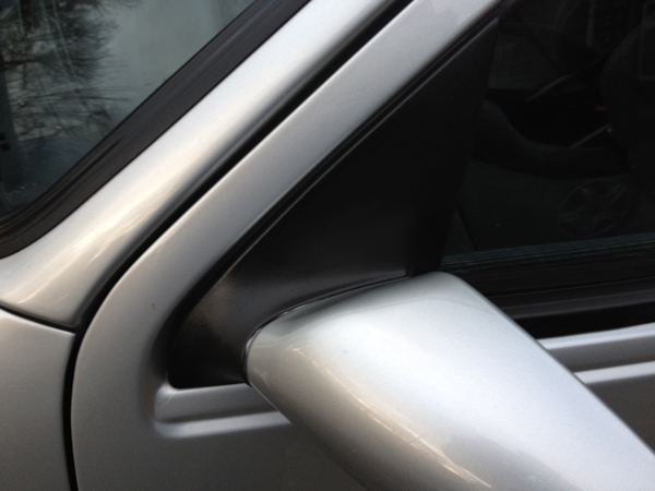

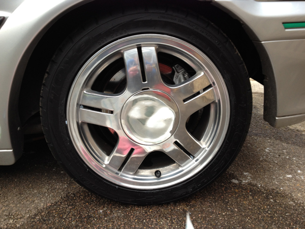

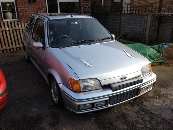

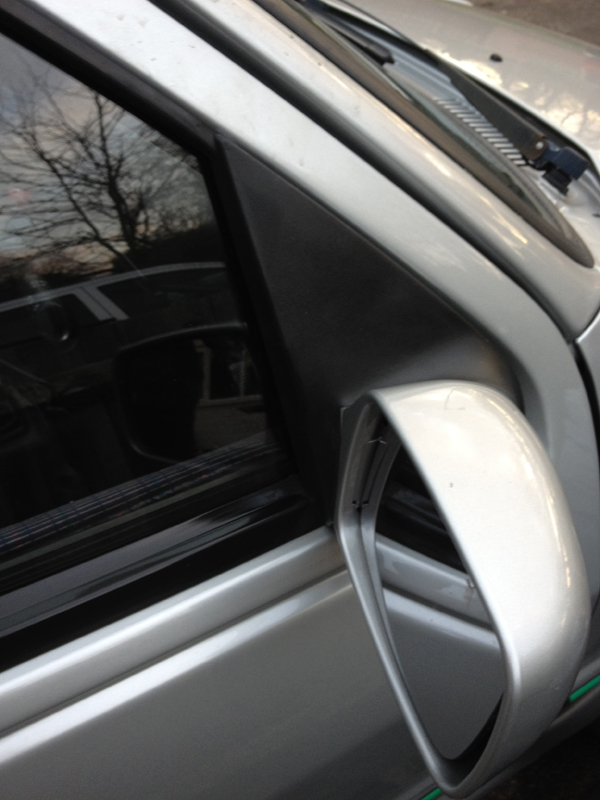

But first. The wheels looked a bit un shiney so i had a polish. I also used some trim wax on certain parts. And some new wipers.

Def needs new wiper arms as there mank.
