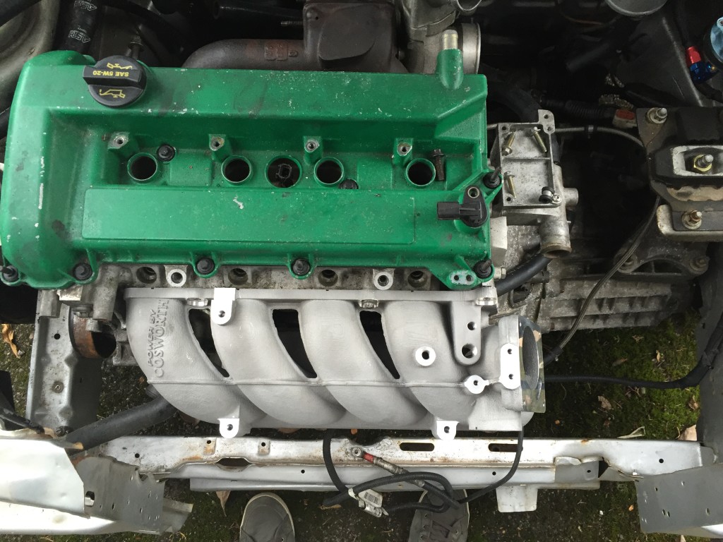

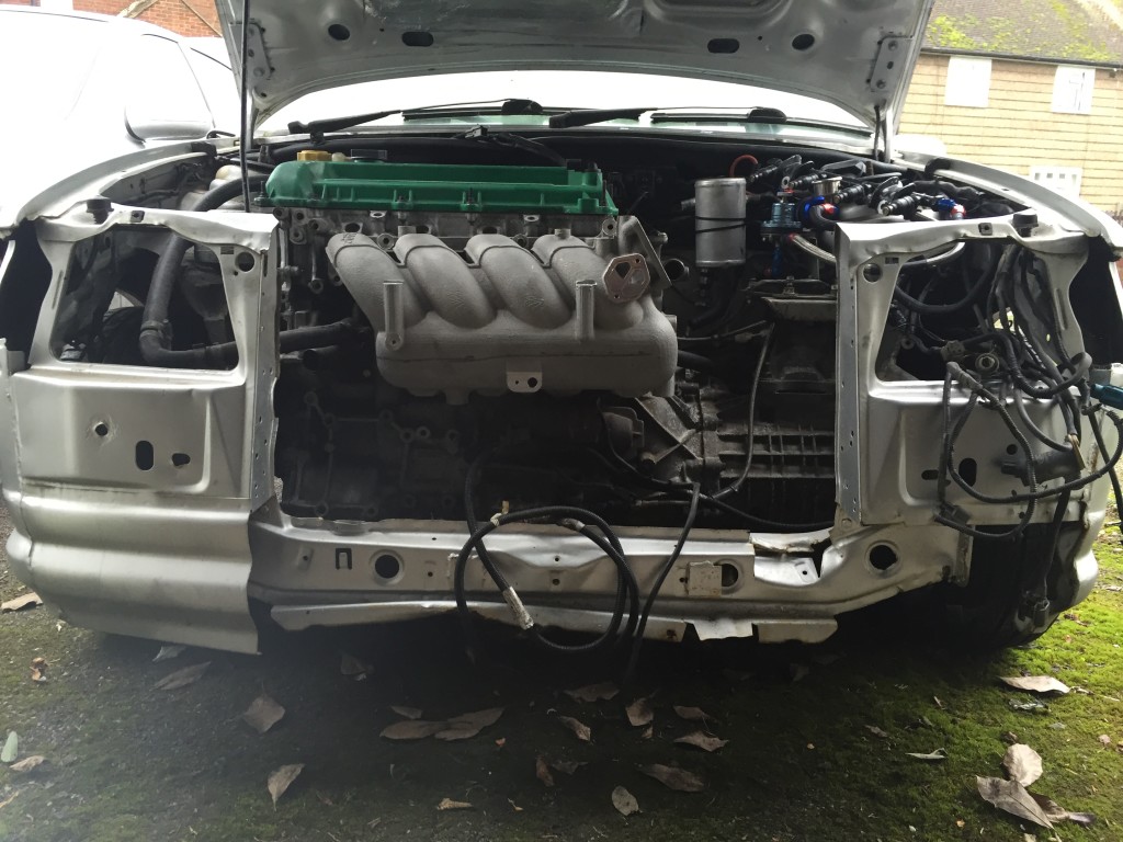

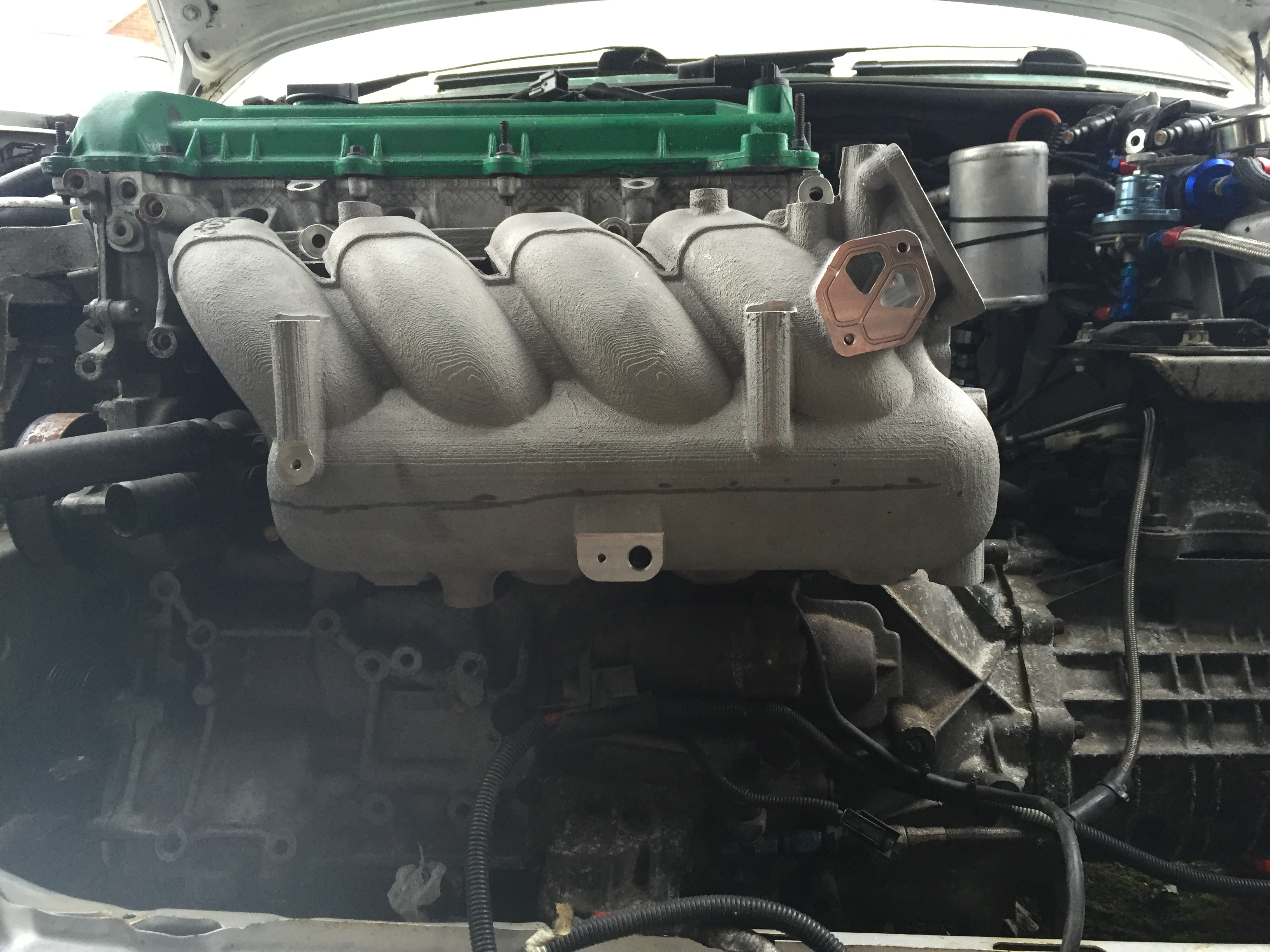

Just been for a test fit and thank god it will fit in the engine bay. Will be able to have the slam panel all standard, poss a small bit may need to be removed.
I think the mating surface of the manifold is going too need to be skimmed as its not 100 flat against the head. (hopefully its not the head).

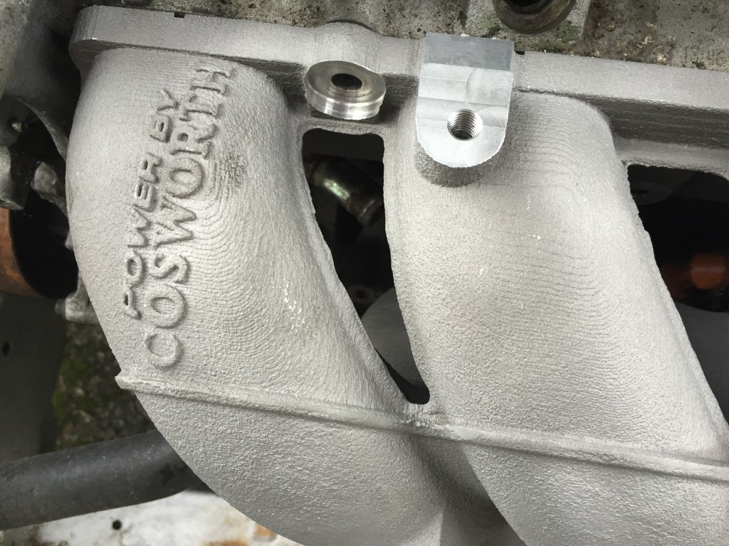

The slam panel was originally cut due to me trying to fit a cosworth manifold, which turned out to be ridiculously big.
I’m going to source a front panel, front cross member, 2 wings. Get the wiring stripped out, inside and out, next get it up to my bodyshop at work and get the panels fitted. This should be a base for me too resume work on it.

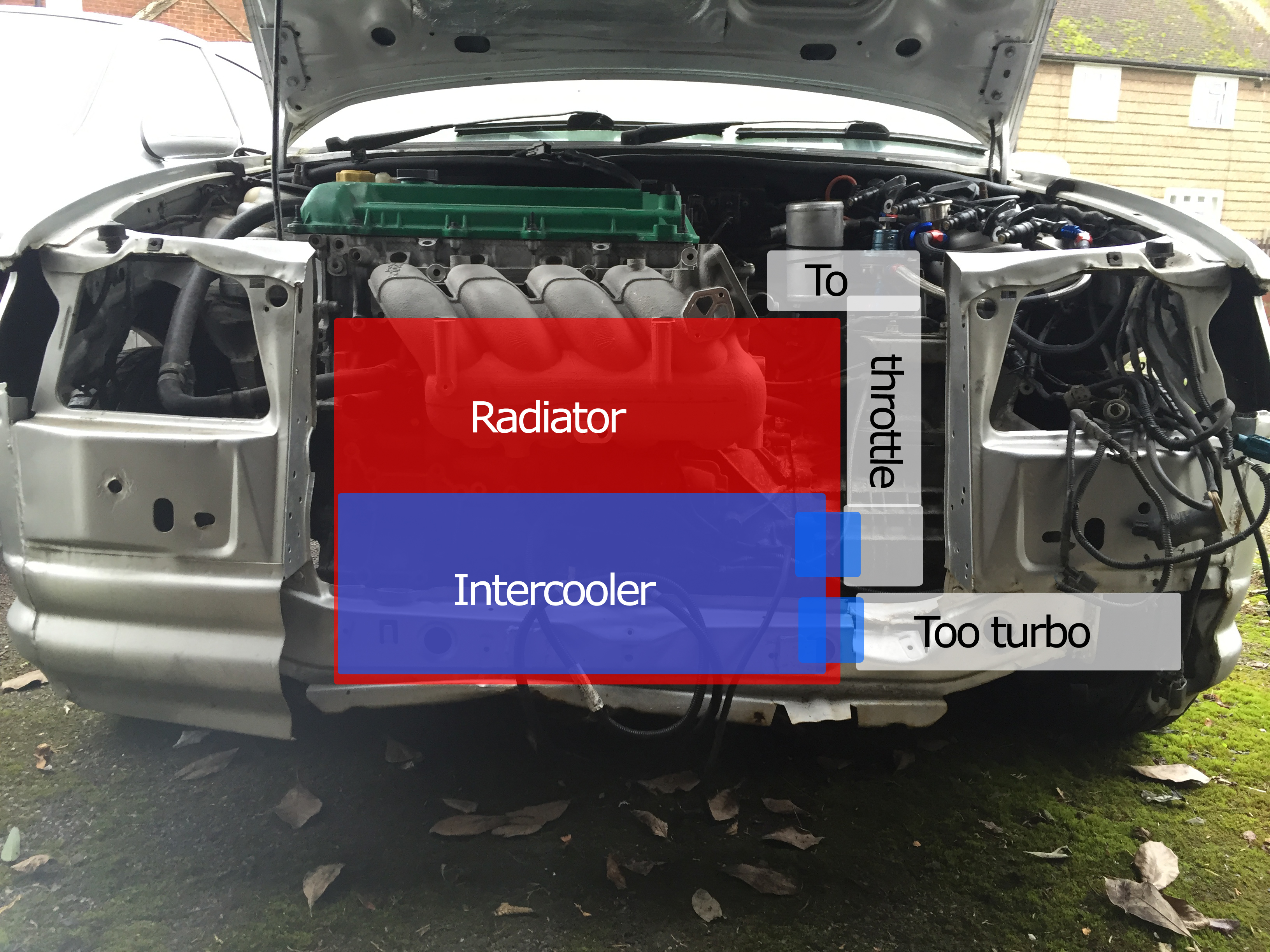

I have done a diagram for how i’m going to get the boost pipes/intercooler set up:
