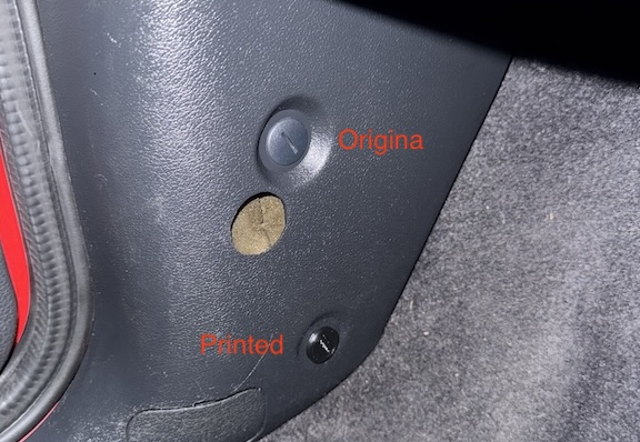

They’ve not come out to bad – unless you’re looking you probably wouldn’t notice.
These are for the later Mk3.5. The early trim panel is different with different fixings (im pretty sure).
Left – Original, Right – PrintedLeft – Original, Right – PrintedLeft – Original, Middle V1, Right V2Left – Original, Middle V1, Right V2

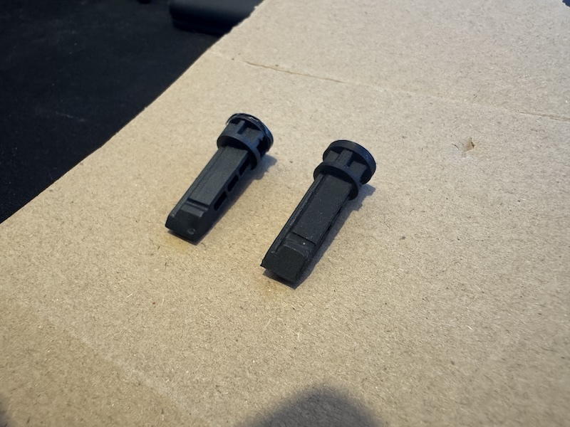

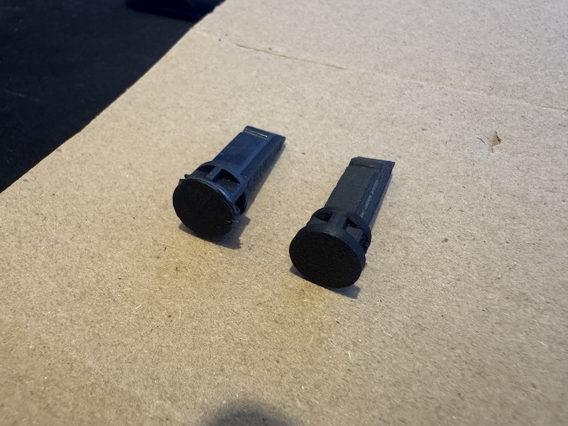

7079618 Interior Trim Panel Fastener – Sill Panel

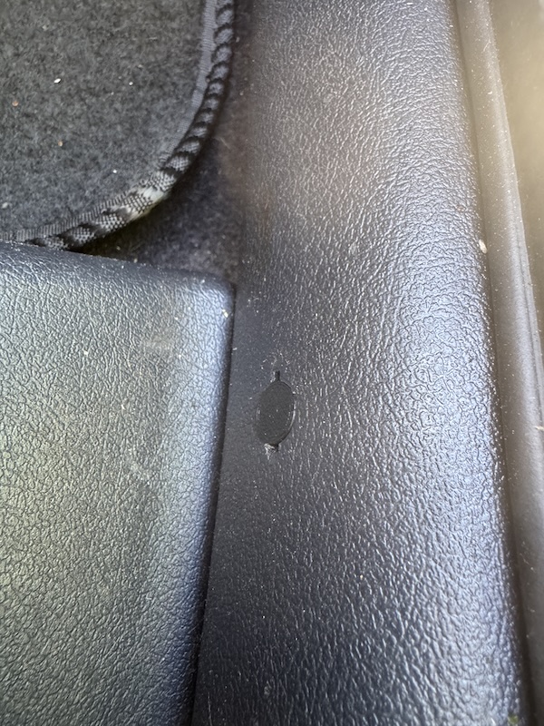

Here’s a trim panel fastener in 3d print file. I think this one is only fitted on Mk3.5, early ones are a different panel. Item 18 on this diagram Original on left. Printed on right; Other way round; Here it is installed; Download here, .3mf in a zipped folder;

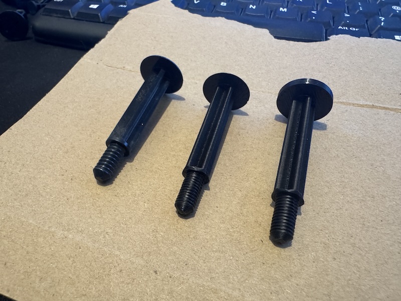

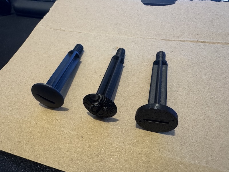

6815336 Interior Trim Panel Fastener – Footwell Area
Here’s a trim panel fastener in 3d print file. I think this one is only fitted on Mk3.5, early ones are a different panel. Item 19 in the diagram; First version we did with the domed head but didn’t print to well with the support underneath it. So we made it flat and works lovely. Left is original, middle version 1, right version 2 with flat head. The thread is not an exact match but it functions perfectly; Download here, .3mf in a zipped folder;
