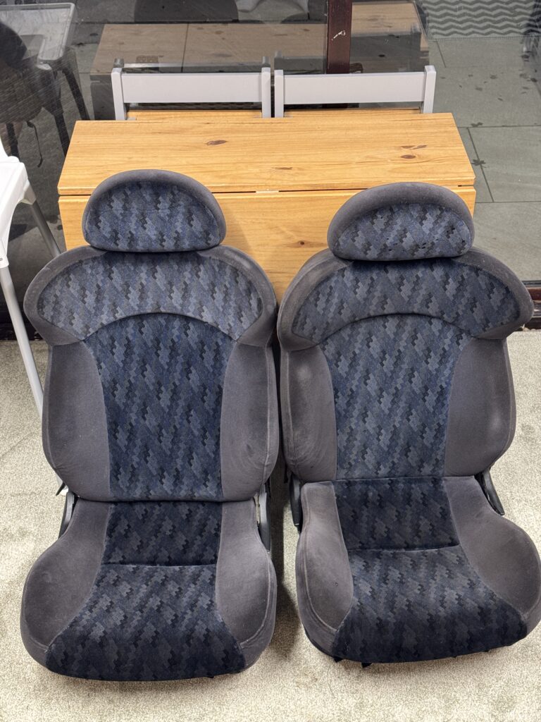

Popped to Leicester this morning to pick up some ‘wingback’ ‘raven’ front seats. On the lookout for a rear bench/backs and door cards if you have them? Contact me

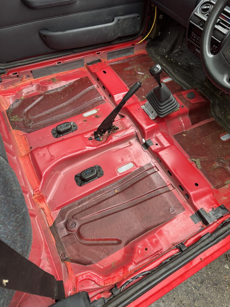

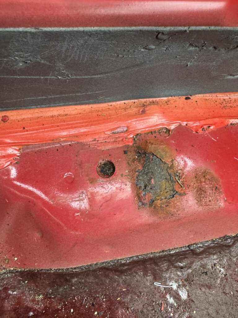

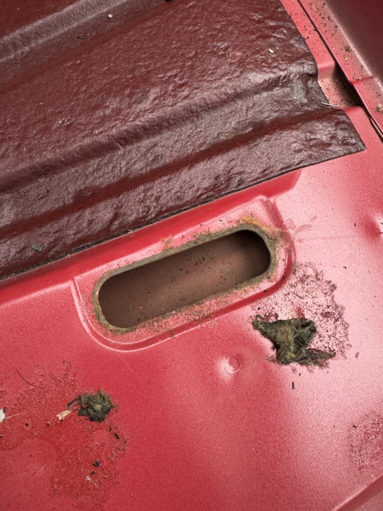

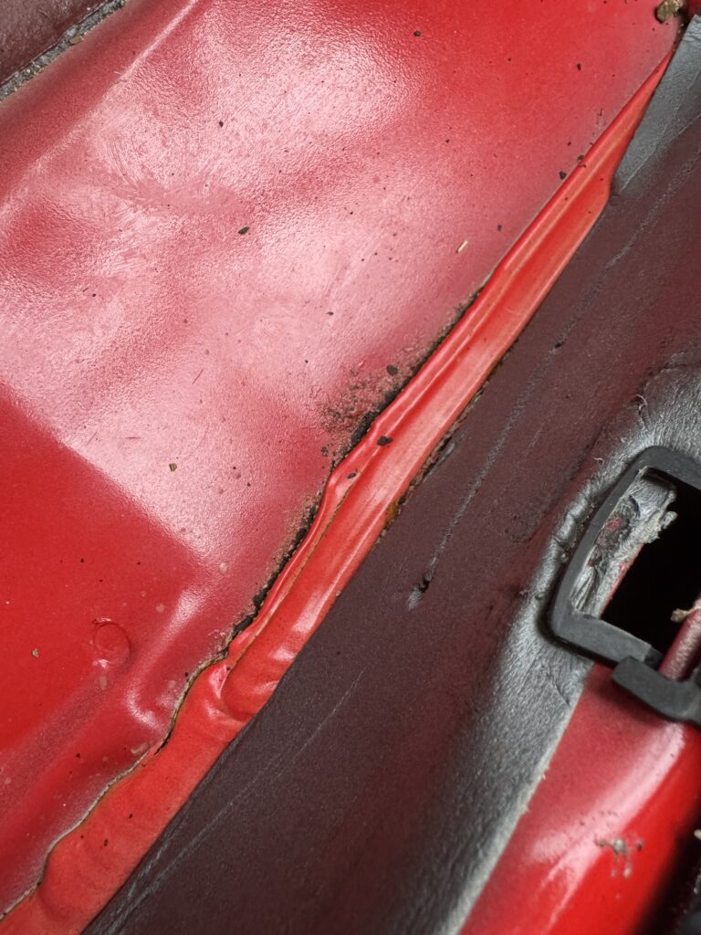

At that point it seemed like a good time to take the carpet / underlay out and make sure that it wasn’t hiding anything rotten – pretty decent to be honest, couple of very minor bits – around the passenger side seat rear bolt and on the drivers side where the floor meets the sill area, very minor really.

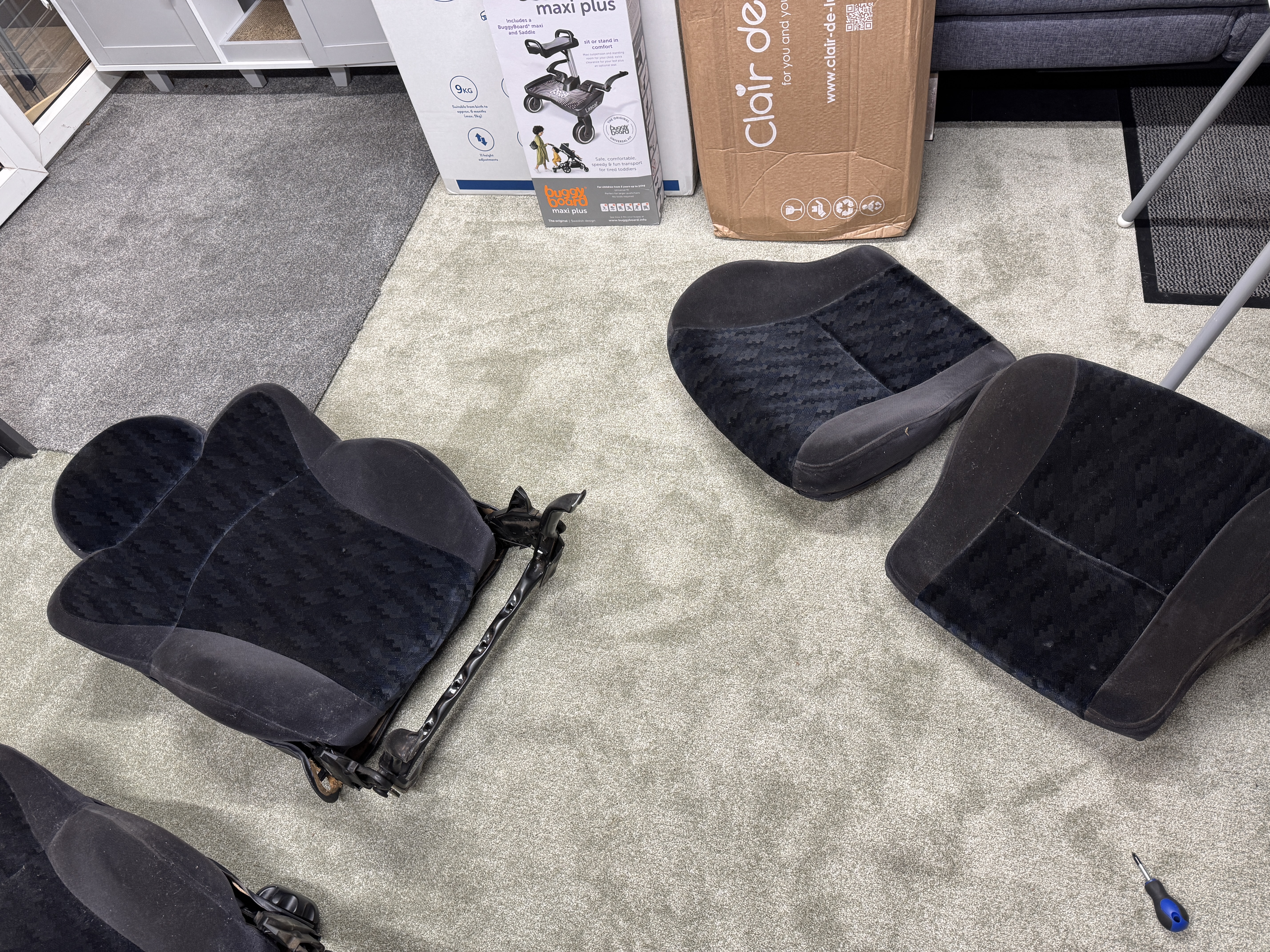

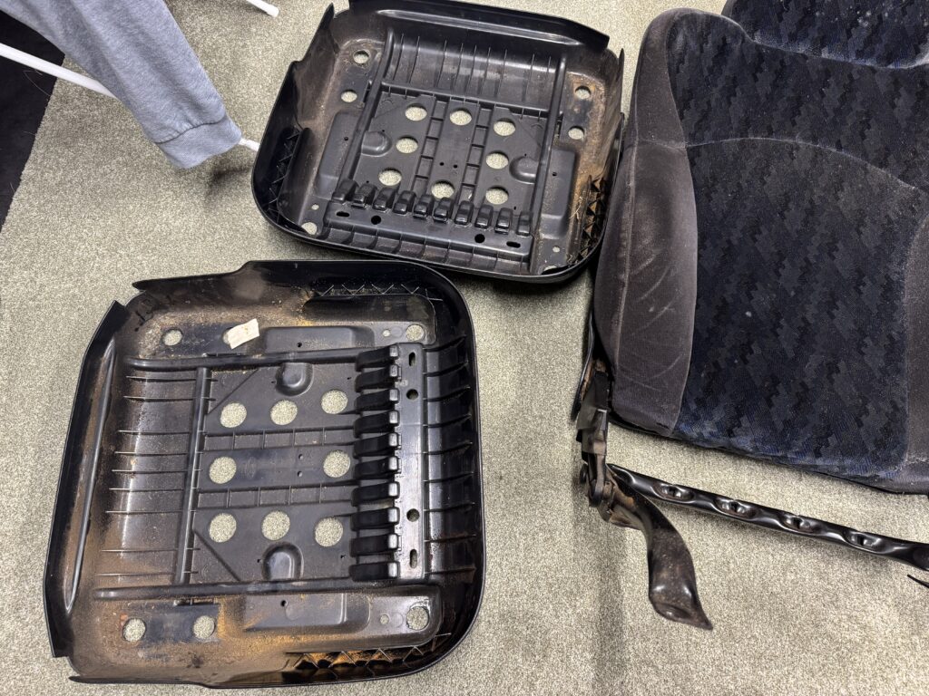

Gave the seats a quick wet vac, being reasonably carful as the fabric is essentially only glued to the foam and stripped the subframes from the seats.

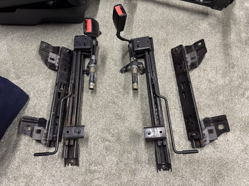

With the subframes out, I will strip, clean and get them re-powder coated – along with the subframe to floor hats and belt retaining hooks. They’re that bad condition but as they are out…. seat bases need a good clean as well!
My shed doesn’t have the wiring for seat belt pre-tensioners so will swap the buckles of the old subframes. Anyway, lets be honest – can’t imagine them working after 30 years if they were triggered.
Also needs a reclining handle on one seat, I believe they fit interchangeably just slightly different styles
