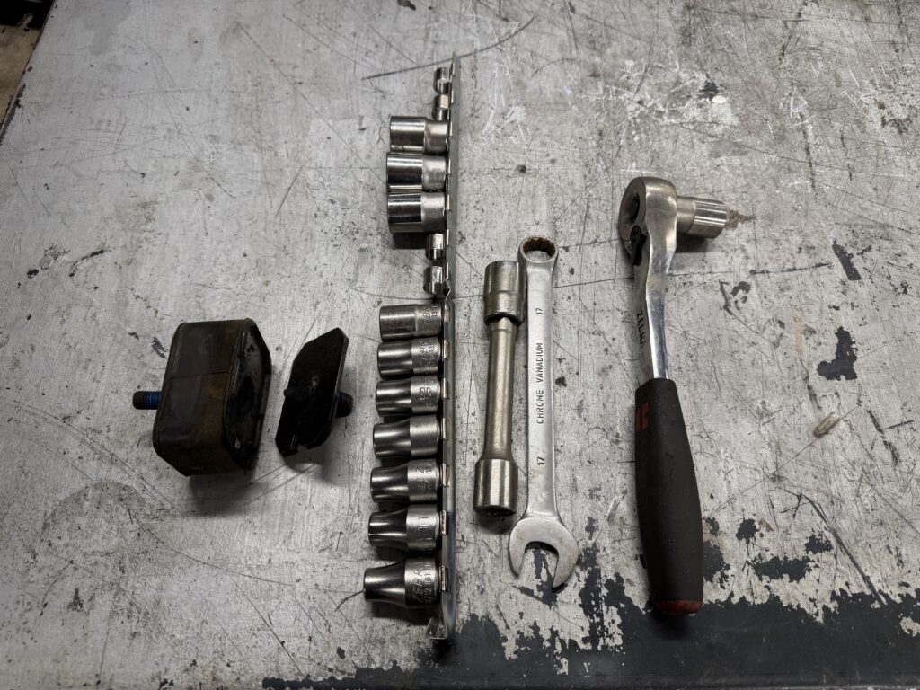

Little update on this one. It had been banging (gearbox trying to part from cradle) about every time I pulled away and it’s fair to say that the front gearbox mount was knackered.
Not opting for anything special, I went with the cheapest pair I could find on eBay. Completely unbranded. Can’t imagine the little 55 horse’ under that red bonnet are going to rip it apart to quickly!
Easy simple job – up on a pair of ramps, support the gearbox with a jack, undo the front and rear cradle bolts (18mm socket), remove the mountings (17mm socket & spanner), refit new mountings, refit cradle.
Result; can pull away again without the gearbox trying to jump off the cradle.
Only a few tools required;

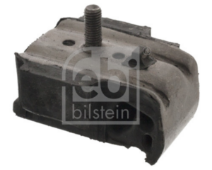

Manual Gearbox with HCS engine
Front rear listed as the same
Ford Part Number – 1030566
Febi – 05764
Borg & Beck – BEM3003
QH – EM4424 (Replaces EM1542)
VAICO – V25-0070

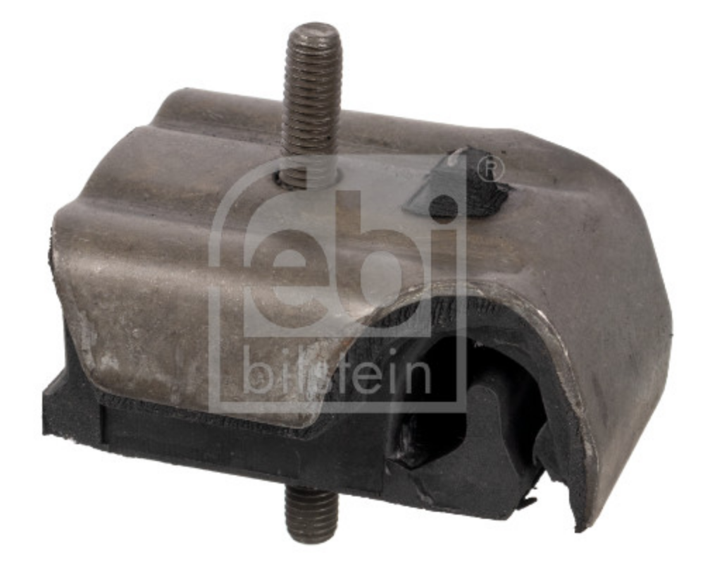

Manual Gearbox with CVH engine
Front and rear listed as the same but two types
Ford Part Number – 1030566 01.01.89-06.30.96
See above for pics (same number)
Ford Part Number – 1661786 01.01.94-08.31.96
Febi – 15691
Corteco – 216521112
Birth – 5491
Borg & Beck – BEM3264
First Line – FEM3264
QH – EM4427
Vaico – V25-0125

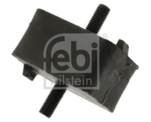

Manual Gearbox with Diesel engine or Automatic Gearbox with HCS/CVH engine
Ford Part Number – 1661786 Front
Ford Part Number – 6203710 Rear
Febi – 15692
Corteco – 216521112
Birth – 5614
Borg & Beck – BEM3268
First Line – FEM3268
QH – EM1973
Vaico – V25-0126
